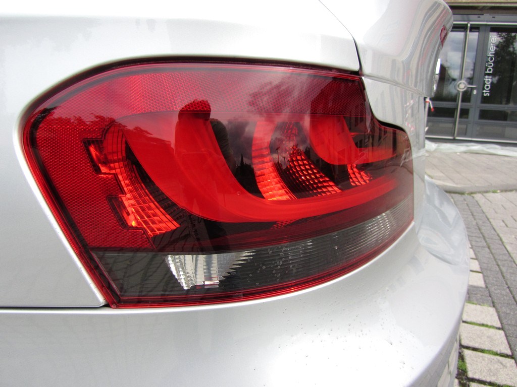

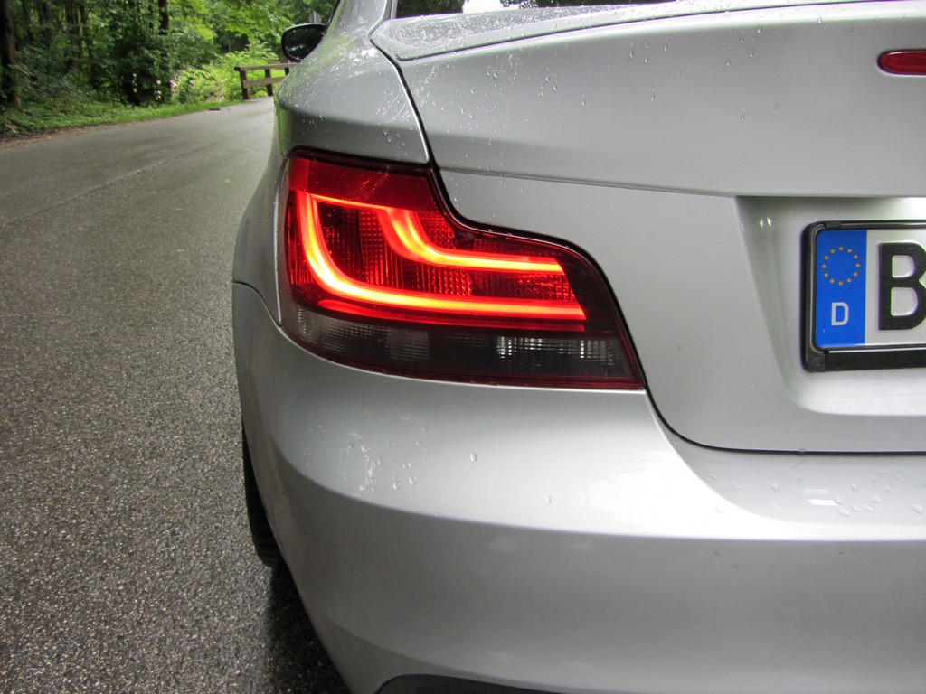

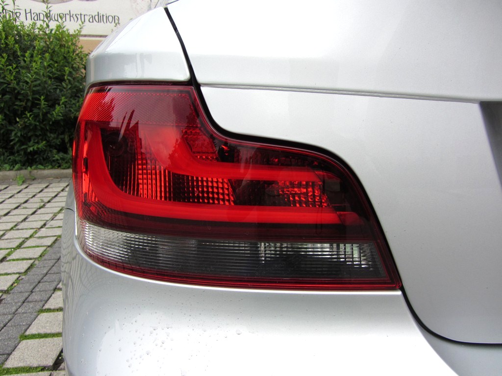

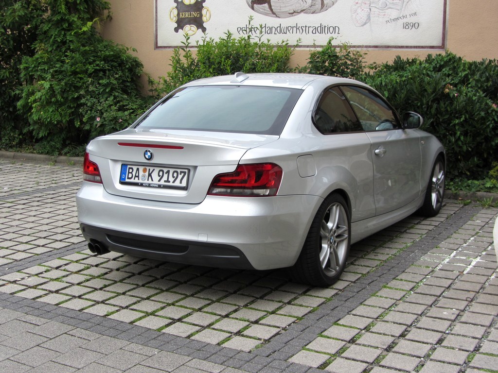

some pics of my Blacklines in daylight (it was cloudy and raining though) near Berchtesgaden...

      08-03-2012, 12:41 PM   #272
