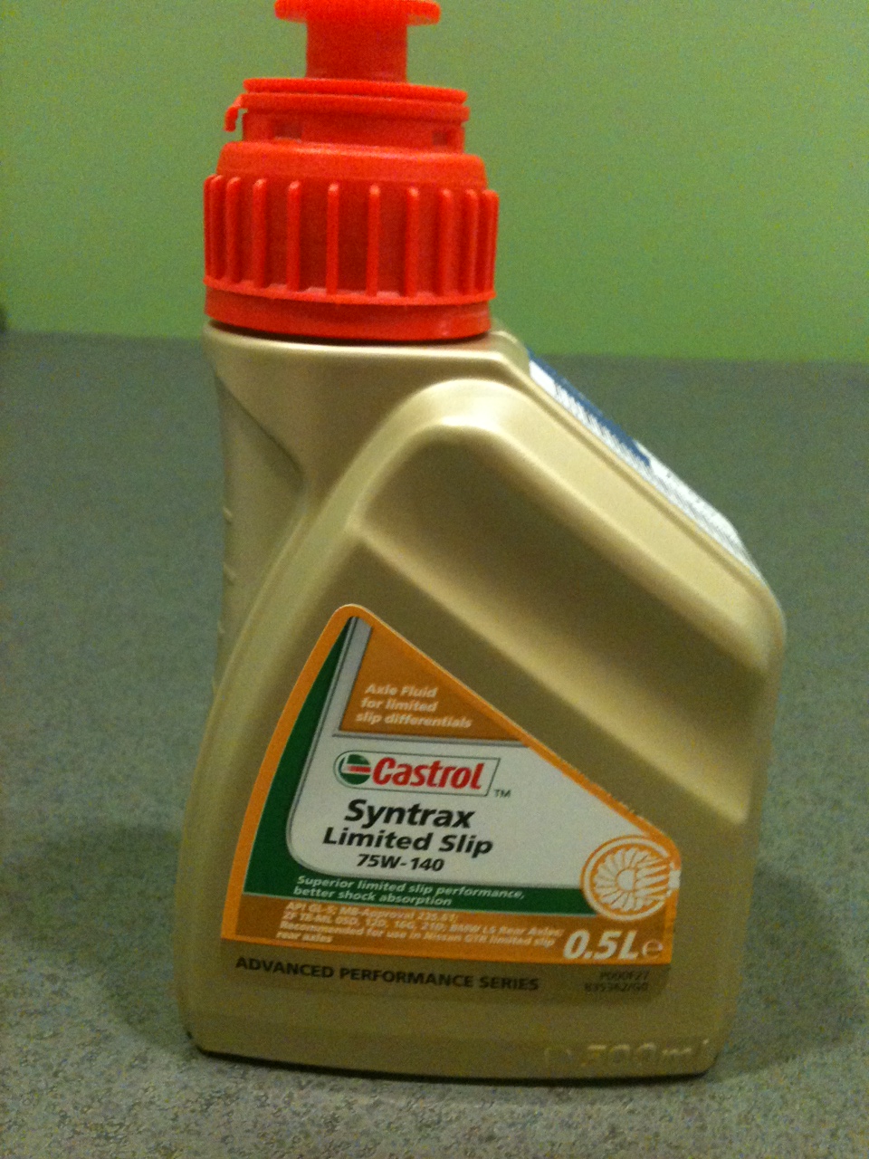

Arrow Castrol's new bottle for SAF-XJ...
Just to let you guys know... Castrol has changed the bottle of their SAF-XJ diff oil bottle. It's still in a 500ml bottle size, it just looks different now.
SAF-XJ (doesn't have the "+FM booster")... SAE GL5 full synthetic 75w140
For anyone trying to find the correct Castrol differential oil in the US at a reasonable price, it's not easy. I finally found a good "cheap" source based on another forum member's post identifying that Mercedes was utilizing same fluid for AMG cars. Part number shown in photo. Paid $13 per bottle from www.bmwmercedesparts.com but I suspect they had old pricing as I found much higher prices elsewhere. It took forever to receive as it was out of stock. Get your next order in Dack!
BMW PPK V2, M3 26mm sway bar, M3 front control arm kit, M3 steering wheel, BMW 313 wheels w Michelin PSS
      02-13-2013, 04:11 PM   #118
11331
That is a very good price! I paid 12 euros per (500ml) bottle. You paid less than I did! lol Thanks for posting this info about MB selling the oil.
Thanks for this info, but when I tried searching for the part number, nothing came up. Im usually pretty good at searching... Any hints?
What abotu MTF? Can they provide?
Part# 001989520310, just checked and now $14.63 a bottle. Remember you are searching MBZ part NOT BMW

Originally Posted by flzrider View Post
Mercedes uses the fluid for the C63 and can be bought from a MB dealership for pretty cheap: http://www.m3post.com/forums/showthread.php?t=475708
OK, so HOW do you guys know that this MB fluid is the same as the Castrol Syntrax 75w140 (SAF-XJ) ?
Most of the websites I find it on don't even have the pic Pablito has posted, which has no reference to even grade let alone manufacturer. I guess I want to make sure this is not just another "equivalent" like RedLine, Motul, Mobil1, etc...
Valid question, and the best bet is to search by Castrol part number. Honestly though since 1 series do not have a mechanical LSD, I'm not sure how much it matters.
      02-20-2013, 02:31 AM   #124
11331
It says right on the bottle... "BMW LS(limited slip) rear axle"... to the left of the 0.5L writing.
True, but the reason I need it is because I want to put an LSD in, not for the stock open diff.
Yes, on the Castrol sticker - but once I get the Castrol bottle I'm all set. The point is how do I know what I'm getting from all these online MB part stores ? Most of the online sources that I found reporting this part# have no picture. For ex: run this part# on www.rmeuropean.com, you get a Fuchs; and that is the only one I found that shows you what you are getting, and it's not the MB OEM oil, i.e. the Castrol.
      02-20-2013, 11:32 AM   #126
11331
Well... then just buy the Castrol SAF-XJ from BMW or an indi euro parts store. Be sure to read the label and make sure it says its for BMW LSD's. As long as the bottle says that you are good to go.
