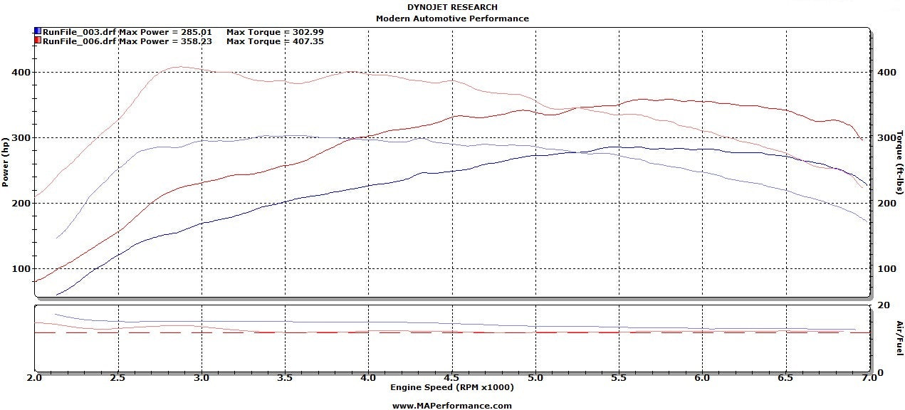

I recently picked up an E92 335i that will be used primarily as my daily driver but will see some weekend road course action. I've got access to a dyno so I figured I would do my best to document the performance gains realized with each individual modification. The data below represents the first three steps in my journey, enjoy!
Before and After Walnut Blasting: +17whp and +13wtq from a $399 maintenance service, yes please!
Post Walnut Blasting (Baseline) vs Cobb Stage 1 Sport: I was pretty impressed with the Stage 1 Sport, but who can argue with +65whp and +82wtq from just a flash?
Baseline vs Cobb Stage 1 Aggressive: Due to some knock the Stage 1 Aggressive map actually performed worse than the Stage 1 Sport. Given the fact that I was running 93 octane throughout this testing I can only assume this disparity is due to differences in either fuel or altitude in comparison to their test vehicle.
Baseline vs Custom Pro Tune: Apparently there was some power left on the table from the Stage 1 Sport OTS map which only makes sense in that every vehicle's "situation" (fuel, altitude, etc.) is different. I couldn't be happier given that we realized +73whp and +104wtq from tuning alone!
Cobb Stage 1 Sport vs Custom Pro Tune

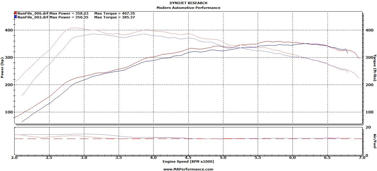

Cobb Panel Filter vs BMS Dual Cone Intake: I had seen the BMS DCI recommended quite frequently as the intake solution of choice, so I had to try it out for myself. As you can see the vast majority of the power band is within what I would consider margin of error from run to run, thus BMW did a pretty good job with the intake from the factory! However, above ~6300rpm the BMS DCI does start to show some gains with a maximum of +11whp and +8wtq. Are these gains worth the $95, only you can make that decision!

Not too surprised on the intake test. I'd call that moot.

I'm a little shocked that the bms intake pretty much did nothing below 6300 rpm. Kinda thinking a drop in filter would be good enough if I only do the sport map and intercooler

Question....why does the ' walnut dyno' lol...show you are hitting 13 psi in the lower left hand corner ?
      05-27-2014, 06:06 PM   #7
maperformance
14
229
Drives: 2007 335i Coupe
Join Date: Mar 2014
Location: Cottage Grove, MN
Good question I wish there was some more resolution there lol, what is stock boost pressure?
I thought it was around 6-7 psi

That would be odd indeed as the car was bone stock to the best of my knowledge, the power numbers aren't that far off for a stock car are they?

Yeah, those numbers are pretty much in line with a stock car.

Unless you're pushing a good deal of boost the intake is just not particularly relevant. People spend far too much time worrying about it.

8PSI. There is a 13psi map on the JB4....
So maybe the walnut blasting DOESN'T gain much power (as it really shouldn't). A couple HP sure but I'd imagine its less than the open filter.

Wanted to clarify on this as well, the graph shows -13psi as the sensor was left unhooked
