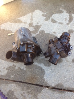

At approximately 88,xxx miles my water pump stopped working. I got a replacement pump and thermostat w/housing.
Pump came with new Al bolts and went in fine. Thermostat however would not fit properly. The smaller diameter fitting did not simply "snap" in and required a lot of force. The larger diameter clamp fitting would not go in completely. I felt if I continued to apply more force that it may crack the female fitting and/or elbow.
I ended up replacing only the water pump.

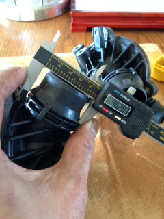

I took some T-Stat measurements out of curiosity.

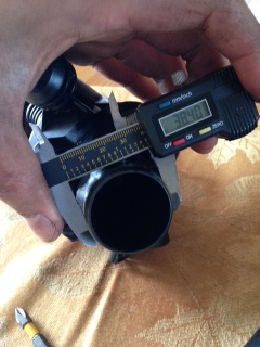

Oem Inlet OD - 38.40 mm

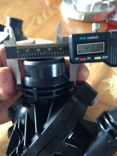

Oem Fitting - 45.68 mm

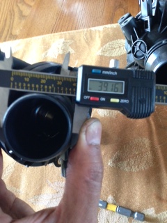

Koolman Inlet OD - 39.16 mm
Koolman Fitting - 46.20 mm
OEM inlet OD
Koolman inlet OD
OEM Taper/Fitting
Koolman Taper/Fitting

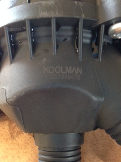

Koolman T-Stat
Just wanted to share, maybe save you the trouble. Also wanted to see if anyone else has experienced this. Were you able to get the T-Stat fittings connected?
