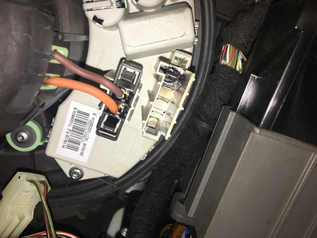

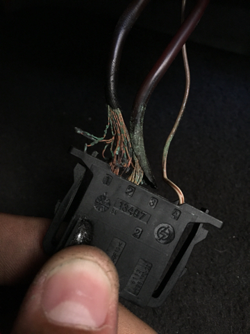

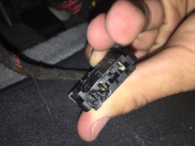

So after my AC stopped working, I decided to jump into fixing it. I could hear that the compressor was turning on when the car idled, so I ruled that out. The car had enough freon because I could feel the vents getting cold but there was no air being pushed out. I then figured my Blower motor was bad. I went in the passenger footwell, took off the bottom cover and found my issue. The connector going to the Blower motor resistor was all corroded and was making contact with every wire that was exposed. Went to the dealer and bought the connector and the crimping pins (was $36 :/). When I got home, I crimped the pins to the wire, added heat shrink and tada, everything worked. Since my resistor looked all chewed up, I might end up buying a new one if the problem happens again. I've seen this problem going around the e90 forums so I decided to post it here.

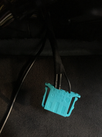

Here are some pictures of the connection points.
