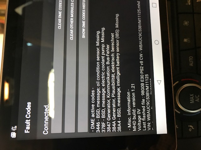

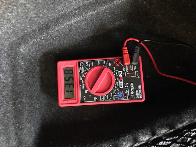

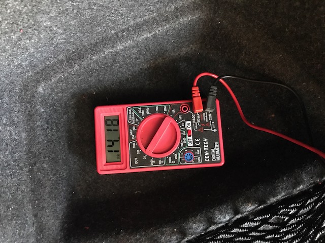

Ok, so the code popped up again. This time i had MHD connected. 35 min drive home, volts via MHD were around 13.8ish. Then as I am getting close to my house cruising at 25mph, the red battery light comes on, i look at my tablet, and the battery volts is at 11.4!! Uhh, what the..
So i pull into the garage, leave the car running, set the voltmeter to DCV, and the volts at the battery is 13.8. I am not exactly sure what you meant by testing voltage across the battery, but i set the voltmeter to acv 750 and it read 28 with the car running.
Shut the car off, was about to go inside and i decided to check one more time. Battery read 13.58 with the car off, start the car and battery reads 15.35 at idle, looking at the app it is reading 13.8 again! Shut the car off, and the battery is at 14.2x and was dropping down real slow to when i took the picture at 14.18 (30 seconds after shut off) and MHD read the volts as 12.62.
Also got 384A - generator and 38A4 IBS missing, as well as a couple other codes but i think that is related to the battery faults.
Please let me know if i did the alternator check wrong. Doesn't it seem weird that the battery is charging the entire drive then all of the sudden 35 minutes into a drive the charging just stops? Stop and restart car and it is charging again?

So thinking about what happened earlier today, the mhd app said battery volts was at 11.4v when the red battery symbol showed up, but with the car still running, the voltmeter said volts at the battery was 13.8. So that would mean the alternator was charging the battery, right?
So I wonder where mhd is getting its battery volt reading from. Because the app said 11.2 and the battery said 13.8. Does that point to bad battery?
I just checked the volts on the battery. When I shut the car off at 4pm today, the battery was at 14.2ish. 7 hrs later it's at 13.37. So almost 1 volt lower than when is that normal?

You said you have 28 ACvolts across the battery with the engine running? IF you have more than ONE ACvolt your alternator is bad.

Thanks for the reply.
So the multiple faults happened he second time around. The first time the generator code popped up and the only other code was oil level sensor missing. The codes pictured above appeared about a day and half after I disconnected the battery.
The n20 tmap is connected via an adapter that goes from harness b to a. I sprayed everything with maf cleaner and the pins looked good. But I will recheck the wiring, and in the meantime reinstall my stock tmap and map 0 Mhd flash to see if that makes the issue go away. The one thing I did not do when installing the tmap is disconnect the negative terminal on the battery. Other things disconnected and reconnected during that time were the maf, and all six coilpacks.
I will get to look at my car tonight. Haven't driven it in four or five days, so I will check the battery voltage and also take it out to get tested. I hope this is all due to a bad battery!
