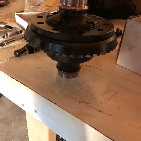

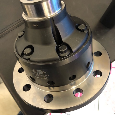

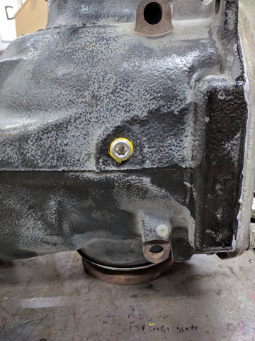

      12-09-2017, 03:57 PM   #14
Thewind727
83
122
Drives: 08 135i AT
Join Date: Sep 2016
Location: Austin, Texas
2008 BMW 135i  [10.00]
some quick pics i took along the way
i was able to tap the bearing races back on the new diff using a 3 inch washer and a 2lb sledge they fit tight but just a light tapping around the washer and they slid right down with little effort.
I think the toughest part of the diff install was getting it clamped down tight enough to retorque the ring gear bolts
