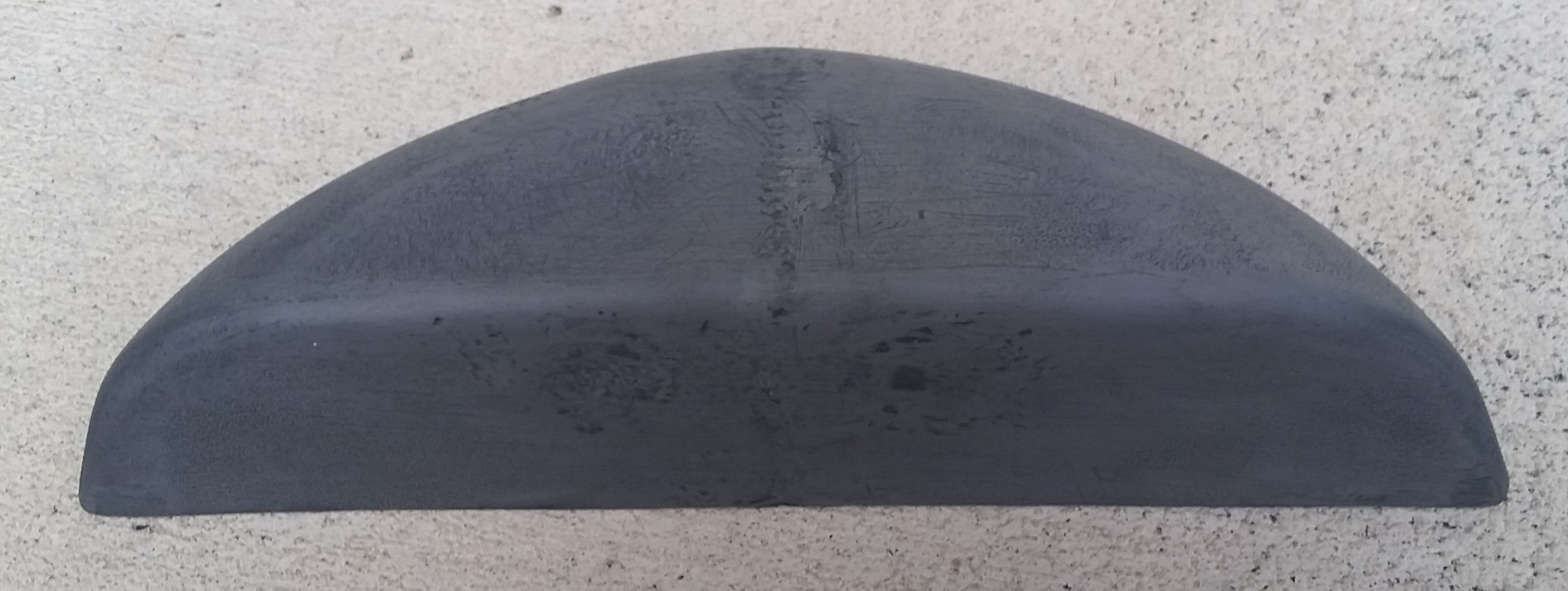

Back final shape. On the right there is a little booger where I held the propane torch for too long in one spot.

Front final shape. On either side of the middle you can make out where I filled two holes.
