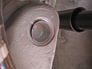

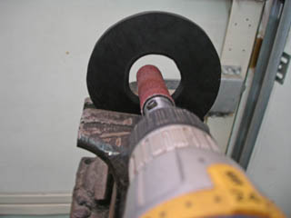

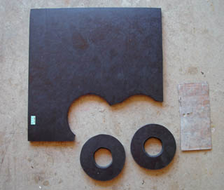

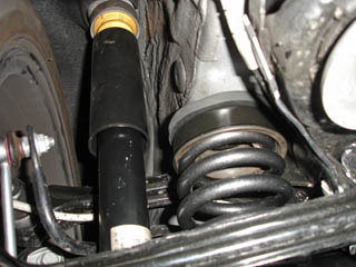

I searched for replacement rear spring pads for the 1er and found none. There are pads available for older models in 5mm, 7mm, and 10mm from BMW and 15mm aftermarket. How can you raise the rear if your 1? After having a look at the spring cup when changing springs, I saw that there might be a way to do it without screwing things up. Why not add a rubber spacer to sit on top of upper spring cup? There is a tapered part that fits into a socket in the body, so this should keep it centered. I picked up 3/8" rubber from the local Ace Hdw. and cut to fit. The material cuts fairly easily with a sharp utility knife. A pass on a grinder on the outside will clean it up. I started the inner hole undersized and used a sanding drum to bring the size out to a snug fit. The right side of my car sits 1/4" lower, so laminating a 1/8" piece to that one (1/2" thick) gave a ride height only 1/8" lower than the left. I figure that may help to compensate for the weight of the driver anyway. I don't feel comfortable with more than 1/2" total pad height, but you do as you see fit. The center post is tapered, so it gets sloppy when you space it out. Shim stock made for a nice tight fit. I used a thicker shim on the 1/2" side since it sits further out of the socket. I drove around yesterday and today and everything seems fine.
