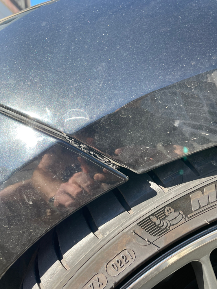

Anyone else suffer from the horrible design on the front bumper tabs between the fenders and bumper? Mine have gone to shit 2-3 times and I've resorted to plastic welding…anyone find a solution?

So I've plastic welded myself maybe 6 times, had a body shop take them off of another bumper and graft/retrofit onto my bumper, and have had maybe 2(?) new bumpers in total aside from the OEM one…ALL have failed lol.
I wanna have a shop fabricate custom metal/something more durable, to attach Bc I'm sick of them breaking and then continuing to break and rip more and more once it gets going.
Unless someone has a better idea/diy idea for me, I'll report back lol

I've gotten pretty good at plastic welding it just really doesn't hold up
I've done HDPE plastic welds and Screen/metal mesh reinforced Plastic welds, Nothing last more than a month or two
I realize it's just a horrible design flaw and the roads in Boston are fucking brutal But there has to be some sort of solution for this

This is the worse of the 2 at the moment

What do you think is causing the problem? Is it just intense vibration/impact from suspension driving around, or is your tire rubbing hard on that area? Hard to tell from your picture.
I had trimmed my bumper tabs for extra clearance and had it that way for years (3-4-ish), and even with some rubbing once in a while, didn't have too much of an issue.
Although, last year, I did finally have the bumper break apart near there, although mine was more on the actual face of the bumper, not hidden inside. Like it cracked through the visual paint.
Well it's definitely 3 things but if it was reinforced with something more durable (metal/fiberglass/even carbon fiber strip maybe) it wouldn't happen.
1. My setup - 19" BBS CH-R
2. Lowered 1/2"
3. The ATROCIOUS roads in boston
I've had multiple things break or rip…the fender metal panel, the actual bumper and/or both at the same time.
Ultimately I'm looking for someone who can literally fabricate a new bumper tab out of something durable to replace the existing ones. Need to see if anyone can actually do something like that

Why not just buy new headlight brackets? They’re not expensive and will completely fix this back to stock…
