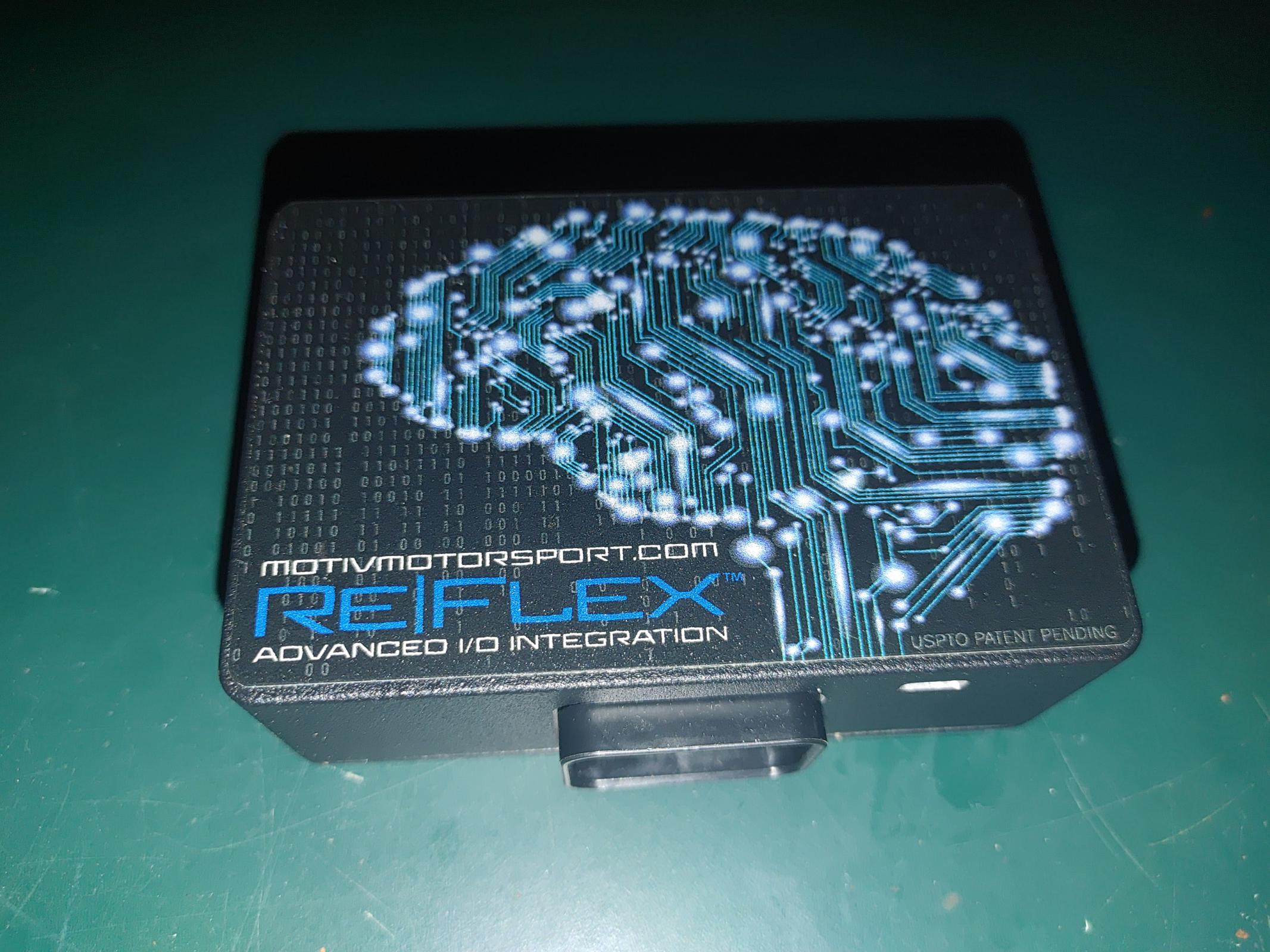

Im posting this because im about to install it. I pulled out jb4 and prometh kit. I also pulled engine trans and diff but thats another story.
Going Reflex for total control, port injection and full flex fuel.
Im going to put the info up off of Motiv's website. And then i will put the whole install here too. I cant install until i get my motor back in and the dme box back together. But i did the preliminary work already.
Info from website:
The MOTIV Re|Flex is an Advanced I/O Integration module allowing a level of precise control of auxiliary components. In addition, the Re|Flex can incorporate external data into the factory DME/ECU in parallel through optional CANbus integration. Utilizing the CANbus option, multiple digital and analog signals can be used by the DME/ECU for safety, data logging, or adaptive tuning features. It is unique in its ability to function as a separate standalone, as well as a parallel module in conjunction with the DME/ECU.
The Re|Flex provides the most accurate and precise supplementary sequential fuel injection with the ability to control other advanced features all in one place. It brings a new level of control, function, and versatility to tuning any modern day vehicle.

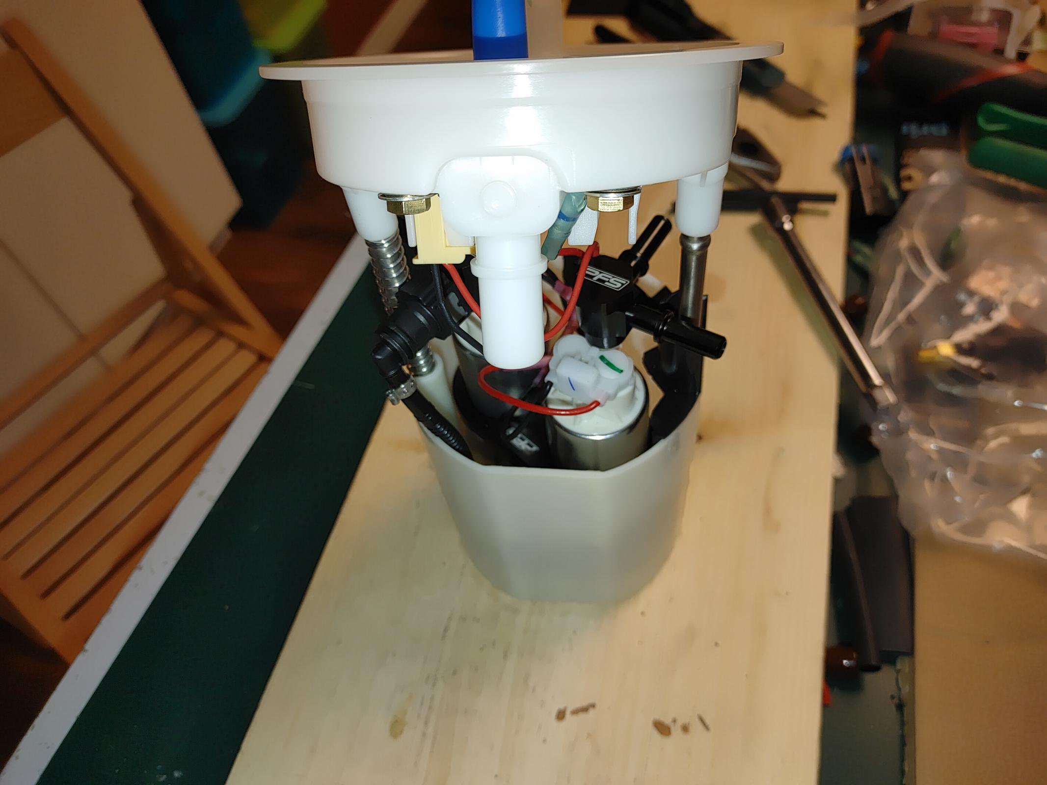

first thing i did was build a dual bucketed pump. Bought pumps separately (450/274 for primary and 525 for secondary) then got a PFS diy bucket and hobbs harness. Installed this a few weeks ago

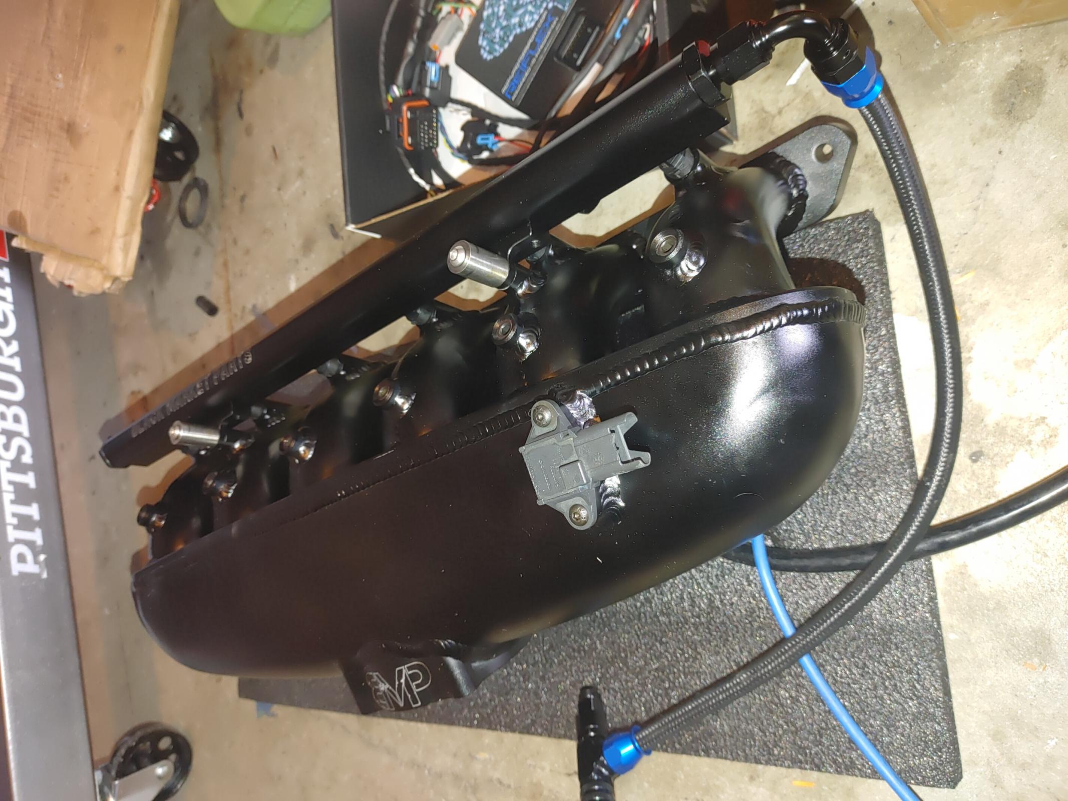

Next i got a black market parts port injection manifold w 750 injectors.

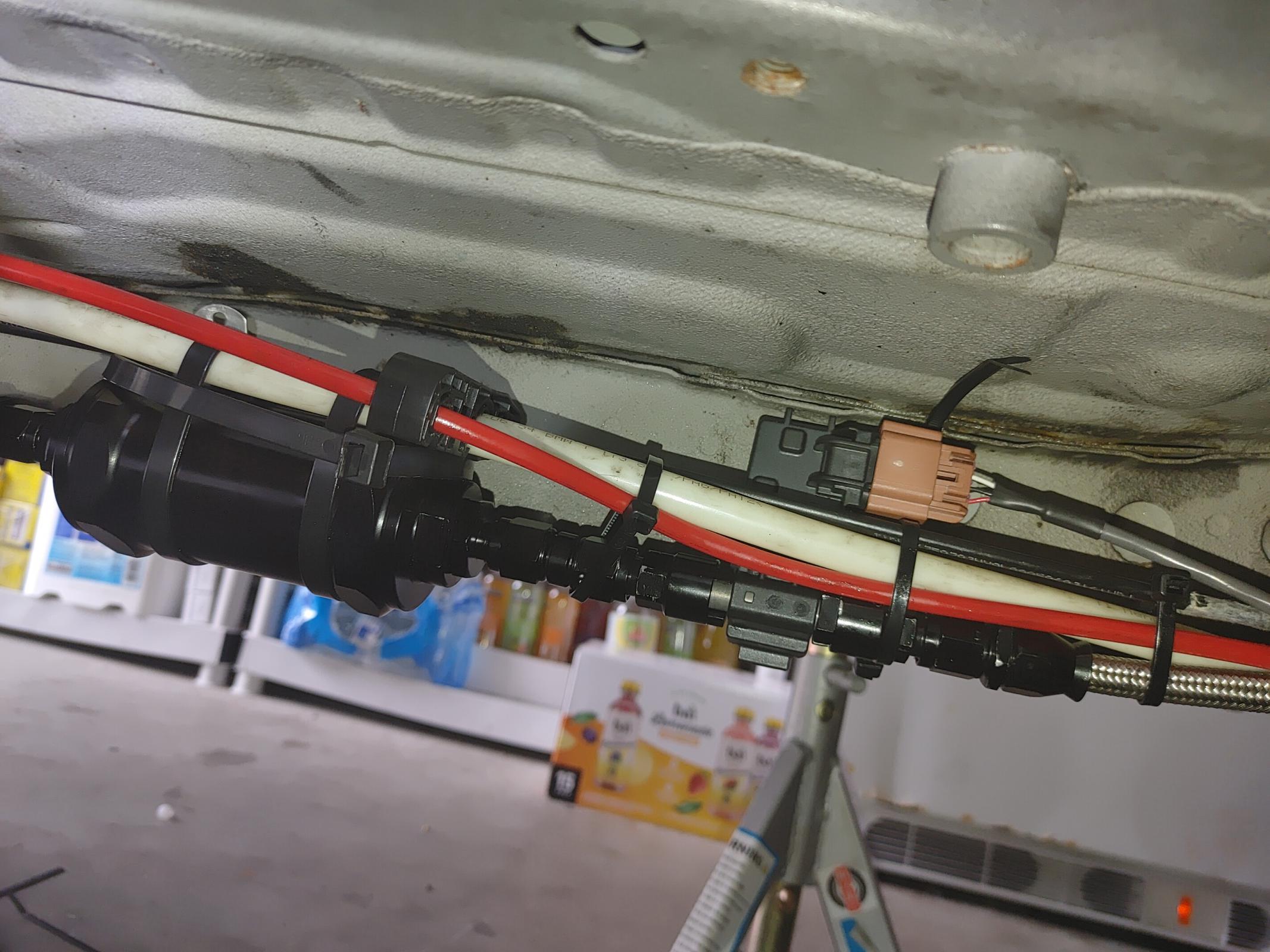

Then i got the stuff to make my own -an lines and i went 6an from tank to a 6 micron inline filter and ethanol sensor then up to the bmp port fuel line adapter which goes into the hpfp. Btw there is a little filter in the nozzle of the hpfp. I pulled it out as the inline filter takes care of that now.
I also added a breakout cable to plug in the flex fuel box . once i install everything i will add some pics. I have to tie into several wires in the dme. This is not a piggyback it becomes part of your dme. Then im also getting a full flex fuel tune through motiv as well
