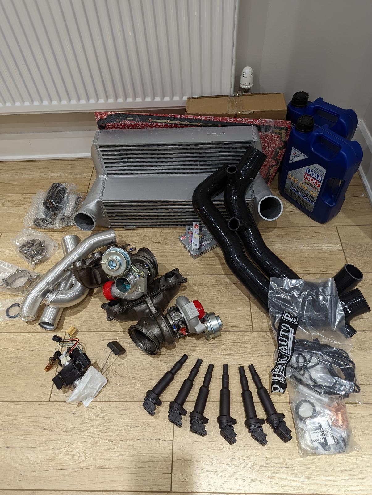

After lurking on the forum for some time learned a lot, and got a build underway at a local shop over the next few days.
Wanted to share excitement of significant build and happy to get any advice from the pros here, on current state and next steps.
What I drive:
2008 135i - N54, 6-speed, cabrio.
Currently on the car:
- Catless
- JB4
- VRSF Chargepipe + Tial BOV
- Cone intakes
- Maintenance up to date (Walnut blasting, etc..)

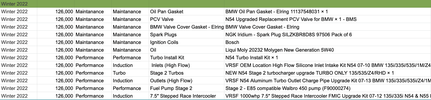

Getting installed:
- VTT Stage 2 (625hp max rating)
- VRSF High flow inlets
- VRSF 2" Outlets
- VRSF 7.5" Race intercooler
- Stage 2 Fuelit / Walbro low pressure fuel pump
- 2 -step colder 97506 plugs, Bosch coils
- Gaskets, fluids, PCV valve...
Thinking of running map 5 for a while, eventually doing a custom tune.
Cheers!

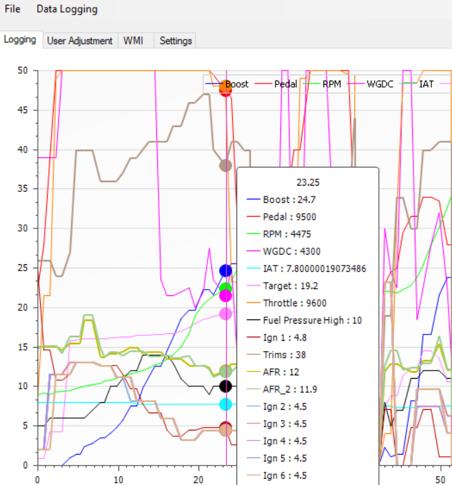

Updates from this weekend:
- TMAP sensor swap to unlock boost over 20PSI as per this video from Vehicular DIY:
. Rewired plug, for a cleaner install.
- Back-end flash
- JB4 adjustments (firmware update, custom settings)
- Logging sessions runs
Car hit 24PSI boost, and it appears to be too much power for the 255s in the back. Running Firestone Firehawk Indy 500s.
Wasn't able to do a WOT runs in 3rd gear. Kept losing traction over 4k RPMs.
Considering running a more conservative boost for now until I figure out how to proceed with Drivetrain mods in the next steps.
