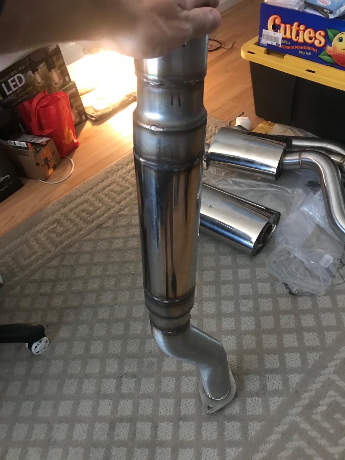

      03-11-2023, 02:50 AM   #34
SHK_e82
Drives: e82 135i n54 6speed
Join Date: Mar 2023
Location: San Francisco
I’ve been running a full vrsf exhaust on my 135i for a few months now and it sounds awesome. I decided to cut the resonator piece it comes with in the midpipe and replaced it with a 3.5 inch piece that was custom welded by a professional welder. Tone is amazing, with barely any drone and it makes the car feel lighter for sure. I’m looking to sell it since I have to go back to my oem midpipe for CA smog. If anyone in the Bay Area is interested in it for their 135i pls message me. I won’t ship it bc the piece is too big however fitment is perfect and it gives it that deep growl and gets rid of rasp.
      03-27-2023, 01:34 AM   #35
CharsadehBEAST
27
133
Drives: Minivan
Join Date: Sep 2020
Location: NorCal/East Bay
Will it not pass smog because N54's have cats in the midpipes? Berk mids on a N55 have no impact on passing smog.

      05-03-2023, 03:36 AM   #36
SHK_e82
Join Date: Mar 2023
I’m not too sure. However, I don’t think so because primary cats are what restrict emmsions gasses from being released into the atmosphere but I could be wrong. If you’re interested in the mid pipe please call to text me my number is 650-743-1531.
