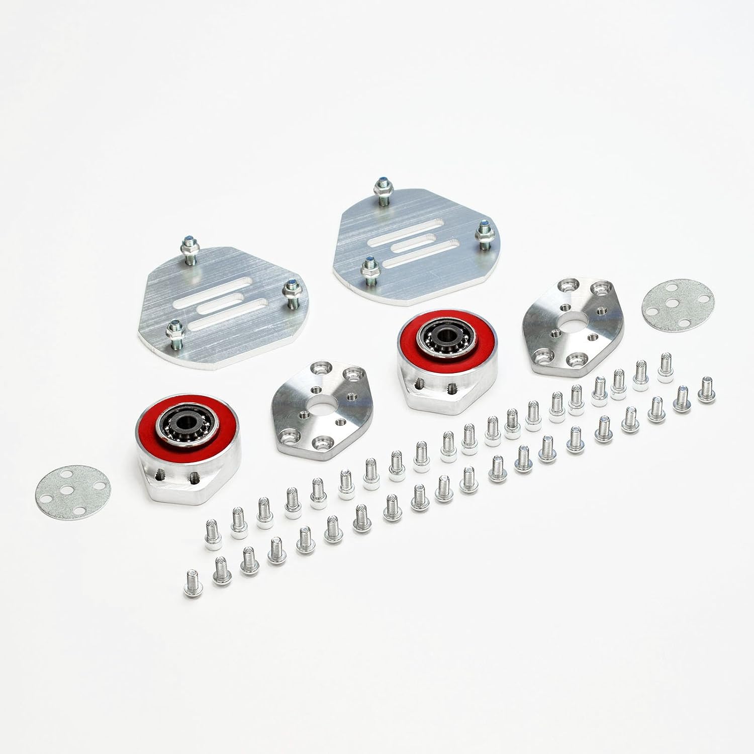

So I found some bootleg SPC camber kit that looks like it uses the same parts at the SPC kit for $150 I was going to try it but it's really overkill for me and I hear the legit Ground Control and SPC kits can be noisy. Someone with a better garage should test these out...
[IMG]http://www.**********s.com/zoom_img/_1491914711.jpg[/IMG]
