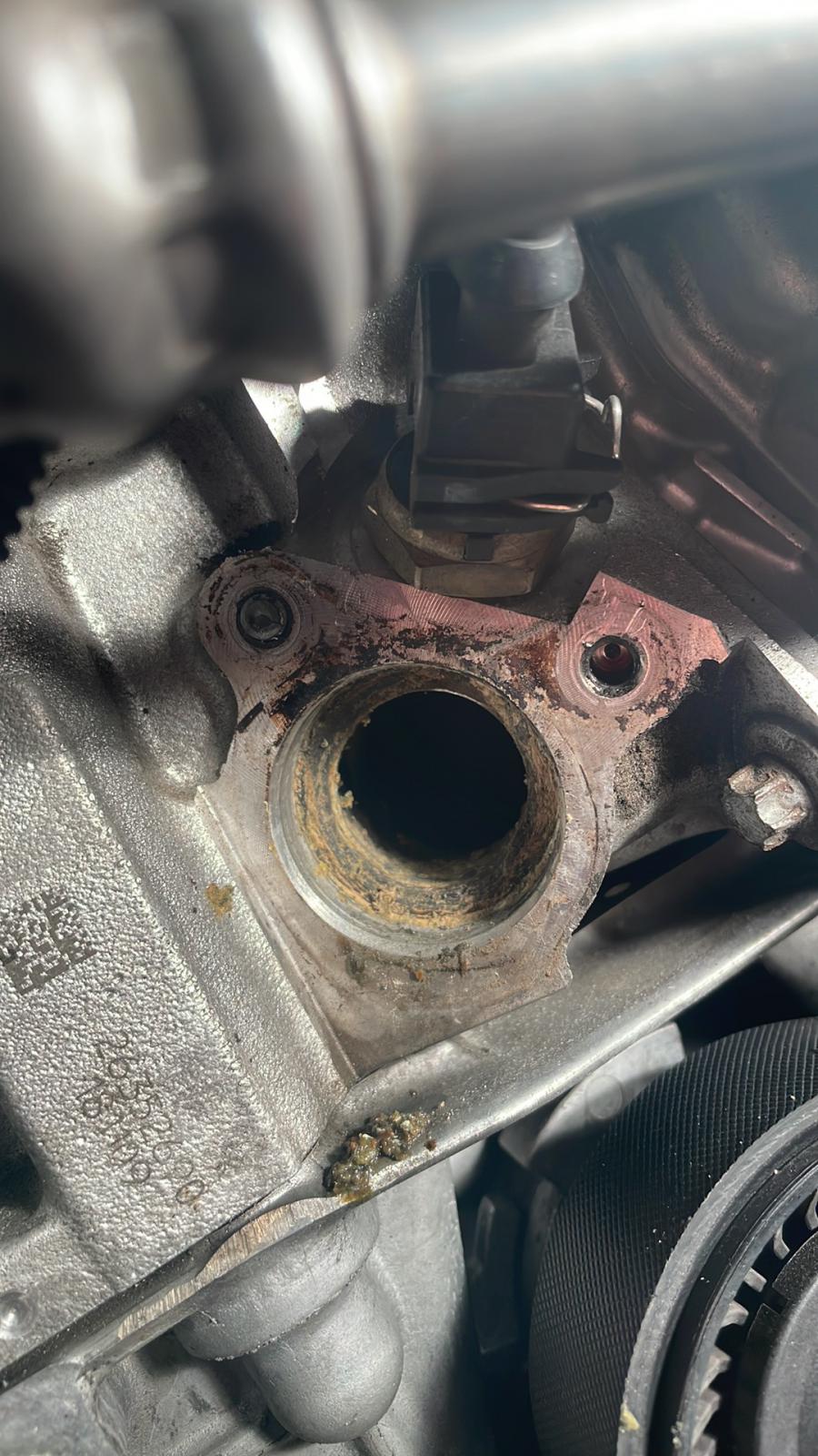

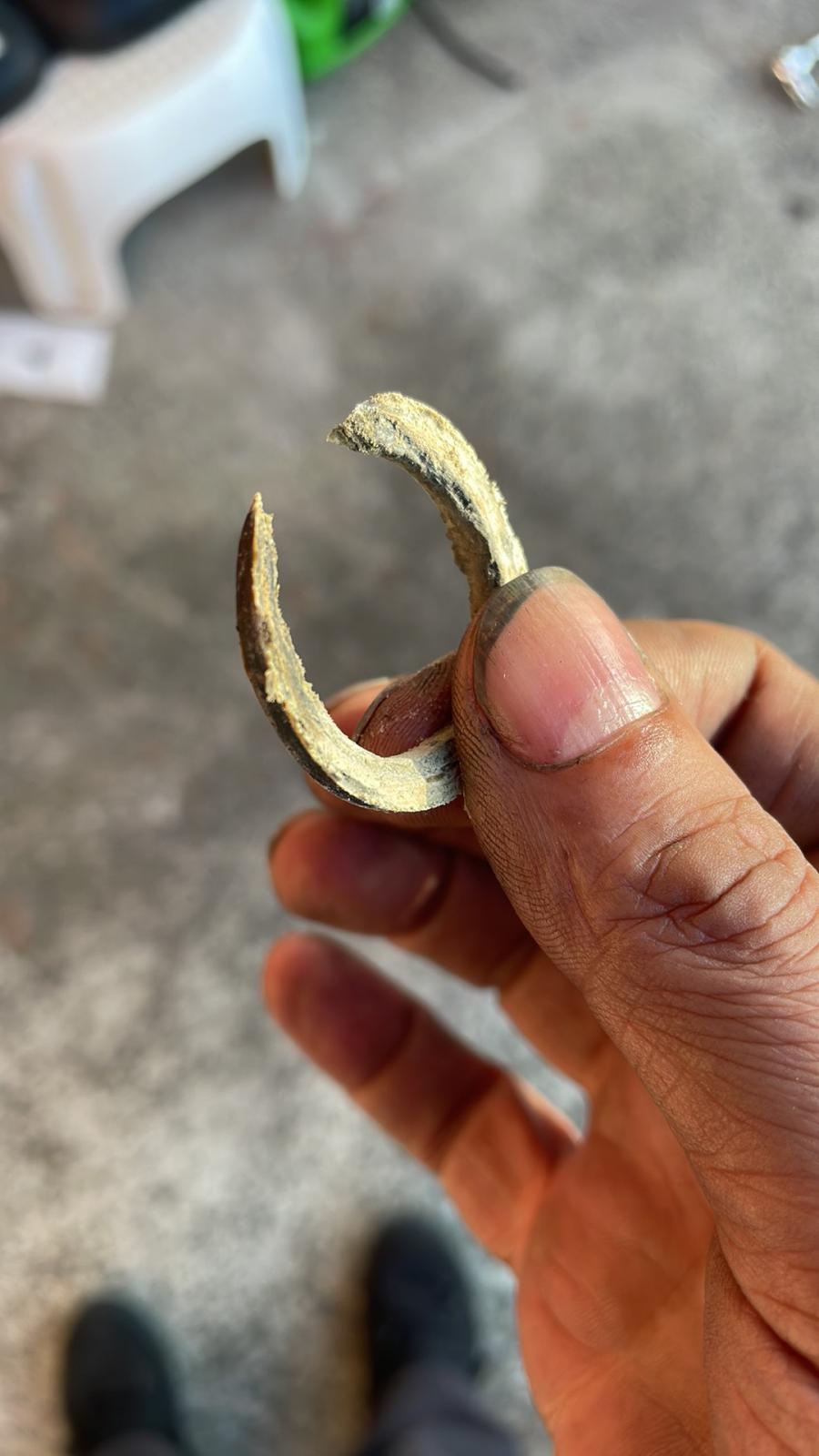

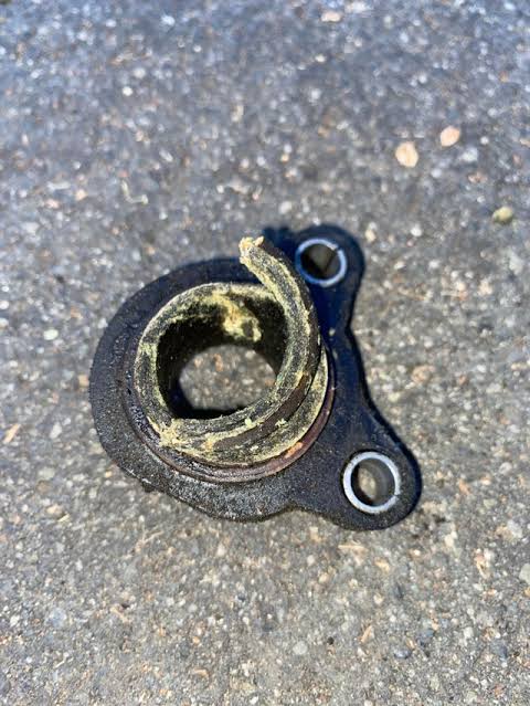

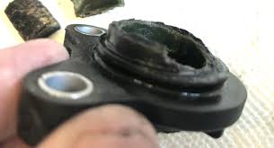

The original bmw “mickey mouse” hose flange is made of some stupid material and is prone to catastrophic failure. it goes from the cylinder head to thermostat. i bumped mine and it disintegrated. mine is n54 so not sure yours is the same but if it is, an after market aluminium flange is definitely recommended. take a look just below your oil filter housing for a hose connected by two bolts at the top (the mickey mouse ears).
here’s some pics of what mine did:
