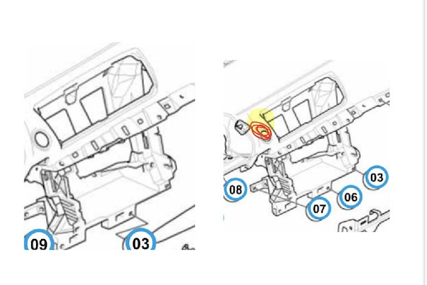

      08-25-2023, 07:26 AM   #28
ot242424
Drives: E87
Join Date: Aug 2023
Location: Germany
Need Help CIC Retrofit
Great work. I am looking forward to the same exactly thing to my E87 2006 (pre-Lci) but got one upcoming problem....
My dash is probably the older one which has not got the curved side downwards...
I am looked in the parts list and find out that the outlines are the same (right one with the red mark is the pre Lci one with the CCC)
My Dash:
The front view of the two trims:
I'm sorry if I reopen this thread for something like this, but I really need help on how to solve this if possible without replacing the entire dash.
