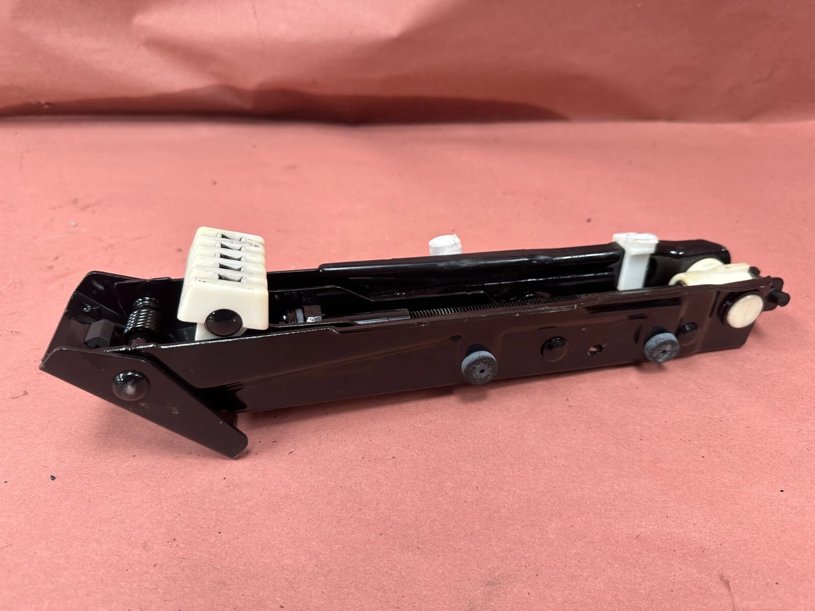

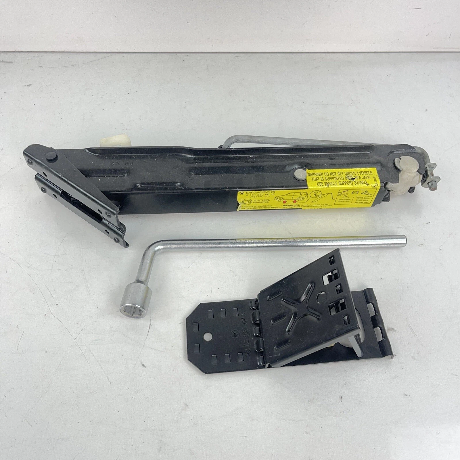

Originally Posted by cerealwars View Post
moose09876
Congrats on your car!
Any thoughts on that Mercedes emergency jack? I've been wanting to put together a good spare-swapping setup in my car since I blew out a brand new tire a few months back.
Ah, good information here, as I have been needing to find a jack to keep in Little Red, my 2010 128i. This Mercedes jack looks like it is low enough for the 128i (mine is lowered on the Bilstein B12 kit (B8s(?) and Eibach springs). For my '99 C5 Corvette I carry a scissor jack from a first-gen Mazda RX-7, and for my 2010 E91 a generic scissor jack, but now see that this Mercedes jack would be a good option for Little Red. Also looks as though they are abundantly available on Ebay. Curious how they work as it is not obvious if you've never seen/used one before, I found this video:
K9Leader
2011 128i E82 6MT - Crimson Red/Black

Originally Posted by moose09876 View Post
I got a HARD flat on the way to pick up the 791M wheels. almost 3 hrs in, 8mi from the meetup. If I hadn't had the floor jack with me already I would have been screwed. Had to figure out something, immediately added jack + patch kit to the inventory.
Jack pad fits absolutely perfect. Did a lot of trimming on the plastic spare tire insert to get it to fit right, as well as breaking off the protruding tab in the trunk space. Every single one of you on this forum need to do this.
What did you trim? What's the spare tire insert?

The BMW parts catalog list an E82/E88 jack so no need to source from another car. Well you can of course.
There is also a spare wheel kit set, but since our cars don't have a spare wheel tray and trunkspace is limited already, that's not really an option.
There is no real neat solution, but the BMW Mobility kit with foam and compressor is the least 'intrucive'.

Originally Posted by MParallel View Post
The moment I got my 135i I couldn't make any sense of that 'tray' on the left. Nothing fits nicely, no holders for anything. No spare!
I guess I want the mobility kit with a can of foam and little compressor or something. Without a spare I don't think a jack will get me very far.
I added the jack and a plug kit along with the factory compressor. Not going to save a shredded tire, but get you back going with a puncture.
P/N?

Originally Posted by k9leader View Post
p/n?
71126799169

71126799169
Thanks. Curious, though, as searches for that P/N bring up a couple on Ebay that are traditional scissor style jacks and are expensive ($142 and $200). ECS has it and, again, kind of expensive (almost $150).
But the one offered by Schmiedmann, with the same part number, appears to be the offset style jack similar to the Mercedes-Benz version.
I did find a similar offset-style jack from the E39 (and at more reasonable prices than the scissors style).
I ordered one of the MB jacks off of Ebay for a little over $50.
realoem shows it as a scissor jack.
