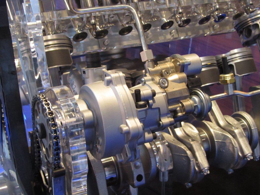

What index were your old injectors and what index was the two new plugs? I believe #12 are the latest and greatest injector version. You also must program(code) the injectors to the DME.
When you replaced your HPFP... you should have also replaced the fuel line pressure sensor just before the pump. Here are some pics. This sensor can go bad and throw HPFP codes. BMW recommends replacing it when you replace the HPFP.
Name:  HPFP low presure sensor  347gtvp.png
