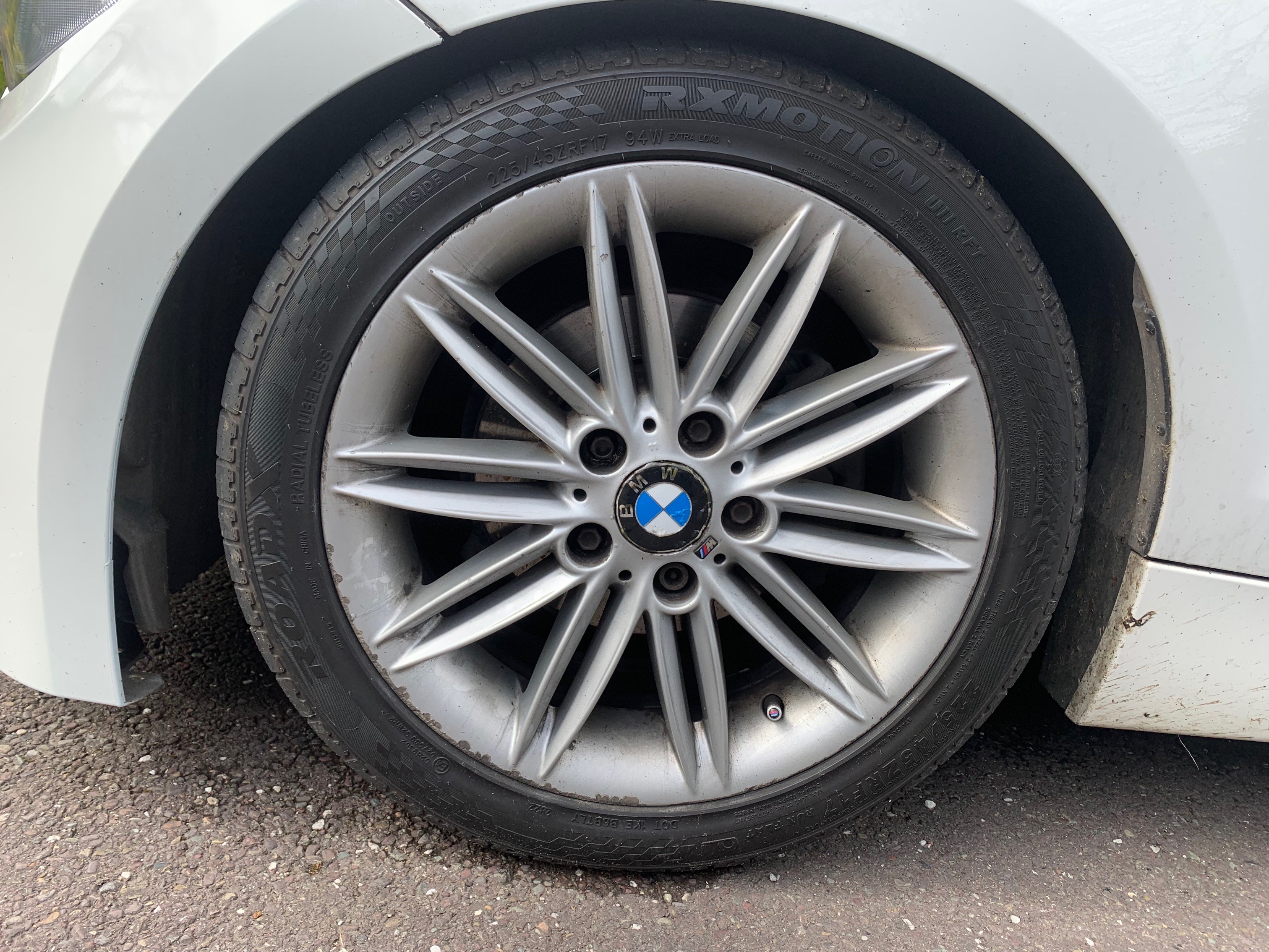

118d e82 Tyre/ Wheel sizing
Currently I have Style 207s from factory on the car but am thinking about getting OEM style wheels , I’ll be getting reps since 2k Euros + is too expensive.
1)What wheel size and tyre size combinations will work ? What will look ok and also not rub/ scrape against the car itself . The car is not lowered or anything.
2)Also My tyres are almost brand new so ideally I want to swap them ( 225/45/R17 all round ) onto the new rims. However I’ve become somewhat confused .
(Bare with me , I know it’s a mouthful )Everywhere you look online my current wheels apparently only come in 17” diameter , but when I put a tape to them they are 18,5”. The sidewall of the tyre also confuses me . The tyre with is 225mm which is pretty much 9” but the side wall itself states “7 1/2J “
Pictures of wheel attached

Well I knew how tyre sizing works maybe forget about that . I just can’t understand why the wheel measures 18.5” and when u google it there is no such thing . Just 17”
Photos below. Start of tape is broken so that’s why I started at 1ft . 6.5” past 2ft means it’s 18.5”diameter. (And I haven’t messed up that measurement , if I did it would be shorter anyway. )

Originally Posted by p4tr1ck2005 View Post
Alright thanks for the link I suppose .
ah, the functional diameter is measured inside the wheel barrel. the face of the wheel is a bit larger
your wheels are 17" and your tires confirm this since the third number is 17 as well
Oh right , so 17 inches from where the tyre actually beads in . Had crossed my mind alright but . Thanks anyway lad
