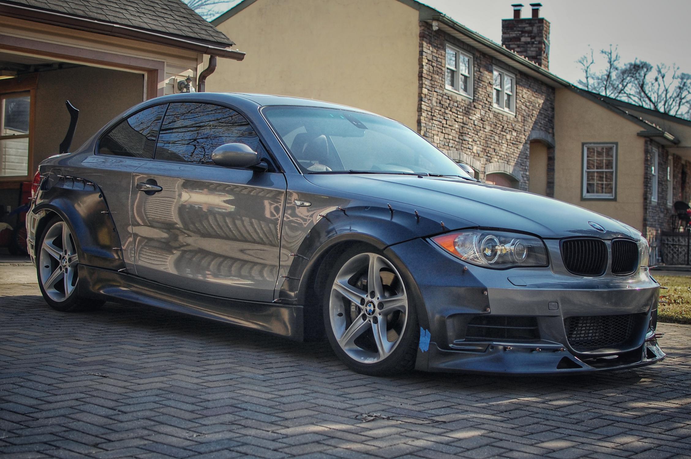

I am currently converting my 2009 135i to widebody spec. I will be using the Ohlins R&T coilovers with swift springs and Vorshlag camber plate. The rest of the suspension components are currently stock.

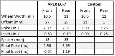

Having a difficult time finding wheels with the offsets I need for fitment without running wheel spacers. It seems most using the Clinched kit use APEX wheels, 10" et25 in the front and 11" et25 in the rear. This nets about 2.25" of increased poke front and rear, which isn't quite enough. It also increases the inset by .3" front and .2" rear. I know there are some clearance issues with the Ohlins on stock offsets, so the Apex wouldn't work without spacers.
Wondering if anyone has experience or suggestions. The car will see mostly street with some track use.
Some photos of of the body mounted with temp rivets:

Damn thats wide.
When you say those specs "aren't enough", how much more are you looking for?

Wow that is a wide body. You would think you needed a wider rear end or a crazy offset with big spacers

Originally Posted by mad_hatter View Post
Damn thats wide.
I need 3" more poke in the front and 3.75" out back over stock. Looking for 10" -12" wide x 18" diameter wheel options that fit a 5x120 and have shallow/negative offsets.

Looks like I will need to up my wheel budget and find a manufacturer that can build to spec. Ideal width and offset to run without spacers:
