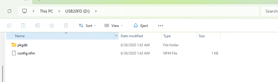

Yes started but then it stopped and have not been able to get past 79.2%
I also got these messages

The issue is your map data, nothing else. Either it was not copied to USB correctly, or is corrupt.

See attached.

Your issue is pre 03/2010 build with 09/2009 Firmware. You must update CIC firmware to update map.
