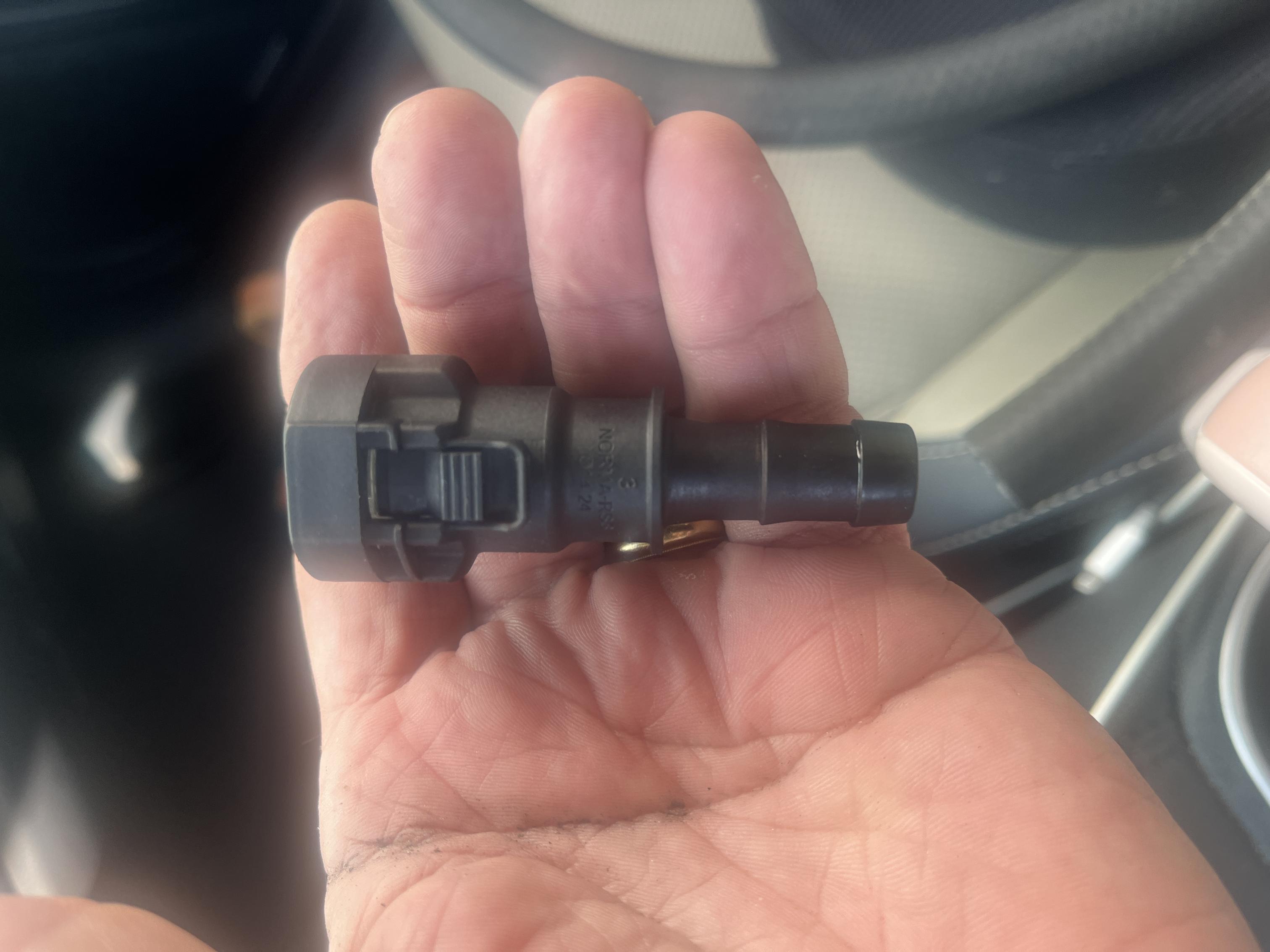

Will be back at it next week and I am going to see if I can devise a work around to the high coolant temps. Going to get the front end aligned and match the caster or at least get it closer.

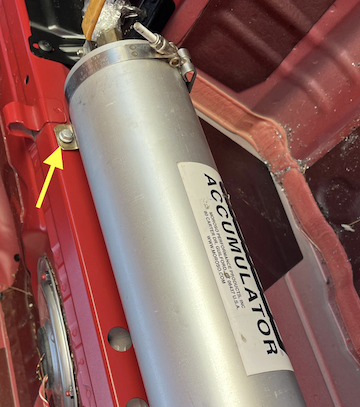

One of the things I never thought about but have stumbled upon is the orientation of the vanes in the cooler. The cooler I am using for the DCT is not only large but the fins are quite different orientation than those of the radiator. It is possible that this has created a blockage from creating blockage or high pressure due to the orientation of the vanes and the close proximity to the back of my radiator. My fab work will now need to be cut but I have plenty of hose. I should have to cut off the oem hose crimp from the heat exchanger in order to get this to work.
Nothing to worry about here as on the previous car I did this when converting to electric power steering. Carefully cutting the crimp reveals a hose barb that is easy to reuse so there should be no issue using the part and plumbing in a different style cooler. I am also going to move the different cooler off the radiator about an inch in hopes of allowing whatever airflow bending is occurring to smooth out and flow through the radiator as well as the dct cooler. Also hoping that the temps are a bit cooler but that will actually mess with trying to figure out what I have wrong here. Will update more as I get my head around what I did wrong but I think the proximity of the rear cooler is the issue.

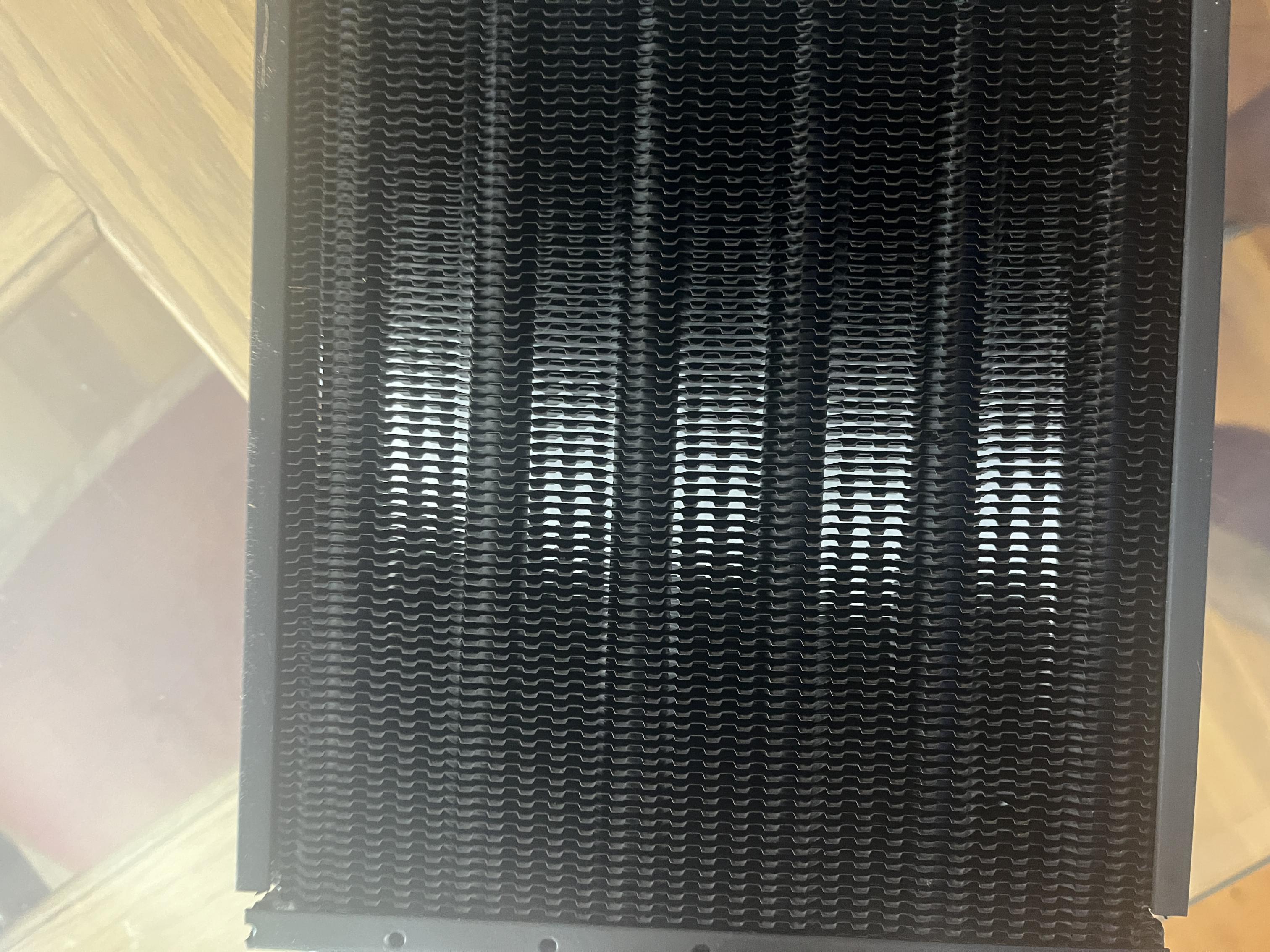

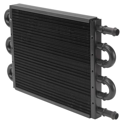

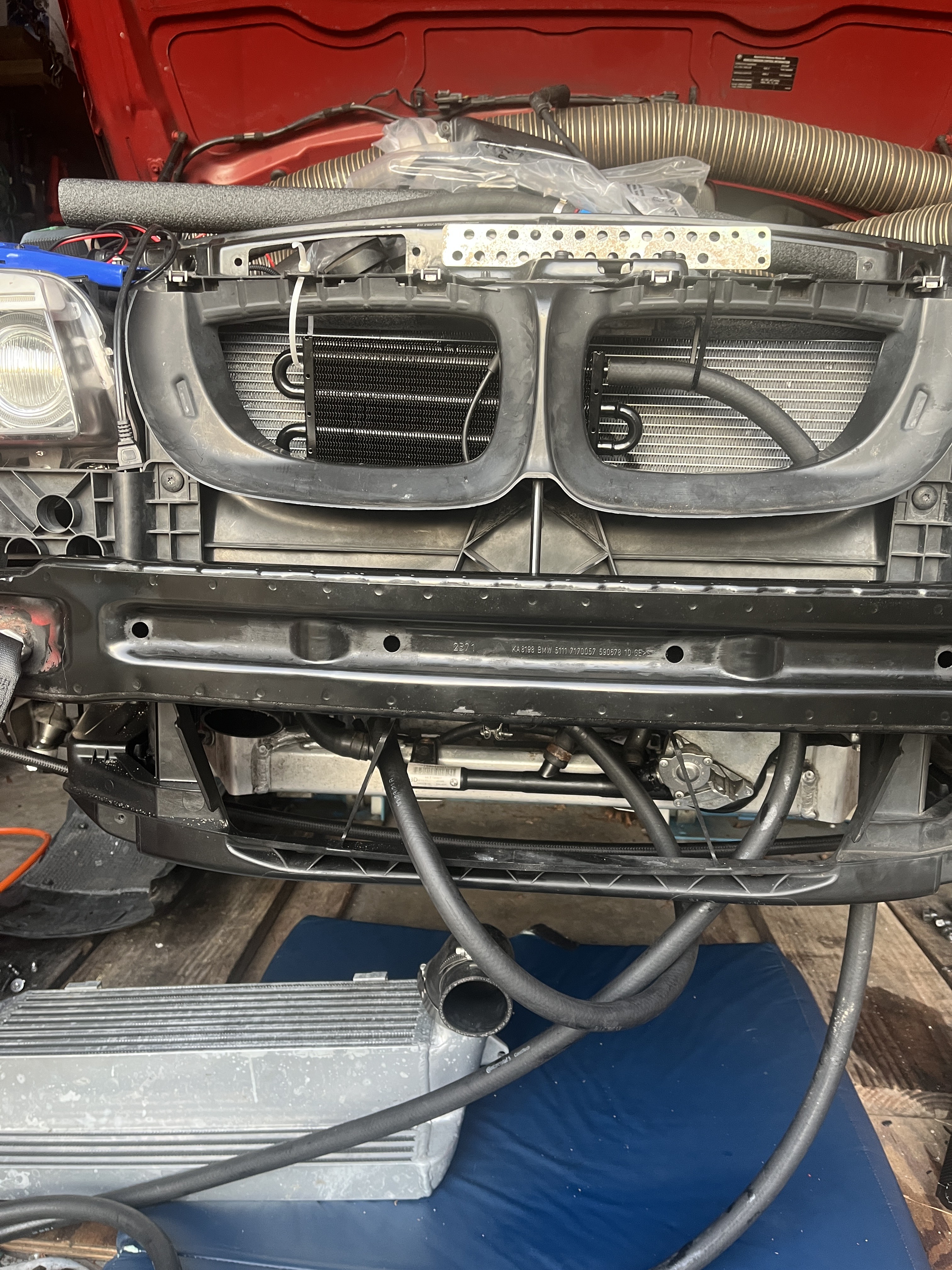

New cooler arrived today. Lots of things to factor, all of which I hope solve my cooling issues. First the cooler is smaller which should allow more airflow through the radiator. The orientation of the fins matches the radiator much better so hopefully that will reduce high pressure from behind the radiator. The fins are less dense than the other cooler so while it should be less effective cooling the DCT it might bring both temps into acceptable ranges.
Track the next two Friday's and contemplating moving the current cooler away from the radiator about an inch to see if coolant temps drop. Results might skew a bit since it might be a few degrees cooler but if my idiot brain is thinking this through correctly, the blockage is occurring on the top of the radiator and that is where you should have the largest difference in temps between ambient and hot coolant so I am really punishing the cooling system due to my ignorance. Last resort will be to invest in a bit more hose and move the new cooler around to the front similar to where the condenser sat.
Shooting through the new cooler. The white is the box it came out of so you can see it should flow air better but at a cost in efficiency.

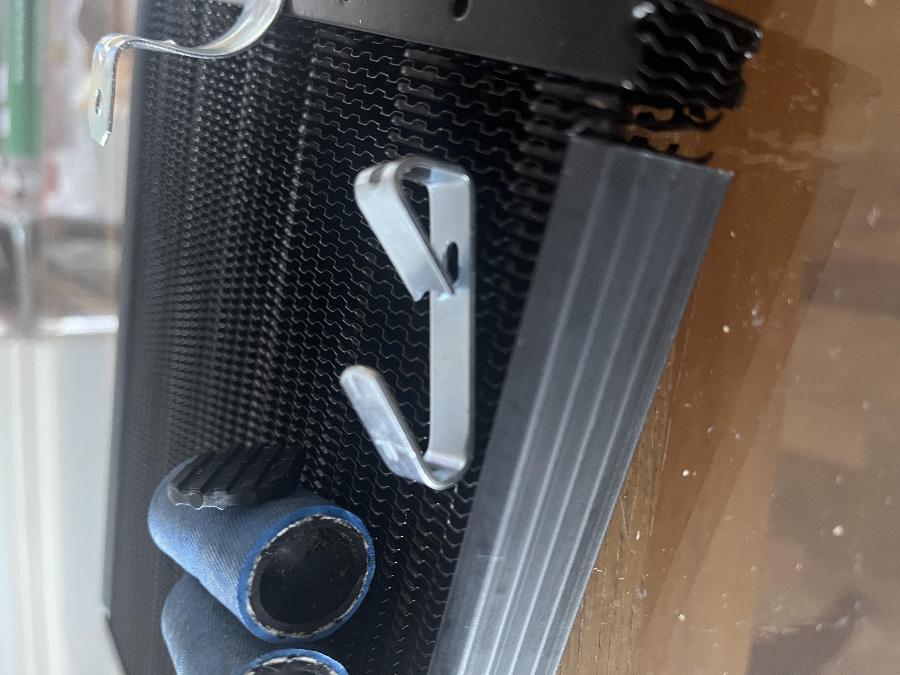

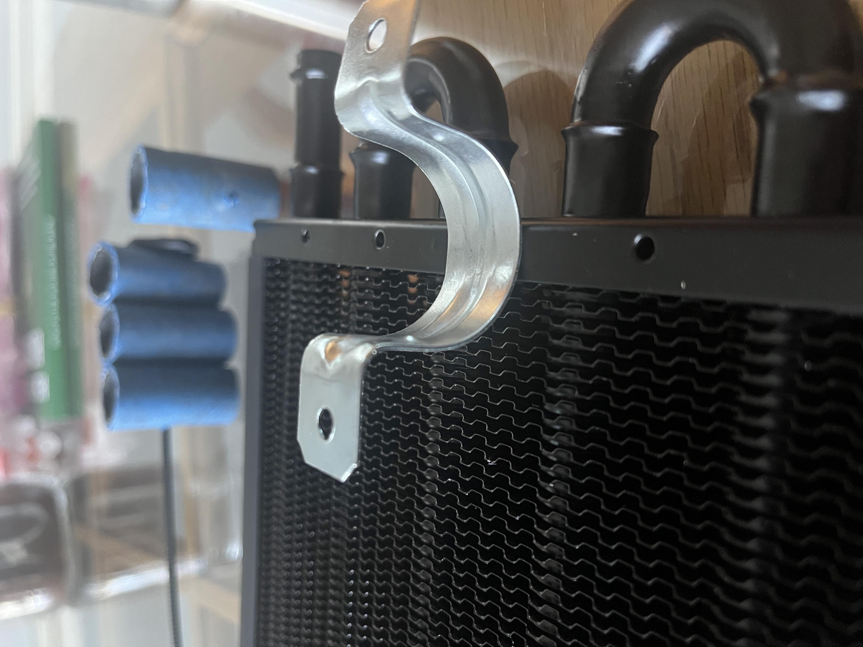

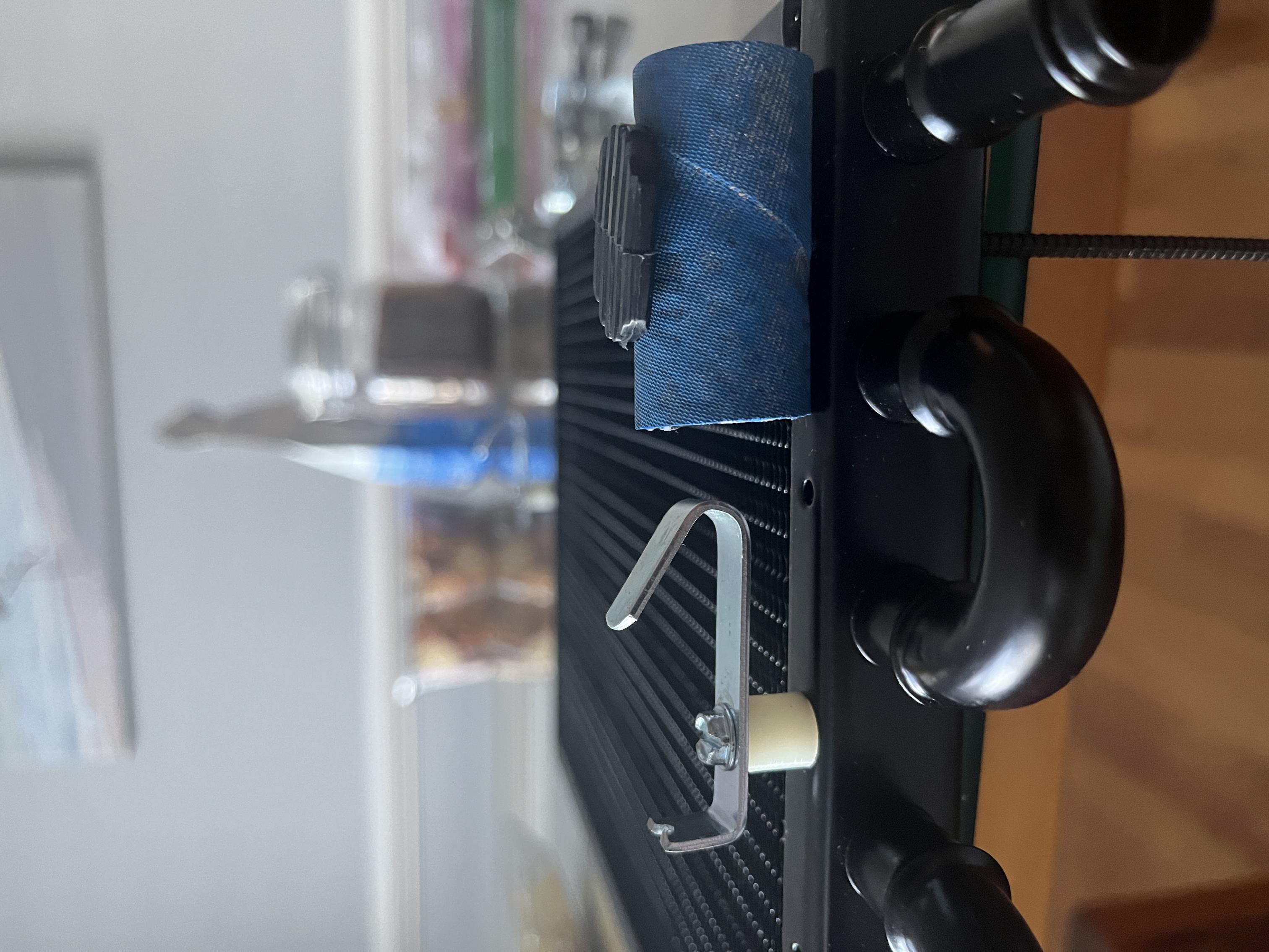

Went through three different approaches to figure out how I want to mount the new cooler. As with my last car I always like to include a bit of sketchy engineering to solve problems that most likely I have caused. A quick walk up and down a few isles at my local Ace Hardware racing supply. I came up with a few ideas. Goal is to get the cooler separated from the radiator about an inch thinking this will help with engine cooling. I have the radiator cooler straps that run through the radiator and while I have never used them I wanted the smallest amount of stress on the vanes. I cut a few pieces of hose about 2 inches in length and drilled a hole in them to use as a cushion and spread the load against the vanes. Since I do not have a fan or a shroud I have an aluminum bar across the radiator holding the current cooler. I decided between a 1 inch conduit bracket and picture hangers. The conduit has a rib in it so I used an 18mm socket as a dolly and hammered the rib flat so I could drill a hole there and mount to cooler and use the holes in the bracket to mount the bracket to the aluminum bar I currently have in there.
Conduit bracket with hose pieces in the background. Bracket would be on the cooler as pictured and provide the separation. Concern was this was too far away to use the hose.
100 pound picture hangers.
A visit with the Dremel and a small spacer and you get this. Hook goes over the bar to support all of the weight which will be way less than the fan and shroud along with how the hose pieces to be used far vibration protection along with securing the cooler a bit.

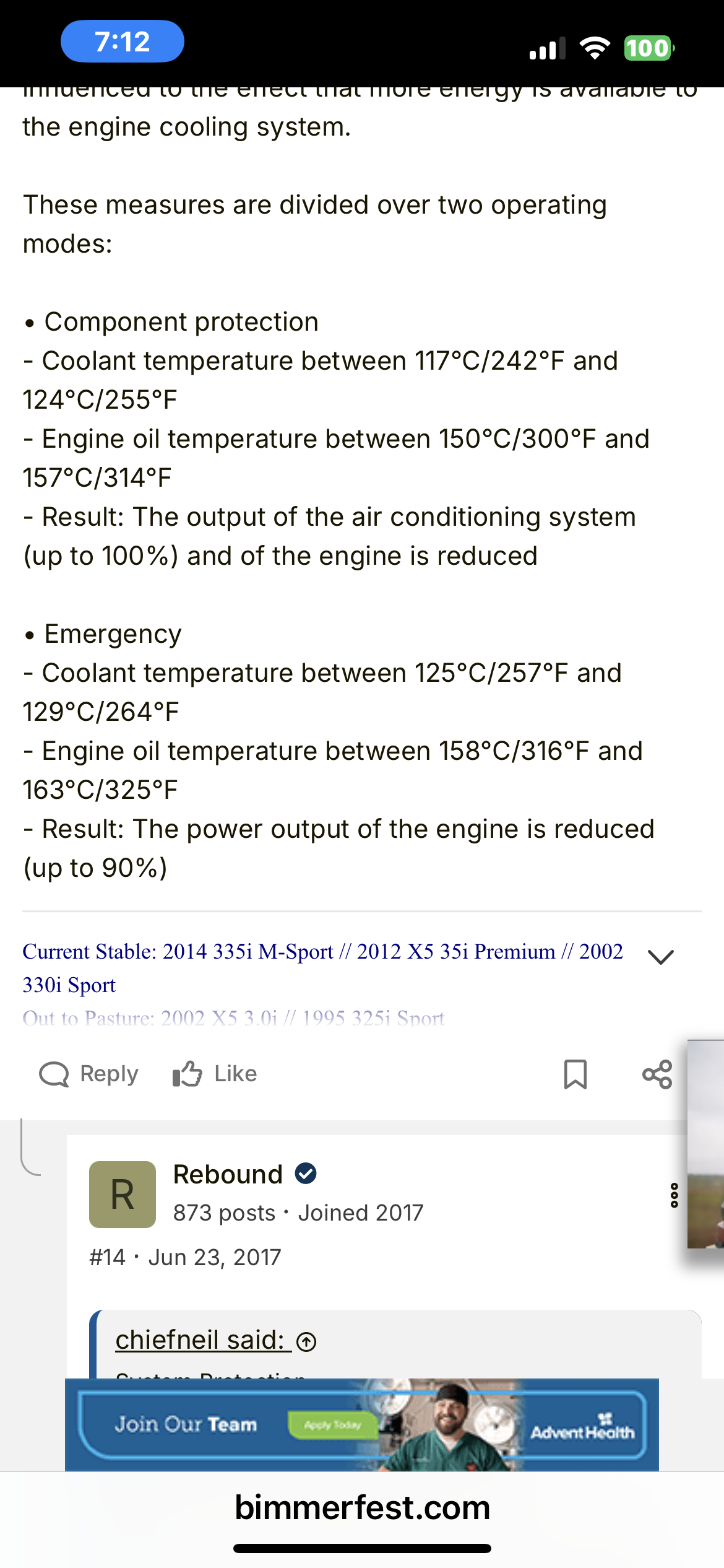

I still worry about coolant temps and I did see as high as 235 on the mechanical gauge. If I run the defrost cycle on the car the temps dropped to just below 230. In BMW world that may be okay but my car is not producing enough power so I know there will be more heat to address down the road. The came with a tune from MHD and they have 3 different cooling setting so I think that addresses water pump speed. Since BMW is picking up temps from the oil system, my thoughts are that adding the second oil cooler tricks the ecu into thinking things are cool enough. Would love to get under 220 if possible. Will be back at the track Thursday and plan to get the car smoke tested to check for any leaks and then tune to @350 hp. Should be fine for the weight of the car and I think with the few bolt ons the car came with I can safely go to around 400.
Here is a screen shot of the temp information I found when scrounging the web for ideas on the cooling. None of this has been confirmed so your results may very.

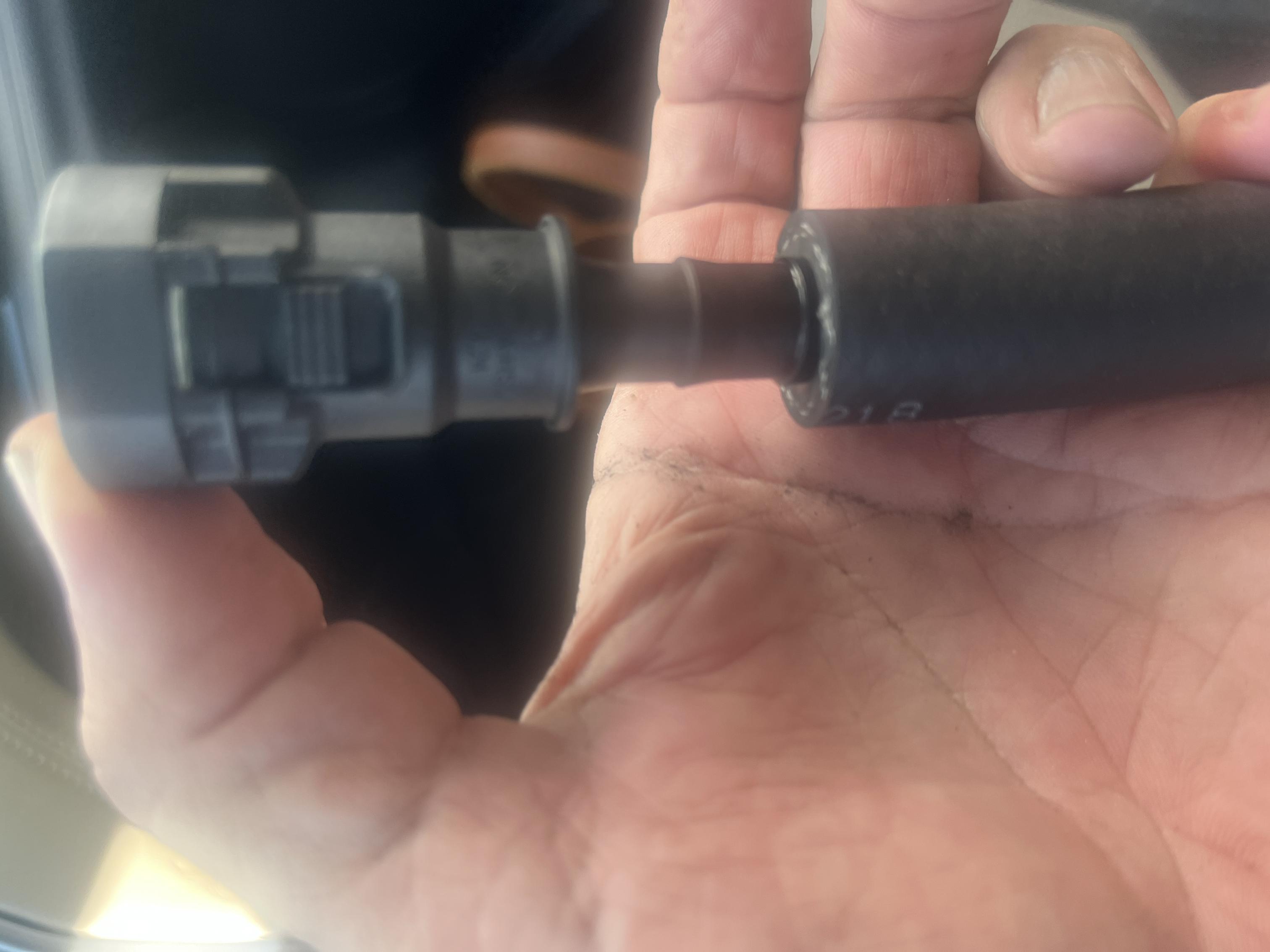

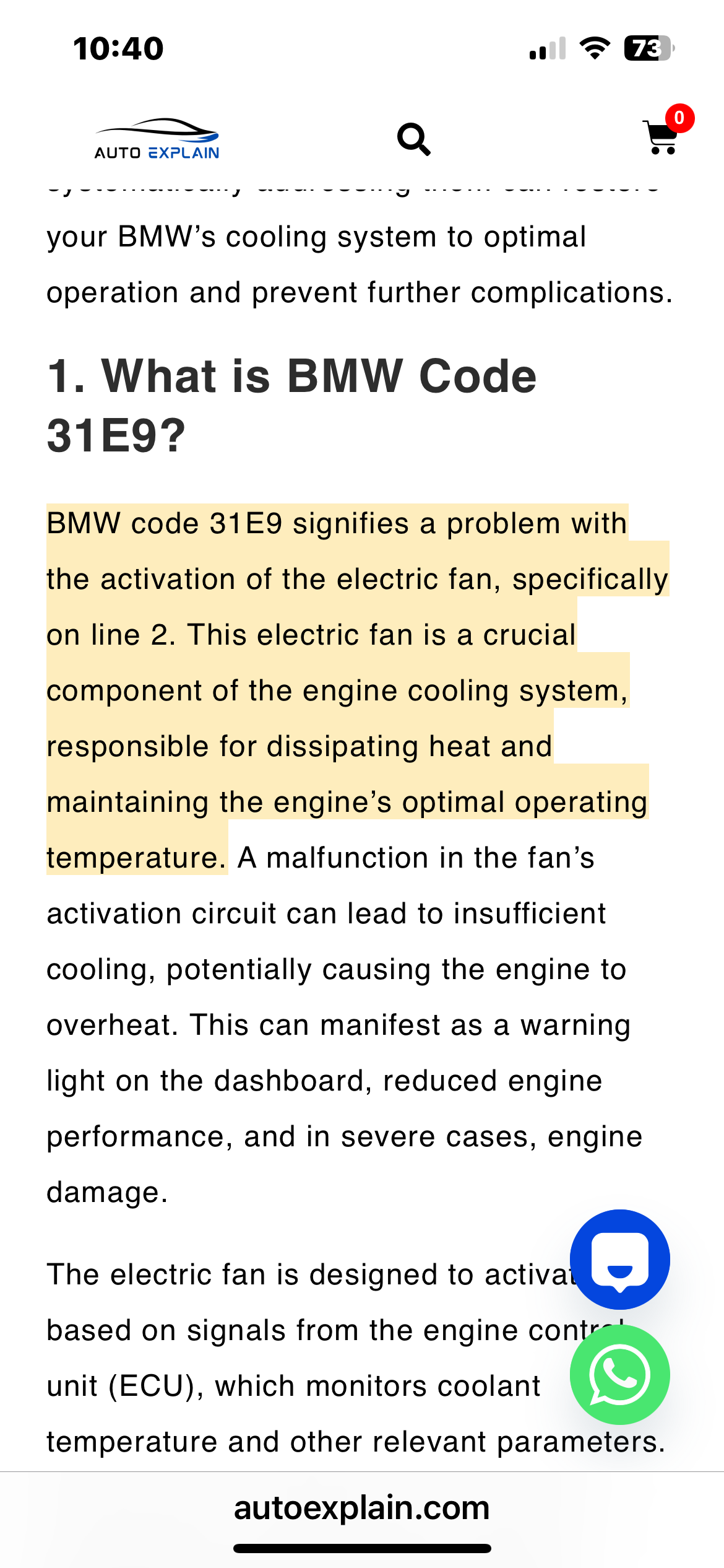

Some digging last night into the fan error code 31E9, I found this. It is a confirmation that this may be my issue and also allows for some theory testing as well as electrical shenanigans to fool the ecu in the event I choose to do so:

Quick update. I bought a fan shroud and will install the fan and see if that does fix the lack of boost issue. I hope so as I would like to finish this car and get it doing what it' supposed to be doing.

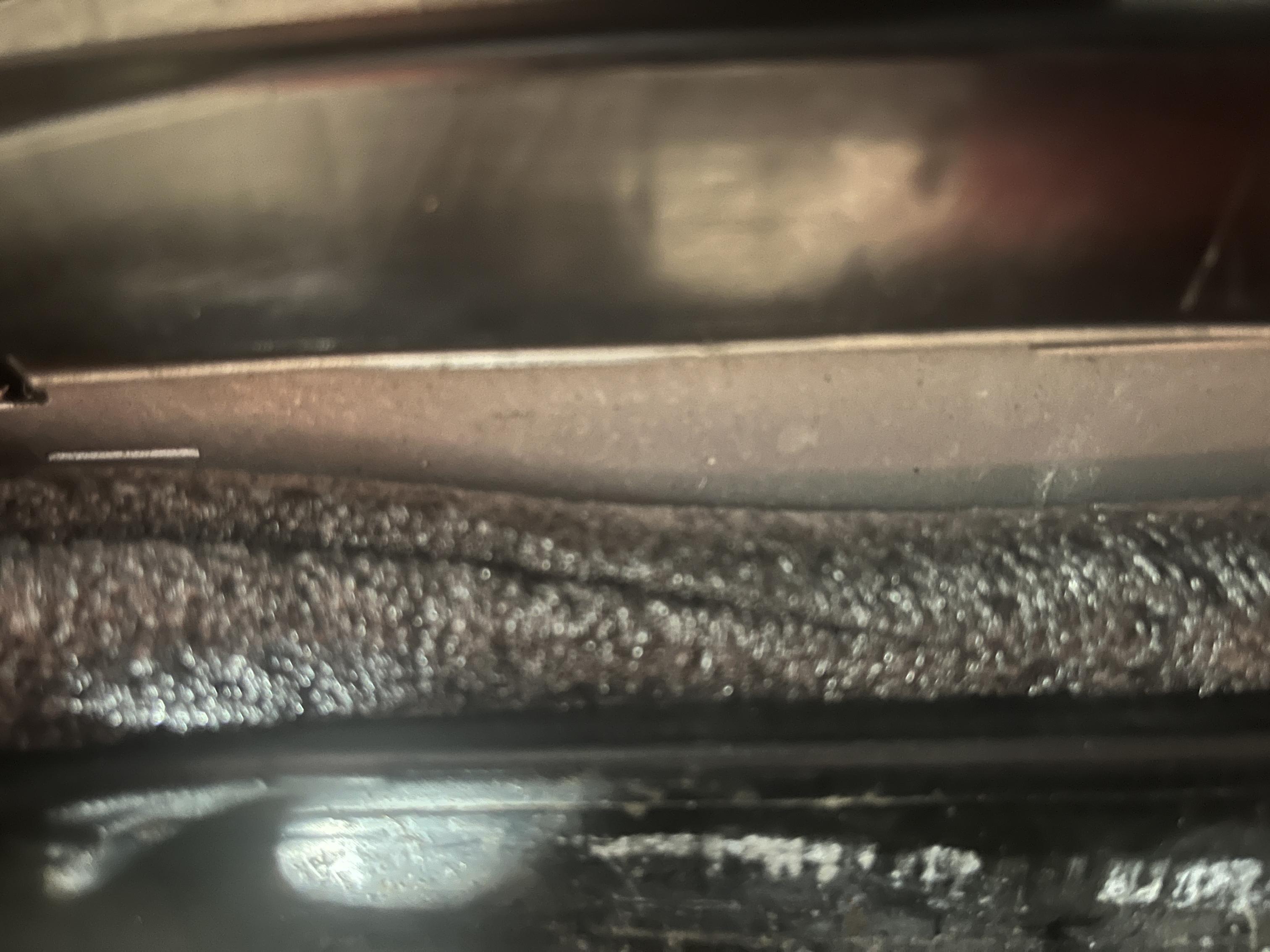

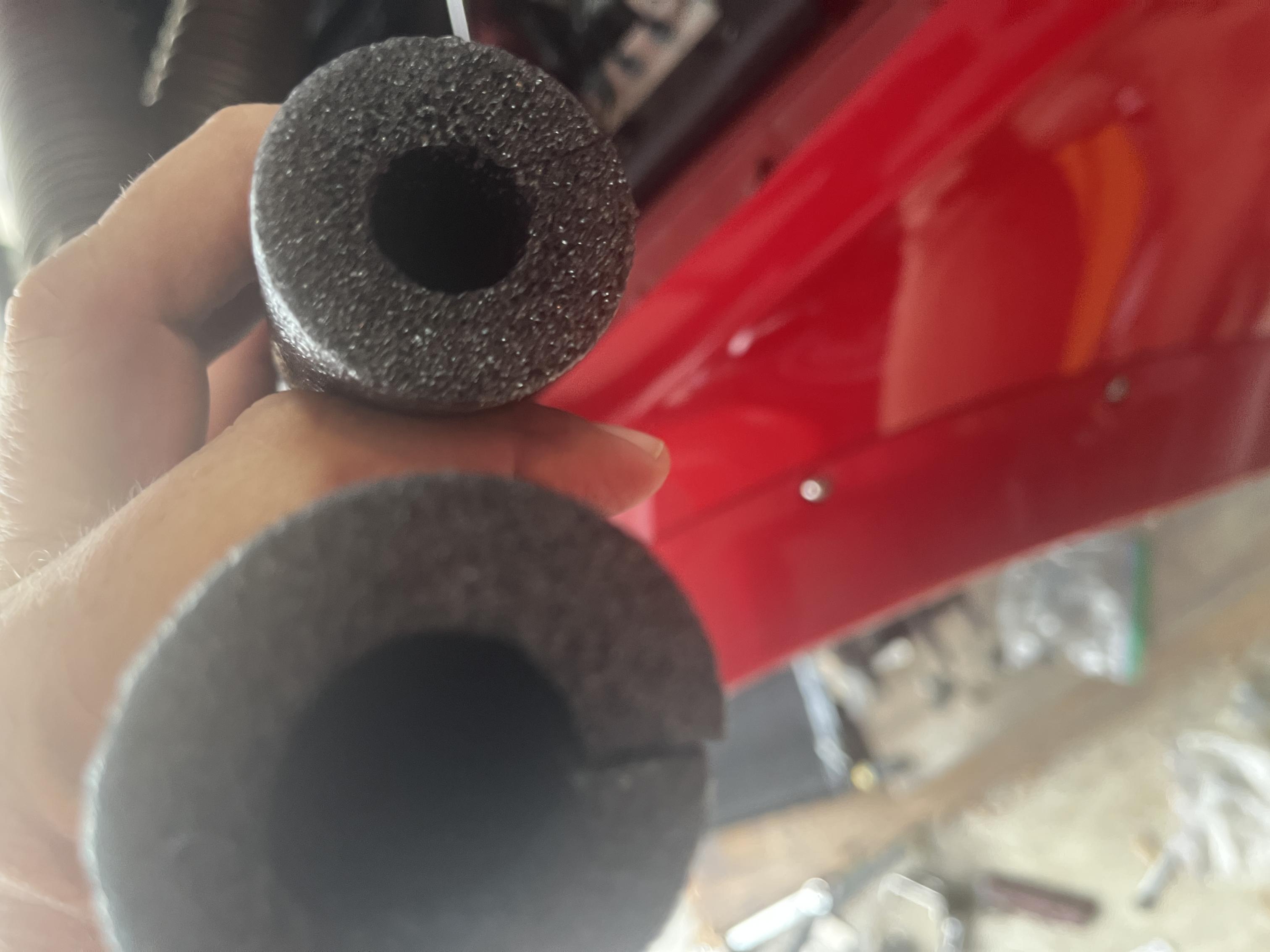

Okay, one more before Christmas as it has finally been warm enough for my fat old frame to lay on the concrete floor! The fan has been in and out and looking over my handiwork I am sure that part of my overheating is due to my own stupidity. There are a few gaps that are poorly addressed by BMW and I did not put some of the gaskets back when I did things in the radiator install. I keep forgetting about high/low pressure and there was a gap above the radiator that was about an inch tall so that would equal to a few square inches for air to escape that I would prefer go through the radiator. So I looked around the rest of the plastic that hold it in place and there are a few more spots that will be addressed as I button everything up.
I use pipe insulation like you can buy at a hardware store. It comes in a few diameters and you can shape it pretty easily and there is no gap at all between the top of the radiator and front cross brace. I will address a few smaller gaps buy cutting the insulation lengthwise and folding it into the voids.Name:  IMG_0985.jpg
There is a bit of a crack between the fan shroud that will get closed with duct tape to insure we get as much across the vans as possible. Since the fan is going to be taking up the spot for the DCT cooler that needs to be moved so I dropped the intercooler to mock up a new position behind the ps cooler in the space vacated by removal of the ac condenser. There is about 14 inches of space top to bottom so there is plenty of room to put in the cooler. The hoses will route around to the rear of the fan shroud and fill small holes between the fan airbox and the edges of the intercooler.Name:  IMG_0991.JPG
I will add the hose claps and mounts once I get the hoses connected after I put the intercooler back and the fan in. Did get to drive the Porsche a bit but it was damp and cold (sub 45) so nothing spectacular. There will be other days for both cars as I think they both are going to be keepers!

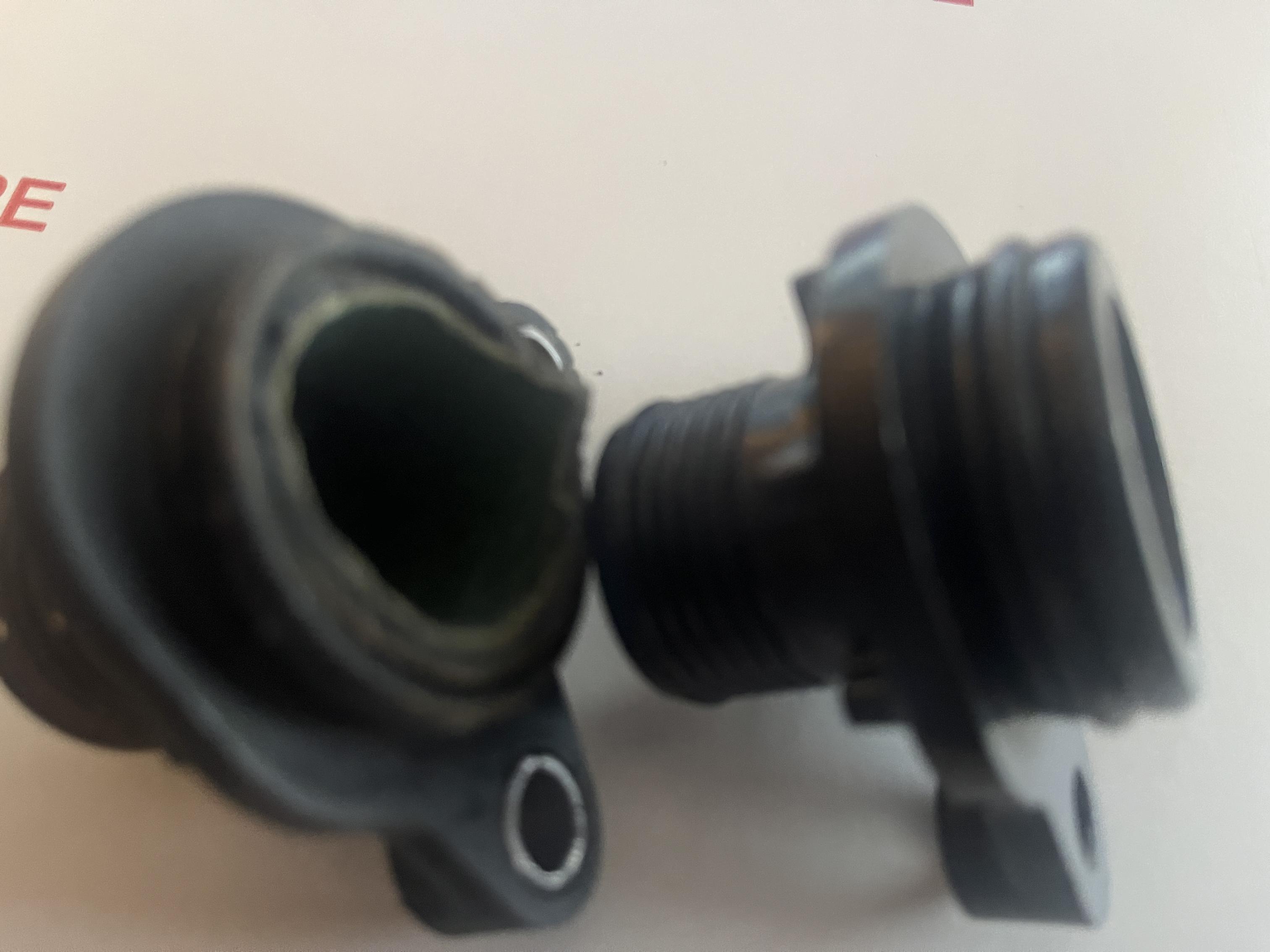

Checking notes and misc. parts in one of my tubs I came across a part that I had but had no idea of what it was. The Mickey Mouse flange, I know now but was completely ignorant on this little gem from BMW. More cheap plastic in high temp areas. Got it swapped over as it was on borrowed time.

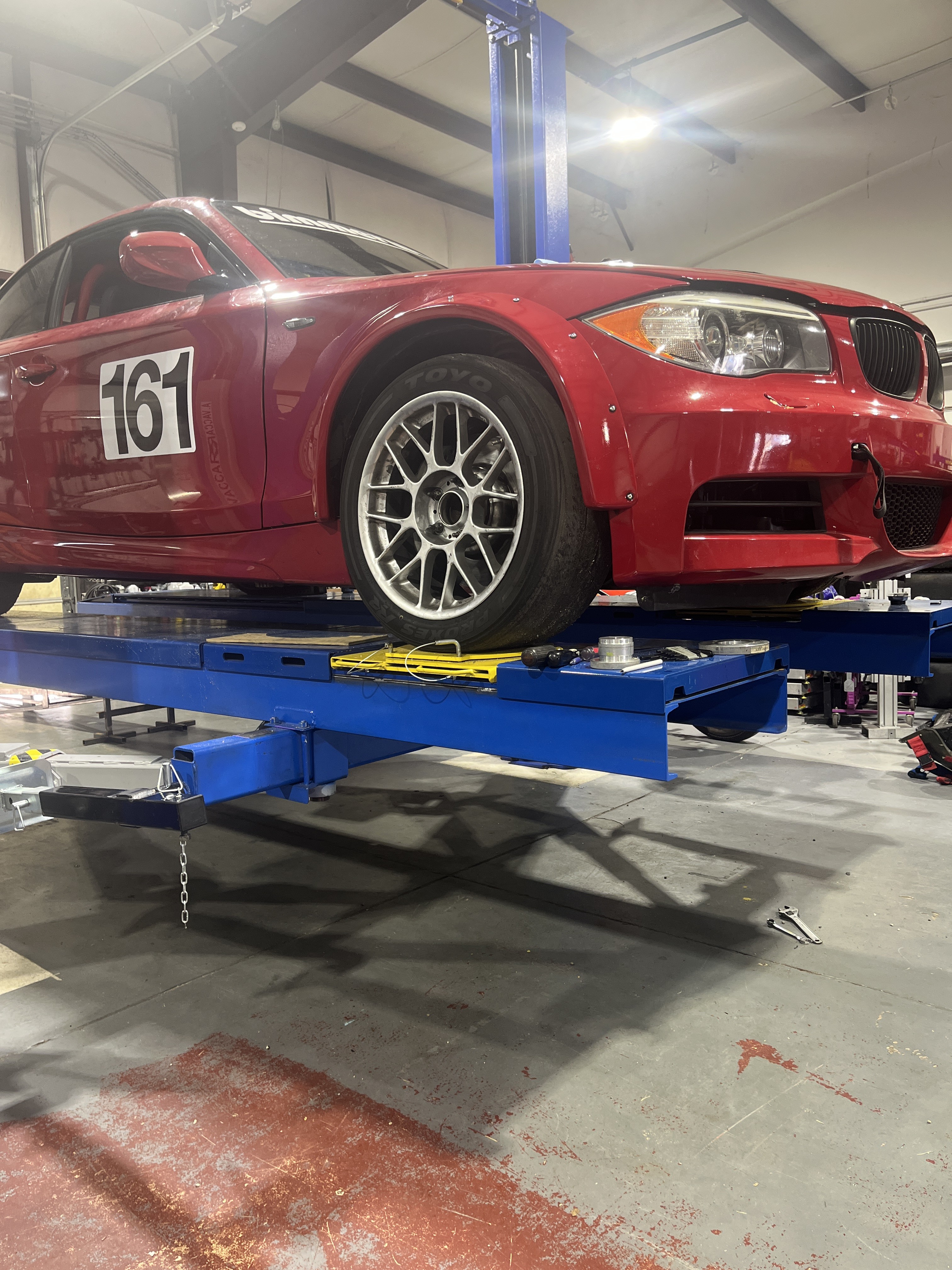

No pictures today but we did have a start today as I am ready to button up things in hopes that the fan addition cures my lack of boost issues. An interesting note is that after I replaced the Mickey mouse fitting, I filled the coolant and did a purge. I was unable to run it for 10 minutes due to other obligations but yesterday I had some time and was able to do it. What I found interesting in all 3 attempts is that the water pump kicked in without me engaging the pedal. If anyone knows why chime in. I though it was because a sensor was not wet somewhere but the first two try's lasted more than a few minutes so I thought this is a new issue. Yesterday, I returned to the car after 15 minutes and the pump was still running! I did not have the fan plugged in and when I did the fan shut off, so there is something to the fan affecting the ecu since if I understand correctly it is controlled by it.
No leaks but my hoses are really close to the crank pulley. I run my hoses so the cooler is being fed by the exhaust house (top) out of the heat exchanger. I think if you go the other way it is simpler. I will get back under there with the racing zip ties and see what I can come up with. If I don't get what I like I have two options. Both involve removing the hard lines off the dct. I would then cut the swage from the oem pipe to hose and plumb in new lines directly from the pipe to the cooler. The other choice is to put in an aftermarket fitting on the side of the trans which allows you to run dash 8 hoses directly from the dct all the way up to either the cooler and or heat exchanger with freedom from BMW engineering. I hope I can get what I have to work.
Regardless the car is going down to GMP in Charlotte for a once over as I am sure I have something screwed up somehwere and maybe I should get some adult supervision.

Sketchy part is my plumbing for the DCT cooler required me to align the hose clamps so I could use the indentation of the crank pulley for clearance. I might revisit this during summer break and run the aftermarket fitting on the trans that allows you to run an hoses. Gives me a bit more options when running the hose. I am running the hot side into the heat exchanger and then up to the aftermarket cooler versus the other way around.
We have boost! I don't now which item fixed it but putting the fan back in did remove a code that code put the car in reduced throttle.
Few weeks back I woke up in the middle of the night and it came to me that when I flashed the car with the MHD software I limited the throttle in 1-3 gear! DUH! I did this because I had not ever driven the car at full throttle and had no idea of what the lag or torque would be like and .......forgot about it as I got distracted but the high temps. So excited about remembering that I woke my wife up to tell her! She's still pissed about that.
Temps, much better. After sealing off the top of the radiator completely I came off a full out session where I did the passing and no one ran us down and the car was about 180 when we got back and parked. Last time out it was similar temps and I had to run the heater to keep the car under 230.

Quick question, I'm going to be installing my Accusump in the same location as yours. I can see how the top half of you're bracket was secured, and I'm wondering what you did for the lower bolt hole. Did you drill into the metal and use a rivnut? I'm hesitant to do so with the gas tank being behind there.
Name:  Screenshot 2026-03-08 at 5.21.25 PM.png

Rivnut. I will see if I can find the post on here. I used M5 I think. Will get back to you. Just got home from 5 day trackapoluza. My old, fat ass, is dragging. Both cars ran great!
