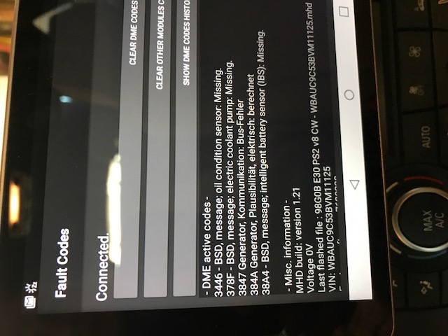

Long overdue update. About a month after this thread started , I went to a half mile event in October 2017. It was 90 plus degrees. All was good until the last run of the day, when this happened:
Scared the crap out of me. After Kerri f the car sit for 30 min she started up and went straight on the trailer. Never had the red battery or car meltdown issue again until about a year later when the red battery light came on driving home and voltage via mhd was in the 11s.
Didn’t really troubleshoot anything because if time but stumbled across these two threads today.
https://www.e90post.com/forums/showt...0#post23783060
https://www.e90post.com/forums/showt...3#post23783063
I installed Delphi coils at the same tune as my ps2 install and it appears these have been the issue the entire time!

Ok, so the code popped up again. This time i had MHD connected. 35 min drive home, volts via MHD were around 13.8ish. Then as I am getting close to my house cruising at 25mph, the red battery light comes on, i look at my tablet, and the battery volts is at 11.4!! Uhh, what the..
This thread has been a lifesaver. Replaced my battery 2 weeks ago, and today I pulled the EXACT same code sequence you have pictured. Only difference is I currently have PR coils. Did your coil change resolve your issues?
