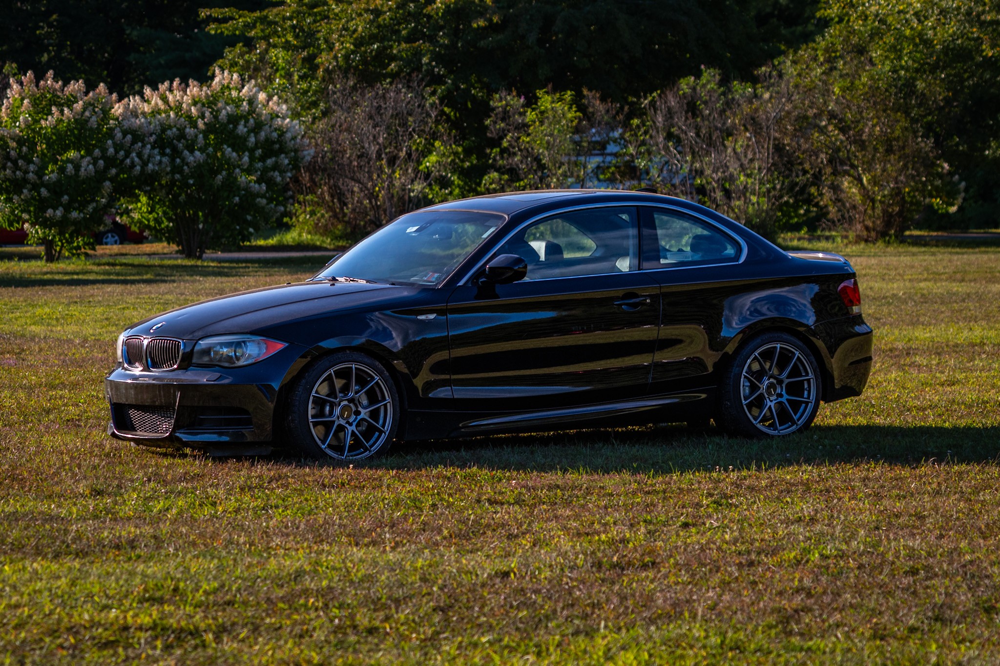

      08-21-2025, 12:58 PM   #14
E13
E13's Avatar
57
133
Drives: 2012 135i
Join Date: Jun 2024
Location: MA
Update:
They rub a little. Might be my shot dampers, but they still rub. I could see them fitting if you cut the fender instead of rolled it, but I don’t know if that’s a good idea

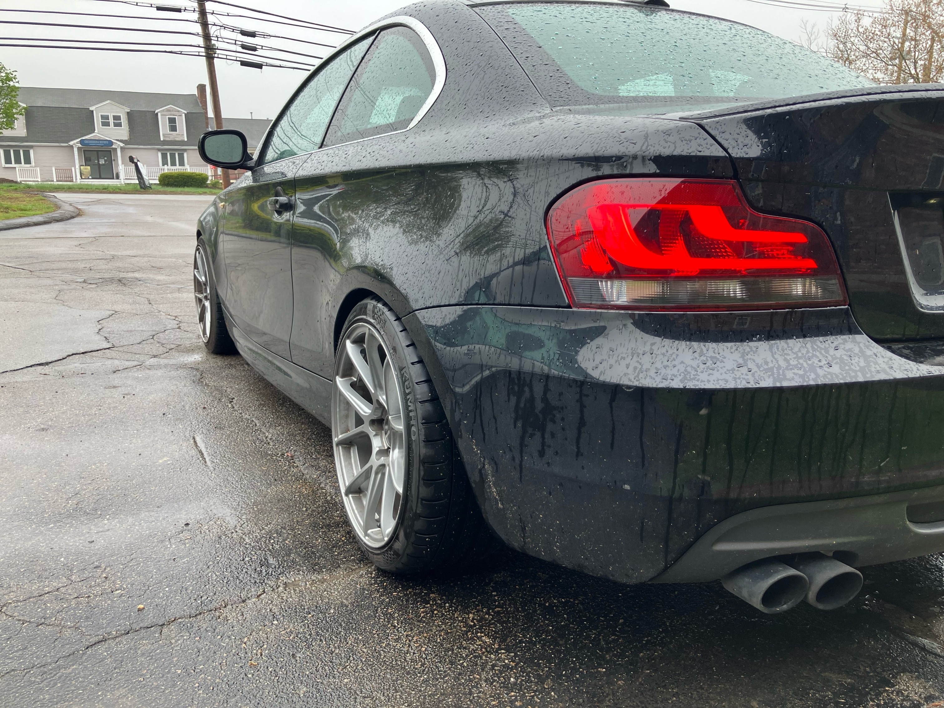

      05-13-2026, 02:09 PM   #16
E13
E13's Avatar
57
133
Drives: 2012 135i
Join Date: Jun 2024
Location: MA
The rears rub even if I pull the pins with max camber, but they don’t rub hard. The Fitment looks great. I tried rolling the fender myself but the rears were so stiff that I wasn’t comfortable doing it so I brought it to a shop, but honest to god I swear they didn’t even touch the car, I don’t think they rolled it at all. I should’ve said something but this was a while ago and it’s a bit too late now.
I will say the Kumhos are quite stretched, so if you try this set up with a squarer tire it might not work.
      05-24-2026, 06:16 AM   #17
ShocknAwe
1Addict
ShocknAwe's Avatar
5209
9,146
Location: Charleston
iTrader: (22)
Rear fender lips are really hard to roll. They're structural, can't get much out of them. The wheels poke quite a bit from your photos.
