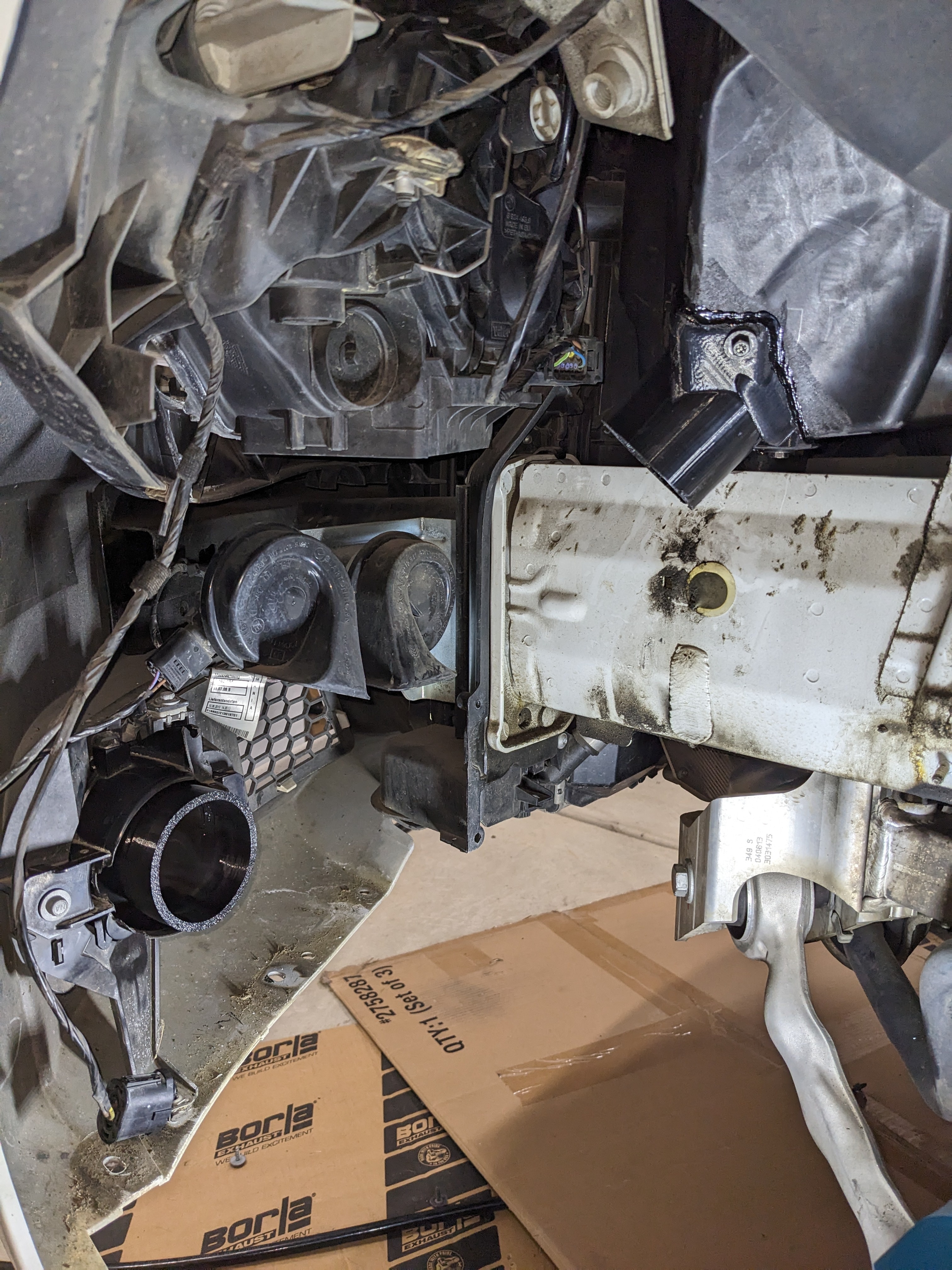

shout out ZHPizza for the inspiration!
I modified oem 135i oil cooler ducting to fit my 19 row cooler. First time plastic welding, im pretty dang happy with how it turned out! Next up, I have chilledn52 's new eurobox d-style ram intake on the way to fit. Again, taking inspiration with how zhpizza installed his.

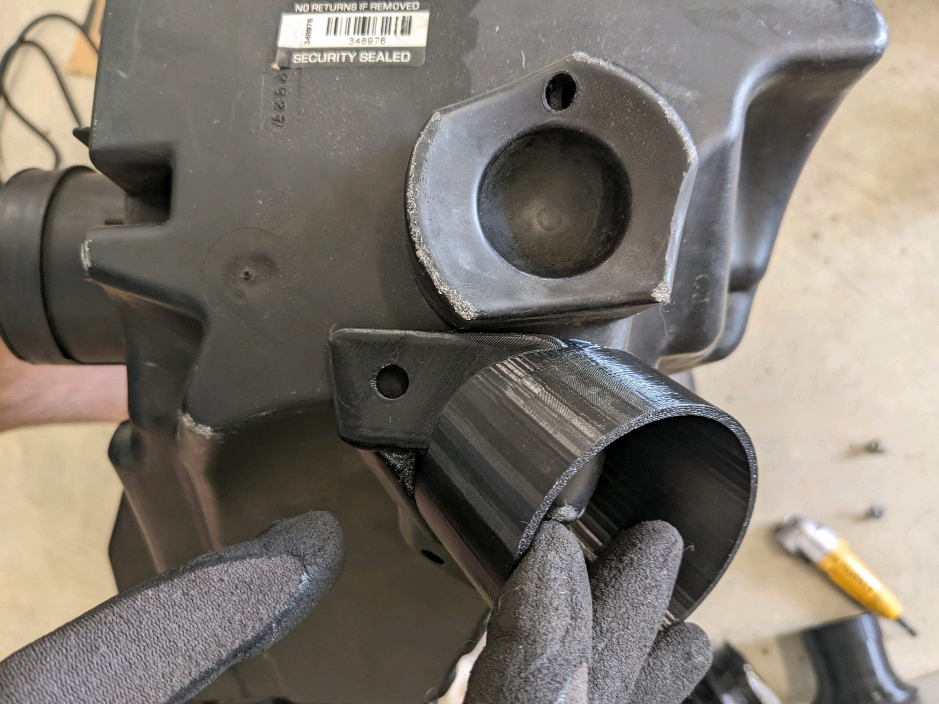

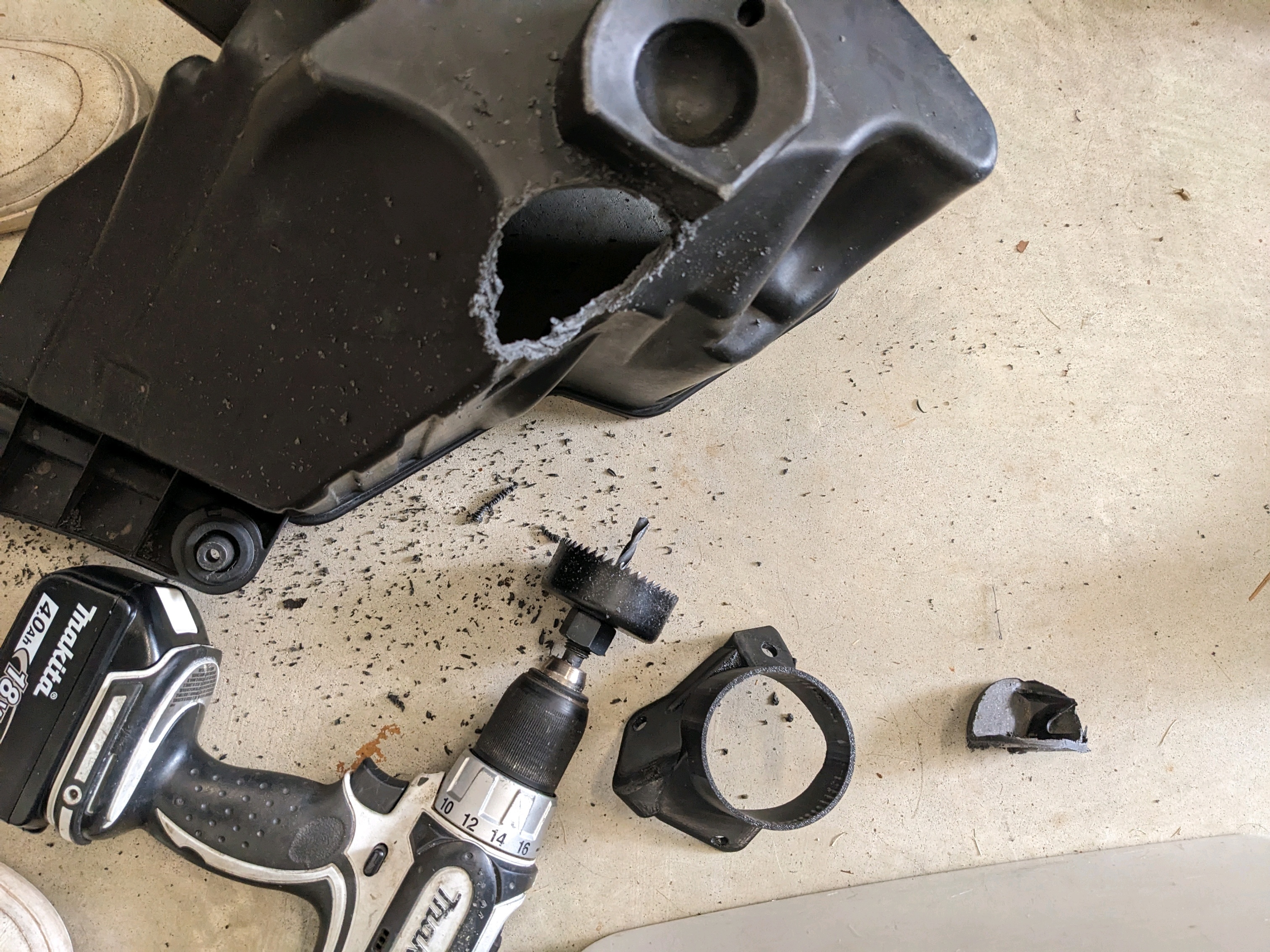

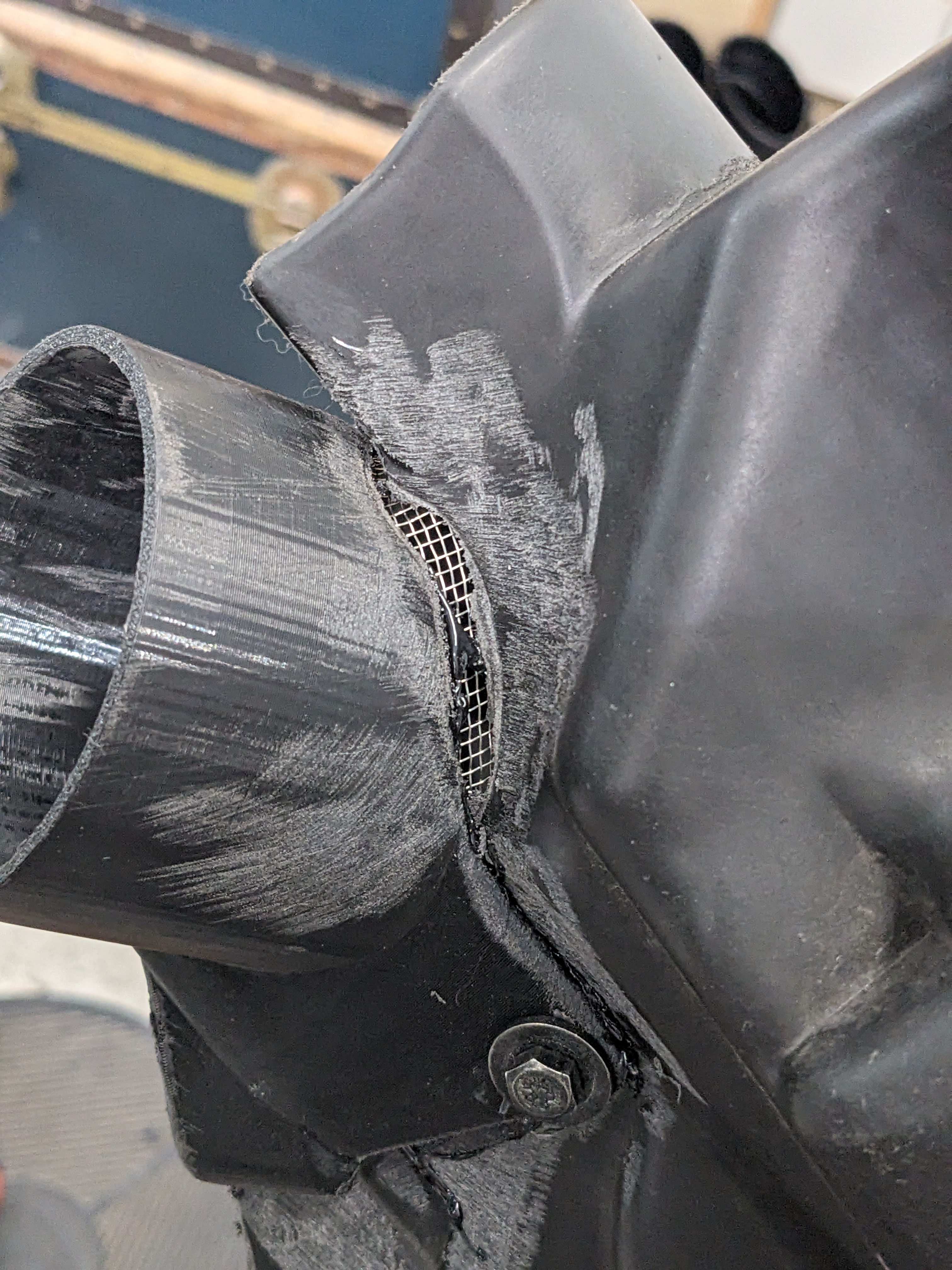

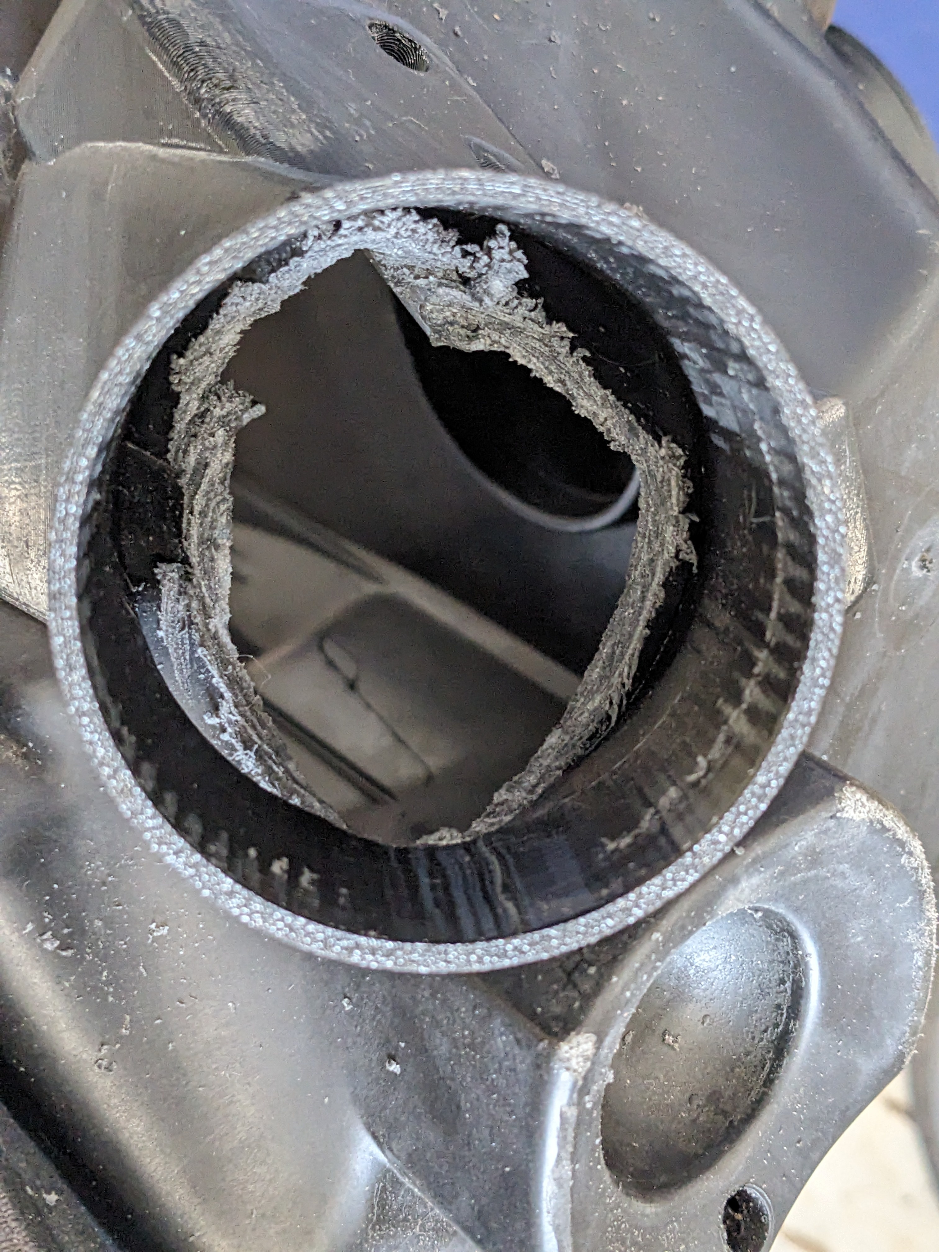

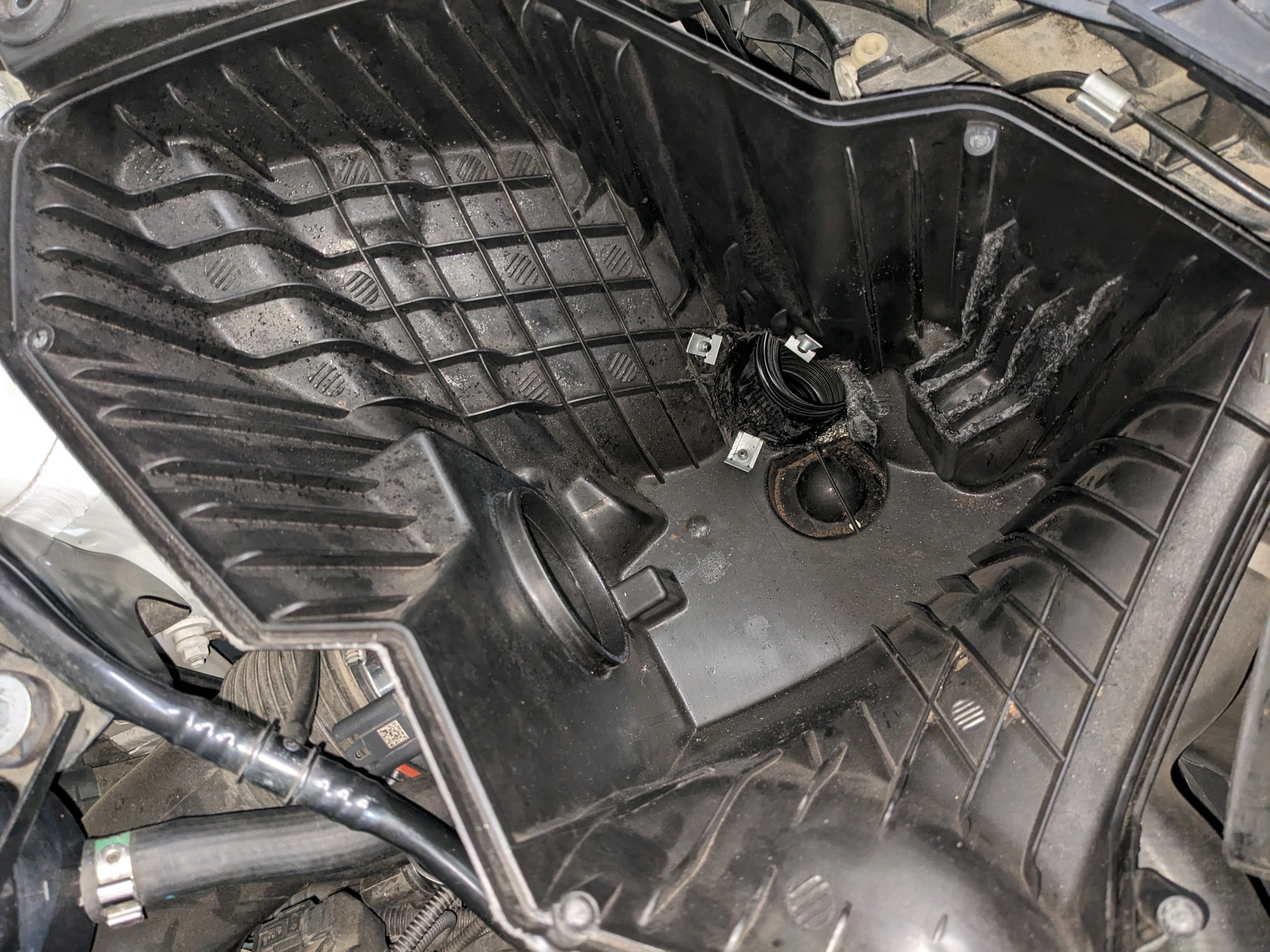

https://imgur.com/a/bEEiG5R

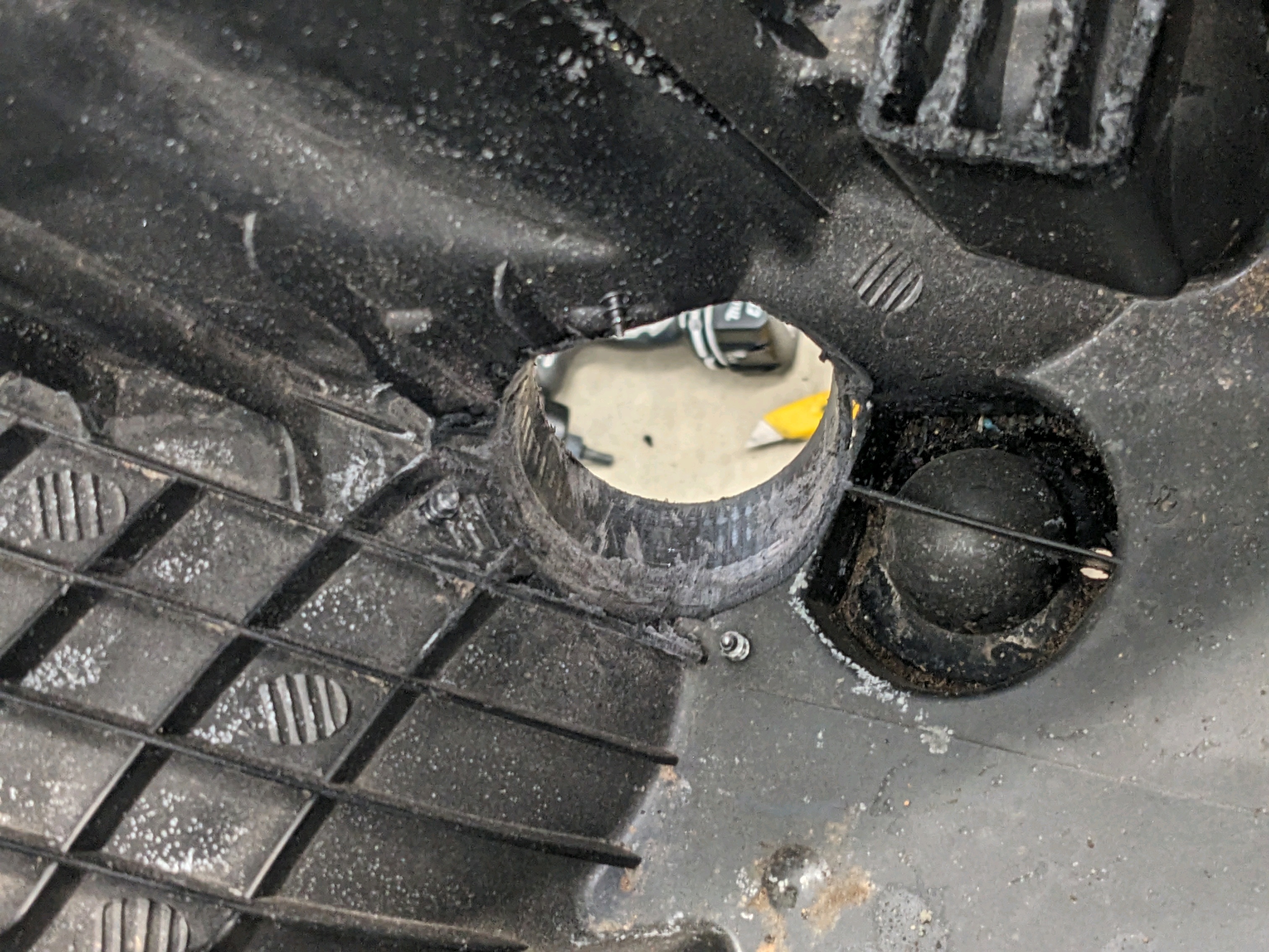

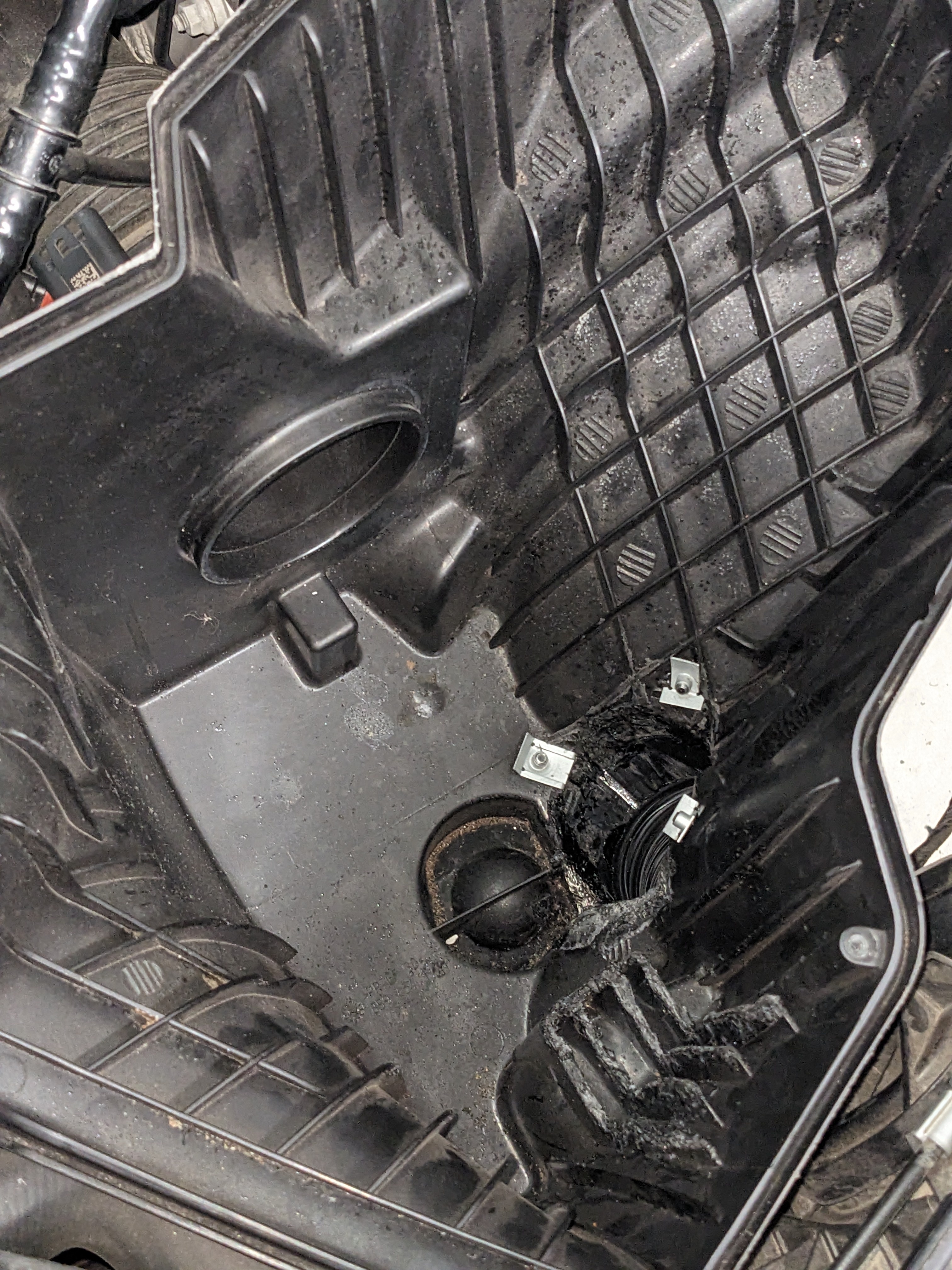

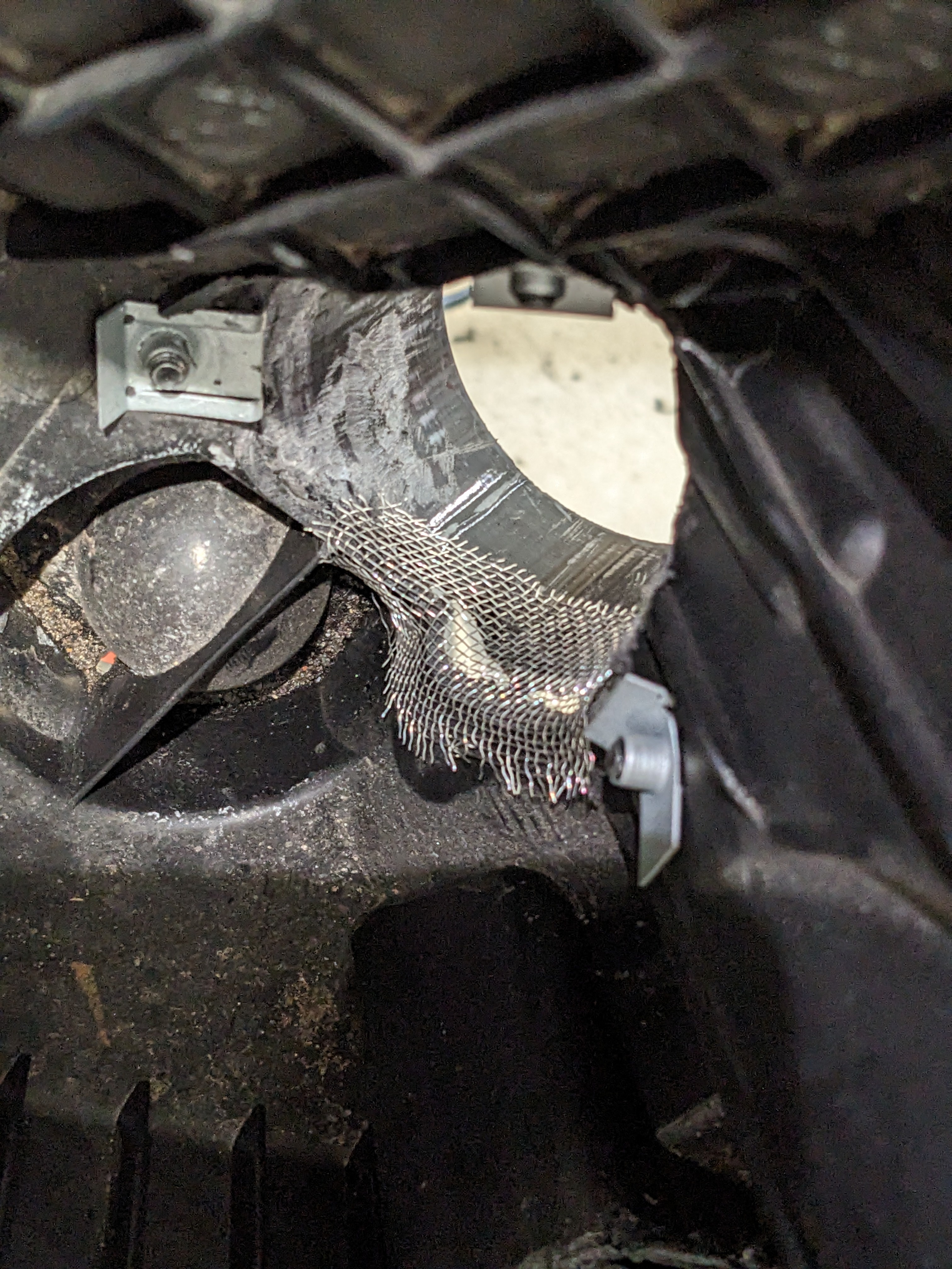

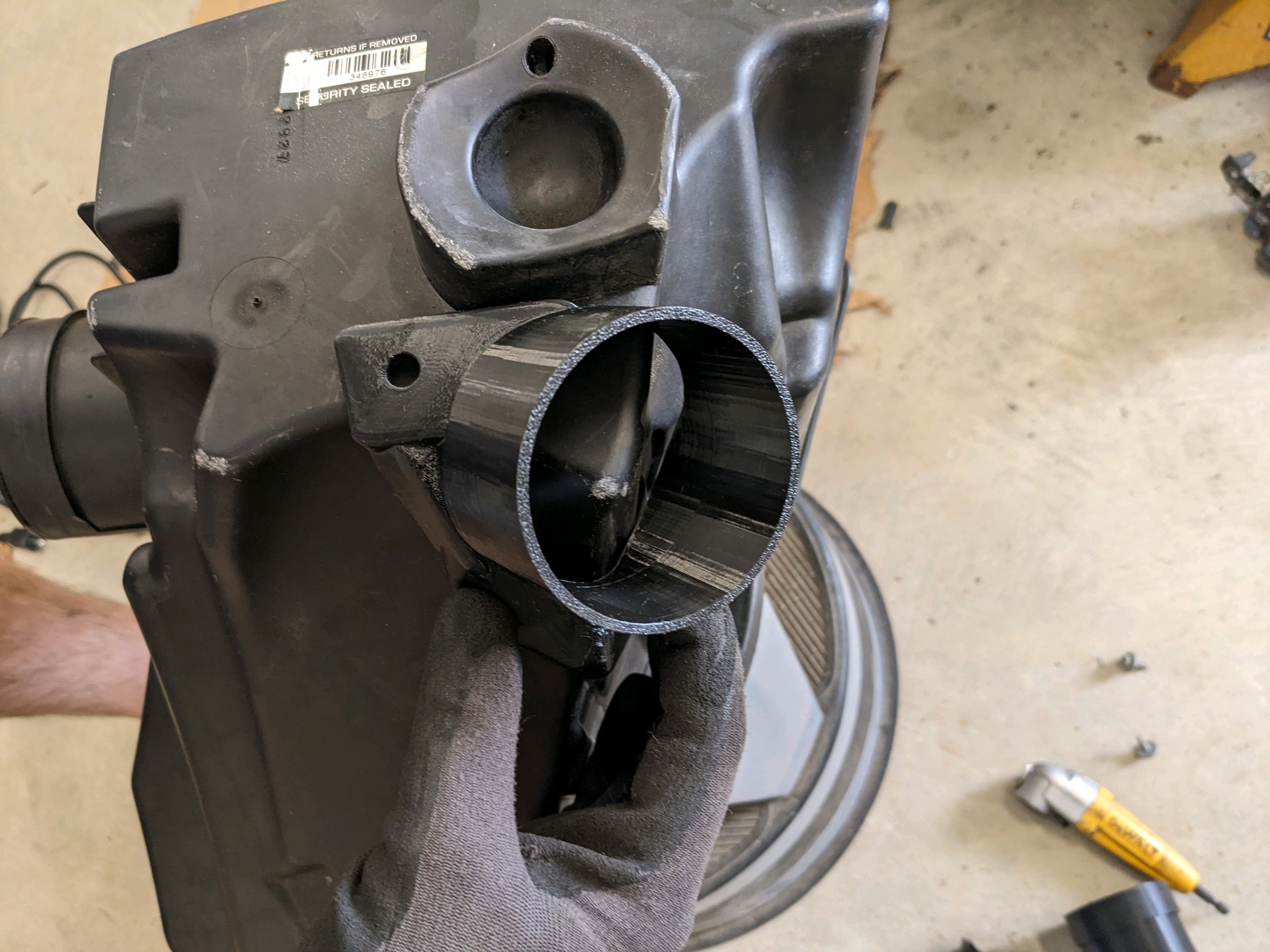

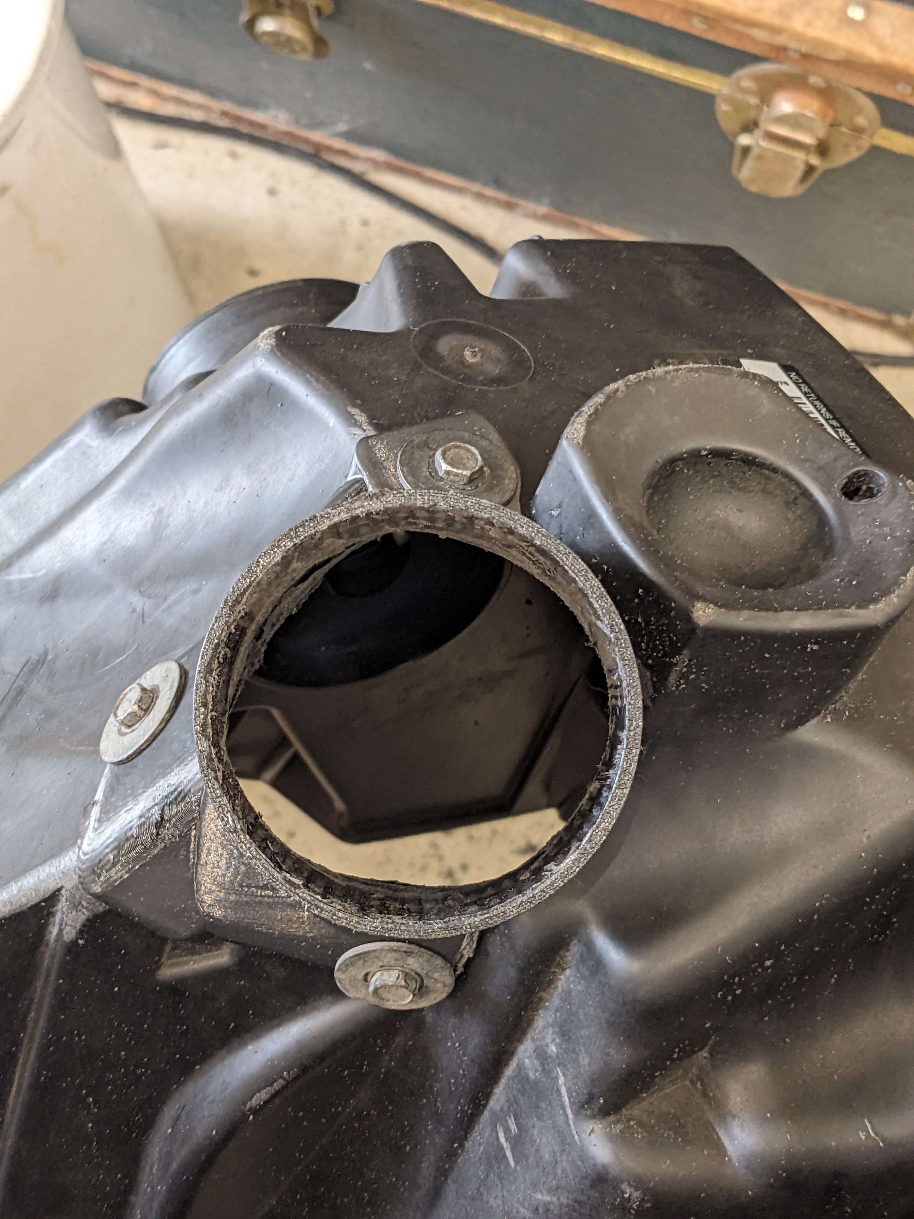

Excellent work on the cooler duct! Shockingly clean for your first time plastic welding.
I also used the printables adapter and it fit good enough — just had to use some glue to fully seal the gaps. Let me see if I can dig up some pics for you...
Yep, it's a mess of pics with no annotations showing a bit of the modifications that I had to make (trimming both the adapter and airbox, then going back and filling gaps).
Edit: I see now that he actually made one specifically to fit the euro airbox so ignore my pics of the shitshow that was modifying the US airbox model to fit the euro airbox lol
I also used the printables adapter and it fit good enough -- just had to use some glue to fully seal the gaps. Let me see if I can dig up some pics for you...
Hey!
So thank you for the shoutout! Looks like you got that fitted well!
That kit does look to be the US airbox, I do have a eurobox one specific, but we are doing a revision 2 at the moment trying to improve fitment from the scan data I got

Eurobox ram air intake is installed! Smooth install. I wrote up some comments on the imgur photos, I tried to upload to the forum but some of the photos were too large and I cba to resize everything. Very happy with the kit!
Oh and also I have some 17x9 et42 arc-8's in bronze waiting for me... I'll get to those later.
View post on imgur.com
