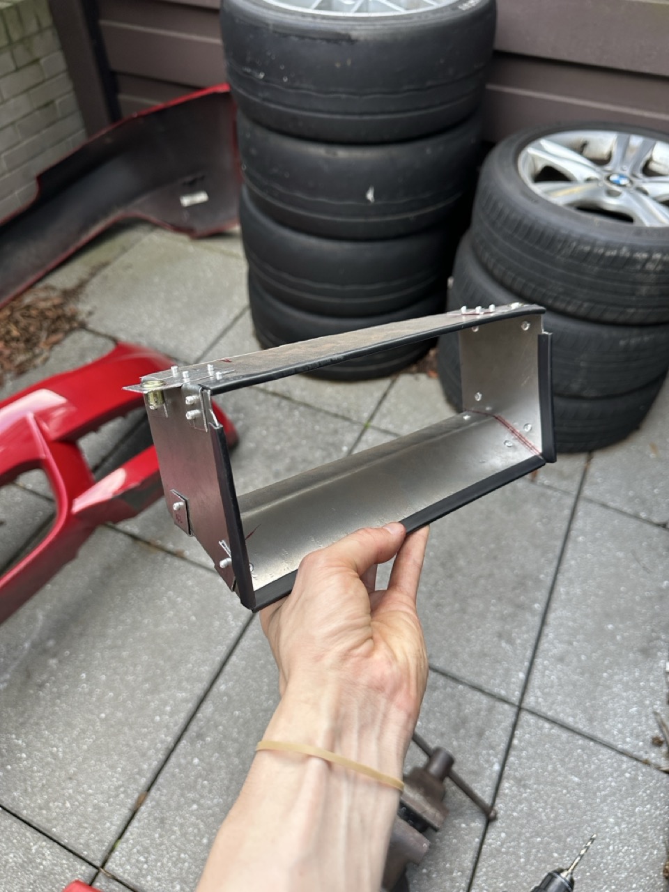

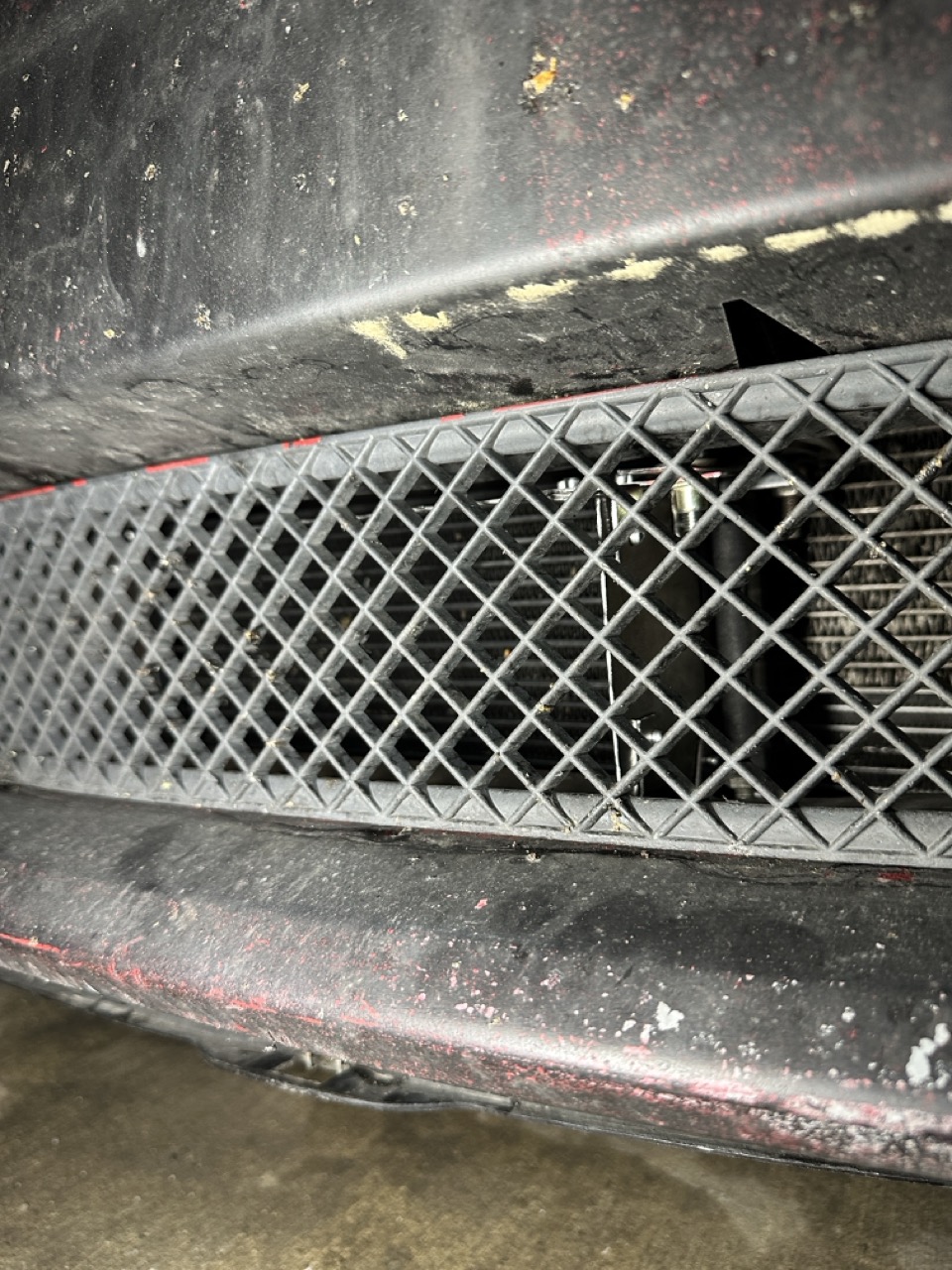

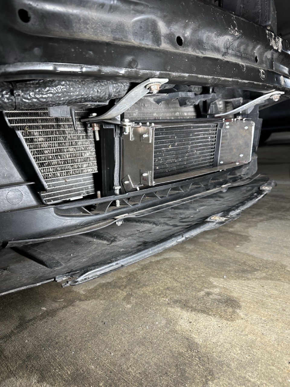

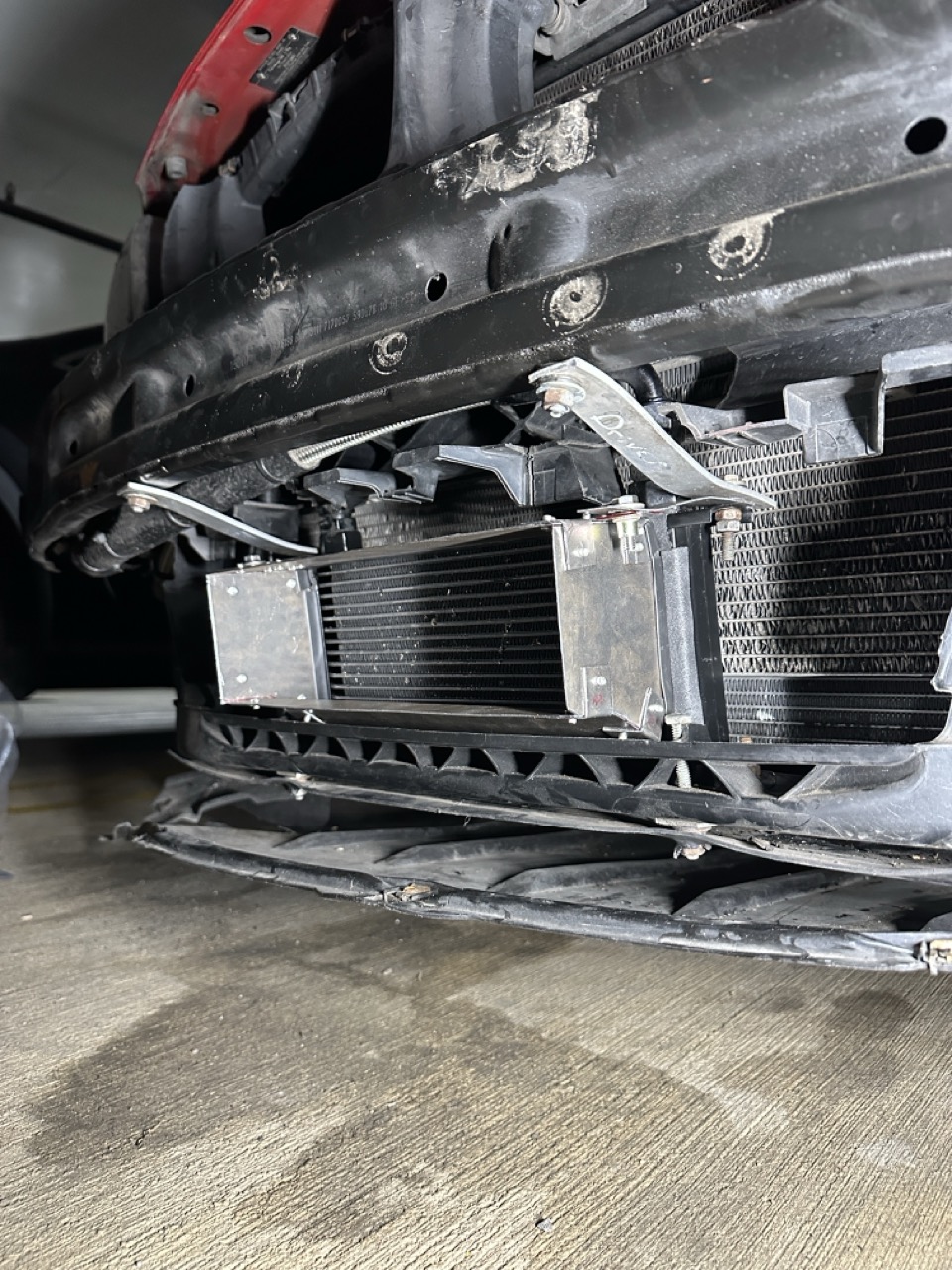

Oil Cooler Inlet Ducting
Points well taken on the ducting, and I'm happy to say I've created a very solid inlet to my oil cooler. It fits flush with the bumper grille, and maintains a few key characteristics.
1. Inlet area smaller than the oil cooler face.
The air rushes in the inlet, then you expand the ducting gradually to the oil cooler so the volume increases. This volume slows the air down, increasing pressure at the face of the cooler. This increases the pressure delta on the face and exit of the cooler, driving air through it. My inlet area is ~33% smaller than the heat exchanger area.
2. Gradual slope.
The maximum recommended expansion rate is 15 degrees, which I set my lower plate to. This keeps the air attached to the walls and prevents it from becoming turbulent.
3. Leaving a gap to the radiator.
Because of my damaged undertray/fender liners, leaving a gap to the radiator reduces the pressure required to force air through the oil cooler. This gives the exiting air an opportunity to be sucked away to a low pressure zone, potentially one below the car. If my radiator area were fully sealed, the oil cooler should be as close to the rad as humanly possible.
4. Completely sealing the ducting.
Using a flashlight, I tested to ensure there were no air gaps between the inlet ducting and the oil cooler face. Aluminum tape is on the way to cover the seams of the inlet ducting itself.
5. Inlet faces the direction of incoming air.
Self explanatory.
I'll be shaking this down at Summit Point this weekend. If temps continue to be higher than acceptable, I'll explore getting a new undertray, fender liners, adding exhaust ducting, and potentially a hood vent. Ideally I'd like to stabilize around 250F.

Inlet Ducting Test Results
The inlet ducting helped me get a few more full throttle laps, but it wasn't enough to let me run a full session at full tilt. It was 85+ ambient in the afternoon and I had the heat on full blast, but temps still climbed into the 275+ range.
My next step will be constructing exit ducting between the oil cooler and the power steering cooler + radiator. These sub 2" gaps are allowing high pressure air from the front bumper to sneak into the low pressure area behind the oil cooler, preventing maximum pressure differential for the oil cooler.
As another bandaid fix, I'm switching from Liquimoli Leichtlauf 5w-40 to Redline 10w-40 for the track season. This should give me more protection at higher temperatures and allow for two events between oil changes.
If the exit ducting isn't sufficient, the cheapest practical option would be going with a race louvers hood vent. The smartest thing to do is invest in sealing the floor with a new undertray and fender liners to maximize the vaccum effect. This would increase the efficiency of the hood vent as well. For now, I'm content to go one step at a time.

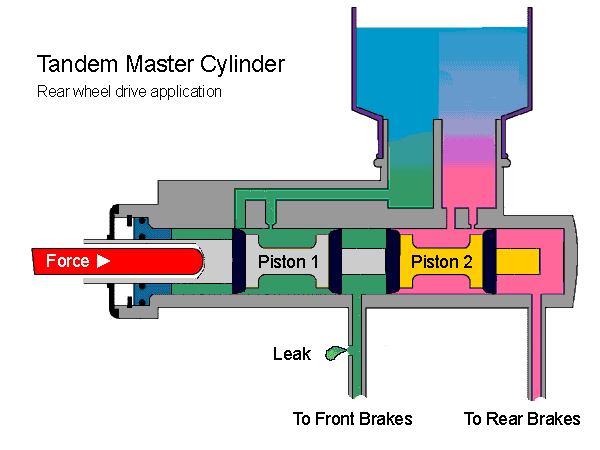

On the BMW 1 series cars, both the 128i and 135i use stepped-bore tandem master cylinders. This means both the front and rear circuits always see the same brake pressure. The brake pedal acts on the first (larger) piston, which transfers a fixed amount of brake pressure (i.e. 80 bar) to the front brake circuit and 80 bar to the secondary (smaller) diameter rear circuit. I've attached a visual that made this clear to me. As such, changing between these master cylinders will not adjust brake bias.

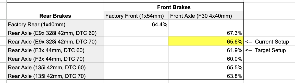

This research brings me to my reason for going down this rabbit hole. After switching to my current braking setup, I've experienced a tremendous amount of understeer and it's obvious why after looking at it. I introduced a massive increase in front brake piston area and rotor size, with only a small piston area increase in the rear plus additional pad friction to counteract it. These changes moved my bias 1.2% more forward than BMW shipped from the factory, so my rear tires are underworked on track. Using a brake force calculator, I've identified complimenting the F3x front brakes with the F3x 44mm rear brakes is a way to shift my bias significantly rearward. I can achieve this while running a lower friction pad, which gives me the opportunity to move bias even more rearward if desired. It's almost like BMW designed these two to work together from the start. This ultimately arrives at a 62% front bias, which is 2.5% less than factory and 3.7% less than my current setup. This is right in line with the M235i race car which runs on slicks, so i expect to be in a safe range.

I considered the 135i rear setup as well, however it didn't provide enough flexibility to shift my forward bias lower than 63.8%. 335i brakes would've been a good option as well however Hawk doesn't make DTC60/70 pads for them.
