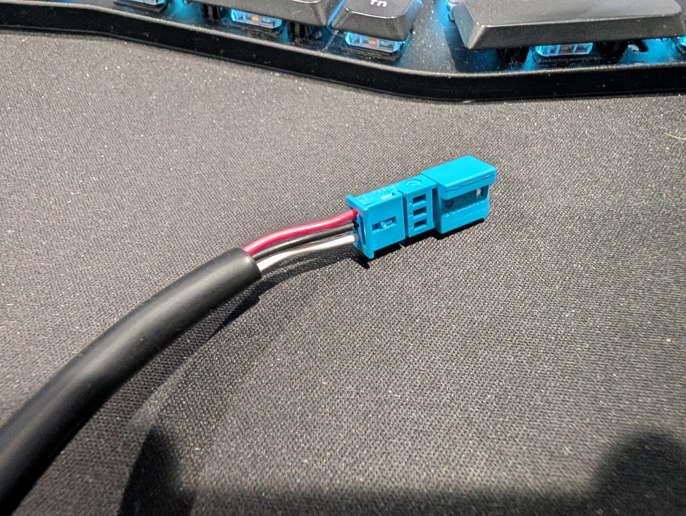

Well, I rolled the dice. Turns out that the connector to the seat is identical. Same part number. Different wiring though. I hooked up the female end of the seatbelt / SRS in the main connector, just have to figure out the side now and the occupancy sensor.
The 981 seat doesn't time out like the BMW's without can. Just give it power and you can do all the adjustments.
The blue connector is the one from the fan in the seat. Red and black are obvious, but white I believe is PWM for speed. If you connect white and black, the fan spins at 100%. I think I'm just going to put this on a toggle unless anybody has a better idea of how to control via PWM.

DONE!!!! Fully installed with ventilation and airbag function - no seat heating. Can't test function yet because now it's cool and stormy.
Besides the mounts, you'll need to:
machine a custom shoulder bolt to mount the seat buckle
fabricate a bracket to position the buckle
re-pin the side air bag connector
make a jumper wire for the seat position sensor (this is polarity specific)
switch the main ground to the last pin in the seat connector coming off the car
wire in the spare 3 wire connector to ground and power (I have no idea what originally connected to it)
wire a switch to short ground to white for the fan
code out the occupancy sensor - I'm not good at it, claude was a disaster, chatgpt was way better.
