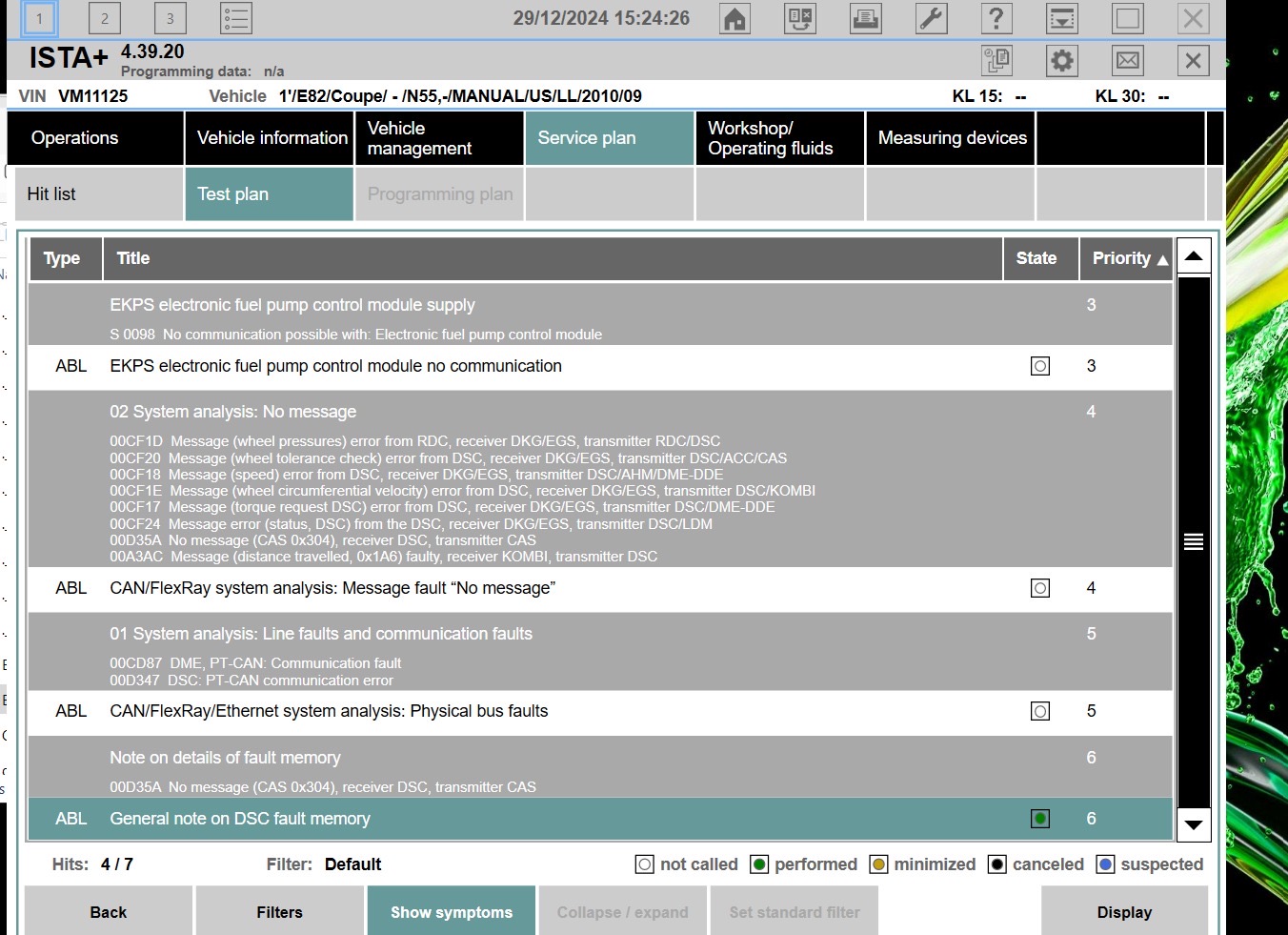

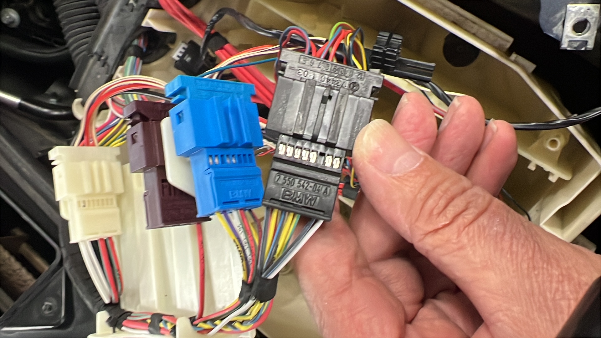

One other thing i did not mention in my original description was after replacing my "M" JBE with my original, the car ran fine on a round trip 1.5hr drive.
Two of my OBD pins have been very weird since I took ownership back in 2013. Two pins, that turned out to both be ground wires, were always bent in my OBD dongle. So, I ordered a new OBD connector and two new pins, and was able to replace everything. I did all of this after I did the 1.5hr drive. After the repair, the codes came back immediately on my initially test drive and my obd dongle no longer worked. So I reinspected my work and saw that I put the switched 12v pin in the wrong location. I fixed that without issue. Also, i unplugged a module right behind the OBD port to get a liitle more slack (is that the FRM module right there?) and it appeared I did not seat the plug correctly so I fixed that as well.
Unfortunately, codes are still there. I am also attaching a couple of pictures from ista showing the codes and what it recommends I troubleshoot first, which is the DSC. Please let me know if you have dealt with a similar issue or have any suggestions.
I should’ve also mentioned, the ekp error is normal. I have a bpm4 so their is no EKP.

Suggestions:
1) Use ISTA or INPA to view "Freeze Frame Data"/ Fault Details for any Fault Code that has "Voltage" FF Data. We're looking for any "Over-voltage" or system Voltage > 16.0V. That will "Scramble" bus communications between Modules. It often causes Wiper "Self-Activation". Restart usually restores proper function (momentarily).
Reply: I have grabbed multiple logs using MHD and the battery voltage always stays between 13.7 and 14.41. I have logs that are a couple of minutes long and there is never a spike. Is this sufficient to rule out the alternator?
2) You can use "Hidden Menu 9.00" to view System Voltage on the instrument cluster, or use Scan tool to display KL30 Battery Voltage or KL87 Main Relay voltage, while you drive, or while engine runs.
https://www.carsaddiction.com/articl...er-hidden-menu
3) Voltage Regulator brush failure/wear on rear of Alternator is most likely cause of Over-voltage.
4) There are other possible causes, particularly if issue began after shop connection to OBD II Socket. You can use ISTA to view wiring (SSP document) of "OBD" II Socket (just search OBD with filter for SSP only. Then examine/test OBD Socket for any obvious damage, particularly to the D-CAN sockets/wiring.
Reply: at the obd port, i found the CAN high and low pins and I get 60 ohms when I place a probe in each location at the same time. I believe that’s normal.
Everything points to a Bus Fault. Whether caused by Overvoltage, OBD II Socket damage, or other Bus wiring/connector fault is the question. I'm NOT an expert on Bus issues, or HOW to diagnose them. I would suggest seeing what ISTA says about Bus Diagnosis, & seeing if ISTA "Test Plan" can help diagnose any of those fault codes.
Reply: I believe it’s a wiring issue but not sure. I am hoping with help from the forum I can figure it out. It’s just weird it popped up out of the blue. My car has around 65k miles on it, is in socal, and doesn’t see rain.
I’m also unclear on the best way to test the wires. Do I get something like this?

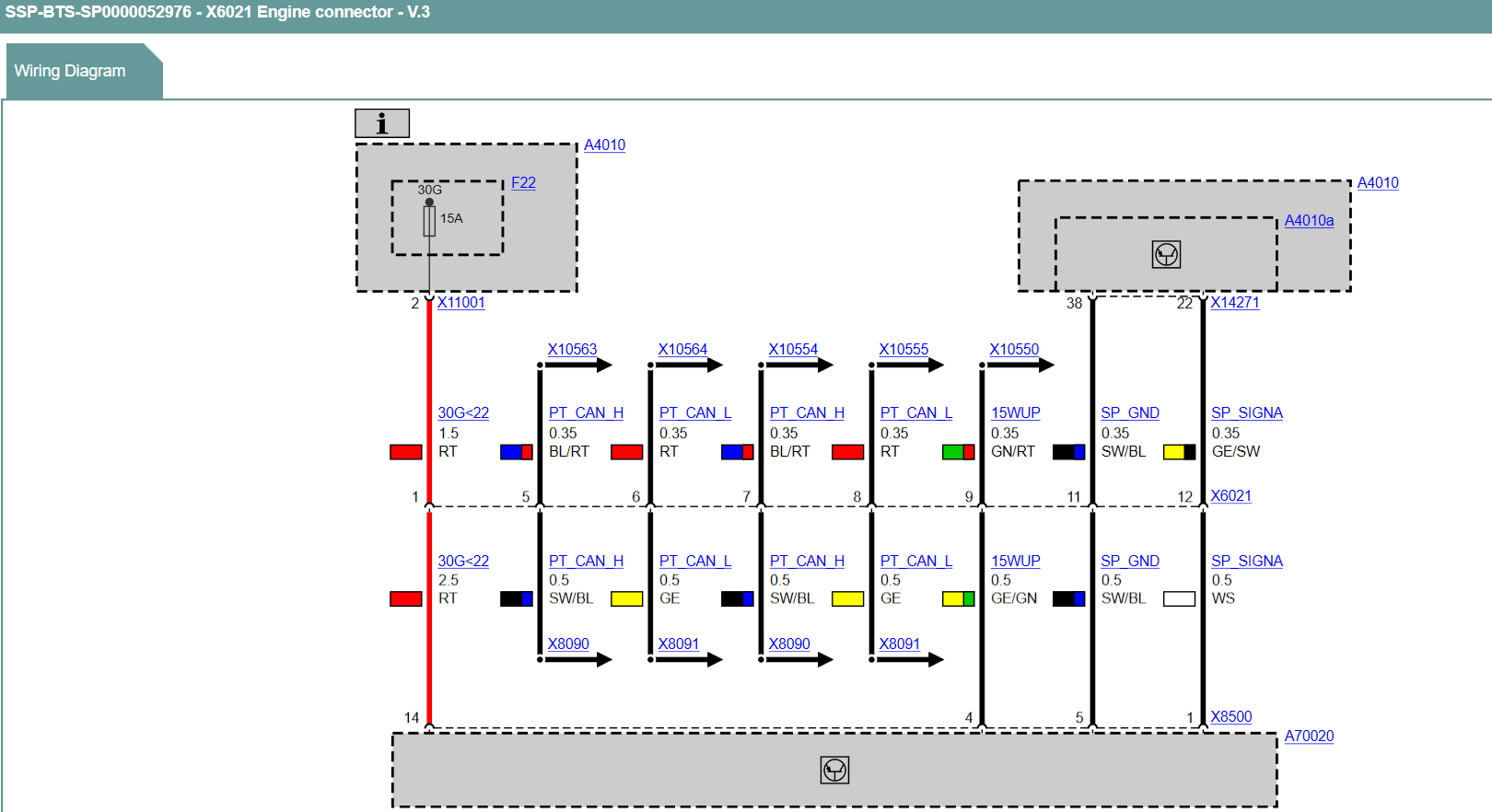

I have been studying this thread to learn how to troubleshoot my issue. One of the few threads that actually diagnoses an issue from start to finish. https://www.e90post.com/forums/showthread.php?t=2121740
I was able to pull the PT CAN wiring diagram using ISTA.
1. Do I test these wires at the connector for each module? Are the tests done with the connectors plugged in or removed from the module?
2. Am I looking for voltage, ohms, something else? One data point I can't find is the normal values for the tests. Is that information also in ISTA?
3. Do I need an oscilloscope?
In the meantime, I am going to get my car in the air and start removing panels to do visual inspections where possible. There is a location identified in the thread I linked which points to the wheel well that I want to look at just to rule it out.
I tested with the connectors detached and putting a tiny wire into the connector, my probes weren’t small enough to slide next to the wires themselves.
Checked for voltages to confirm power to modules and then ohms to confirm the pt-can loop didn’t have a break.
Since you’re seeing 60ohms at the OBD then the DSC and EKMS seem to both have solid wiring up to that. Each one has a 120ohm resistor, in parallel goes to 60ohm.
An oscilloscope would definitely help see if there is noise on the bus. Dont fully know how to use them so can’t advise on that.
houtan812.00

January 9 update
I was able to test a few things tonight and would greatly appreciate any feedback from JoshS98, gbalthrop, NZE90, or anyone else!
First, I removed the fuse for the windshield wipers since they were constantly on after my DSC programming fail. Please let me know if this will cause issues in my troubleshooting.
I decided to start at connector X6021 which is in the white “DME” box on the passenger side of the engine bay. Most of my codes are DSC signals to the DKG and this connector is between the DSC and DKG in the wiring diagram.
Voltages by pin number at X6021 are:
5, PT CAN H, 2.581
6, PT CAN L, 2.34
7, PT CAN H, 2.583
8, PT CAN L, 2.34
9, 15WUP, 11.06
10, no wire
11, SP GND (ground for switch), 18.5
12, SP SIGNA (signal, shift paddle, 5.45
Next I took ohms for the following pins at X6021:
5 / 6, 60 Ohms back probing with connector in place, 120 ohms when testing with connector removed
7 / 8, 60 Ohms back probing with connector in place, 120 ohms when testing with connector removed
Next I verified ohms on CAN H and L at the OBD connector using the attached picture. Anyone know how to find the OBD connector wiring diagram in ISTA? I am not using the correct search terms because I can’t find the diagram.
OBD Test result:
CAN H / CAN L ,60 Ohms
Then I tested voltage at the EKP connector:
9, PT CAN H, 2.62
16, PT CAN L, 2.39
I believe all the results are normal, right? Where would you go from here? Check the connector at the transmission?
Finally, what do the splices look like? Actual connectors or some sort of butt connector or something like the PT CAN clear covers (picture below)?
Thanks again for your help. Hopefully I am going in the right direction!

I got through a lot of troubleshooting so I am going to start updating the thread in logical chunks.
Using the PT CANBUS wiring diagram from ista, I located each module to verify ~60 ohms at each connector. All connections had 60ohms. The only connector I did not test at the actual connector was for the transmission. It was going to take a lot of work to get to and the wiring seemed intact. What I did instead is verified 60ohms and connector x6021, which has two sets of canbus wires going from it to the transmission. Then I checked for continuity between the CAN HI and LOW wires going to the transmission and both checked out. So I called it good for now.
Now that it seemed like my wiring was good, i decided the next step was to or a Pico 2204a oscilloscope. While I waited for that to get delivered, i decided to try and flash my DSC again. It felt like the BMW gods were with me that night, because the flash worked! I was really confused because I didnt do anything to fix the error. Just to see what happens, i decided to put all my connections back to each module and start up the car crossing my fingers somehow the car is fixed. But nope, code came back after 5 or so minutes.
Next post i will share my testing with the pico 2204a.
I am also attaching a picture of x6021 and the CANBUS wires that go to the transmission.

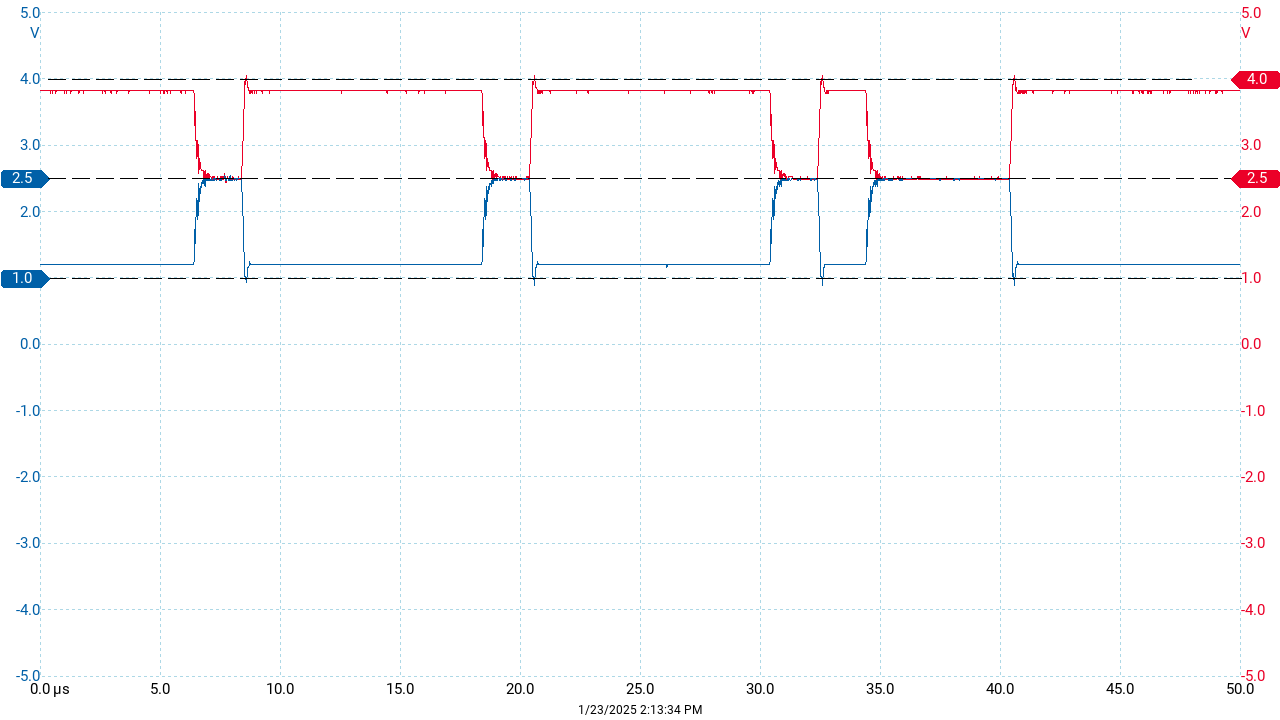

After verifying my wiring appeared to be good, I decided to purchase a pico 2204a oscilloscope to continue my diagnosis. I had never used an oscilloscope before so I watched a lot of youtube videos to learn how to use one and also what to look for.
I connected the leads to the can H and L wires under the white dme box. Once i opened the sw and saw the waveforms it was clear something was causing an issue on the PT can network. The first picture below will be a snapshot of what i was seeing.
From there i decided to start unplugging modules, and the first one i removed was my BPM4 (my aftermarket ekp). once removed I walked over to my computer screen and bingo, my PT can network signals looked normal again! Wow. i was very surprised to say the least that my robust ekp upgrade was causing the issue. PT can H and L should start at 2.5v, from there H should go up to around 4v or less, L should go towards 1.0V or less., and they should mirror each other. What was almost impossible for me to figure out with just a voltmeter is I was seeing 60ohms over the canbus wires at the BPM4, which meant it was functioning. But the oscilloscope showed me the truth! haha.
I tested the ekp a few times. sometimes it seemed to cause PT Can bus issues immediately, sometimes it took four or 5 minutes. This behavior definitely had me second guessing if it was actually the real issue. But it was the only thing that made sense (in my head at least).
Thankfully, Torqbyte, the company that created the bpm4 and sold the circuitry to EOS, was very responsive. I worked with a gentlemen named Kev, and based on my oscilloscope results, he thought it was probably the BPM4. But not 100%. So I sent the BPM4 to torqbyte so they can investigate.
Torqbytes initial check showed the resistor was working. But a few days later I received another email from Kev saying the engineers were able to find the resistor had a bad or poor solder connection that was
causing an intermittent issue! The resistor was soldered by EOS during assembly of their version of the BPM4, and it was not done correctly. Whew, boy was i relieved.
The PT can bus terminates with a 120 ohm resistor at two locations, the DSC and the EKP (or BPM4 in my case). The intermittent connection on the BPM4 side was causing all of the issues on the entire network.
The BPM4 should be back in the mail today and in my hands by the end of the week hopefully. I still have a lot of coding to add back in that I had to remove during my testing, but I am looking forward to getting my car back on the road.
Also, I realized why I was able to reflash my DSC, which I mentioned in my prior post. My guess is the BPM's intermittent connection was working for the time period it took to reflash in winkfp, and I just got lucky.
First picture is PT Can bus with BPM4 connected. Second is with it disconnected.
