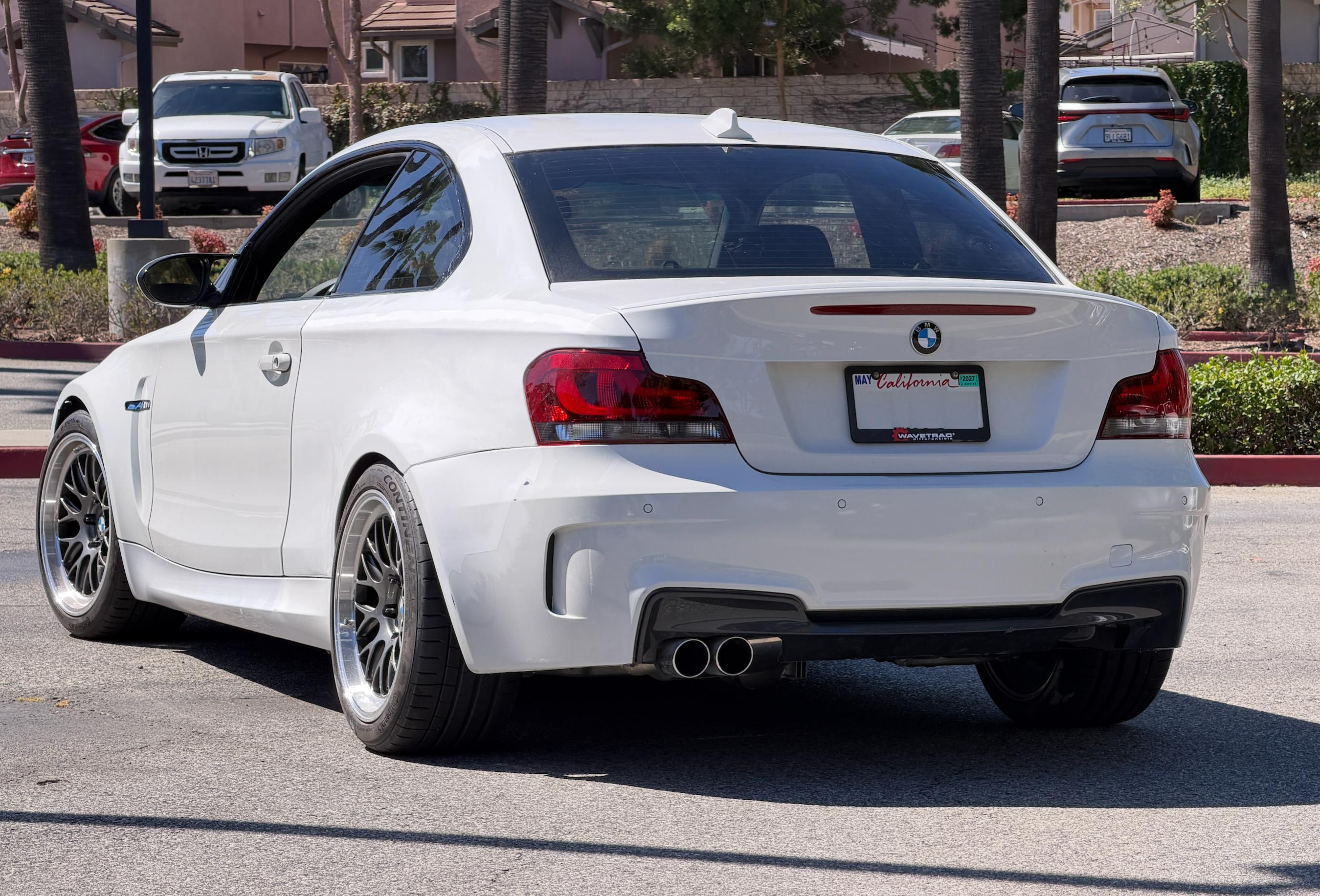

The rear bumper fitment was hard and I still don't have it perfect. On my flares there was some stamped ridge that I think needs to get flattened out. Just my hunch so take it with a grain of salt. I ended up pushing the bumper guides as high as possible to squeeze down a gap between flare and rear bumper. Thinking of ordering the larger skin from ex-pressed so I can get another go (now that I have some experience). But I'll sport this work for a while (my paint job is a little shitty so will do some touch ups there, maybe get a pro paint job done after the 2nd attempt). Also, I did a half ass job on the inner wheel well work mostly just not understanding the geometry, so if I re-do this I'm going OP's route. That structural inner wheel well piece I was mentioning in an earlier comment, you gotta cut out because it will just not let you fit the 1M inner wheel well lining properly; ended up making cuts of the lining just to get it to mount and bolt on. Finally, probably common sense, but you really gotta get that butt weld down as level as you can and minimize filler work, damn what a bitch to get filler done perfect. Even when it feels perfect, if you are new to doing filler work it wont look perfect after the gloss coat.. I ended scuffing it down and doing it again and it was better but not like pro better which one would expect with a nice 1M conversion. Still need to find those damn side indicator lights too LOL, although I have the passenger side one on only right now LOL (those are the absolute hardest things to find right now for a 1M conversion).

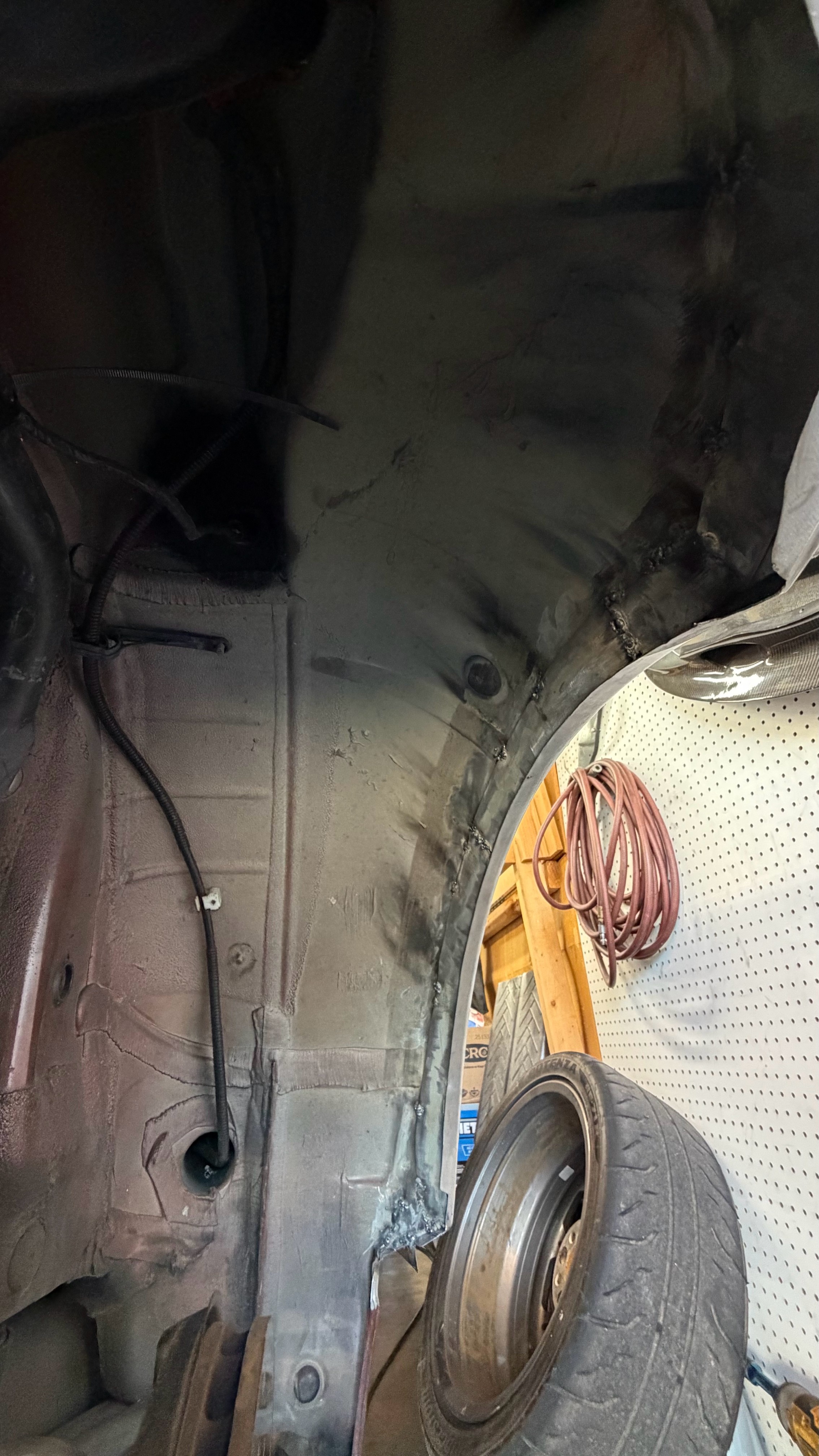

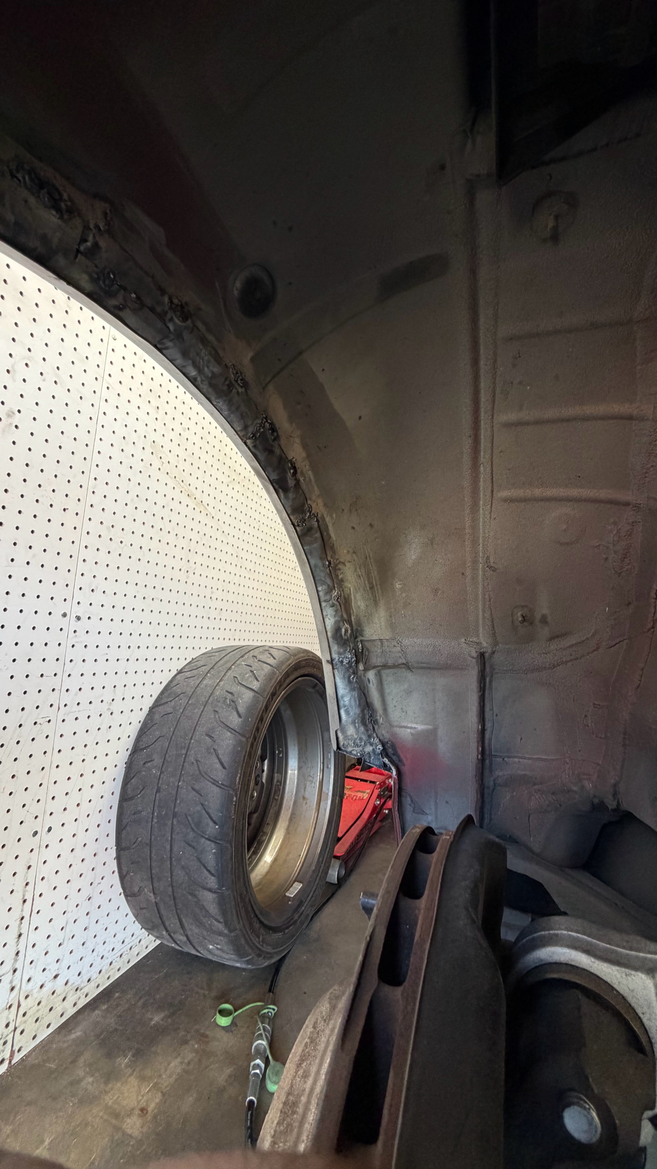

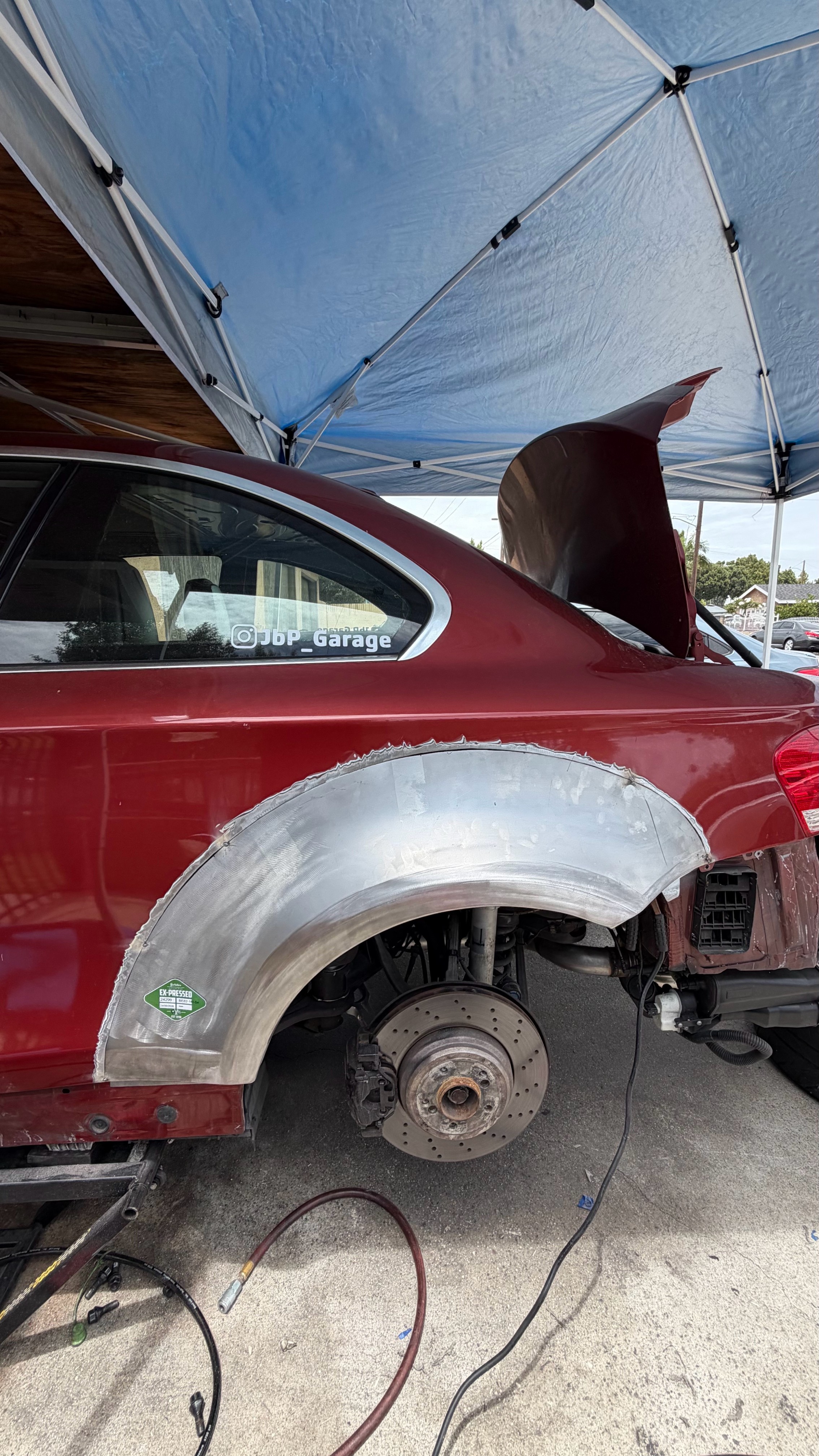

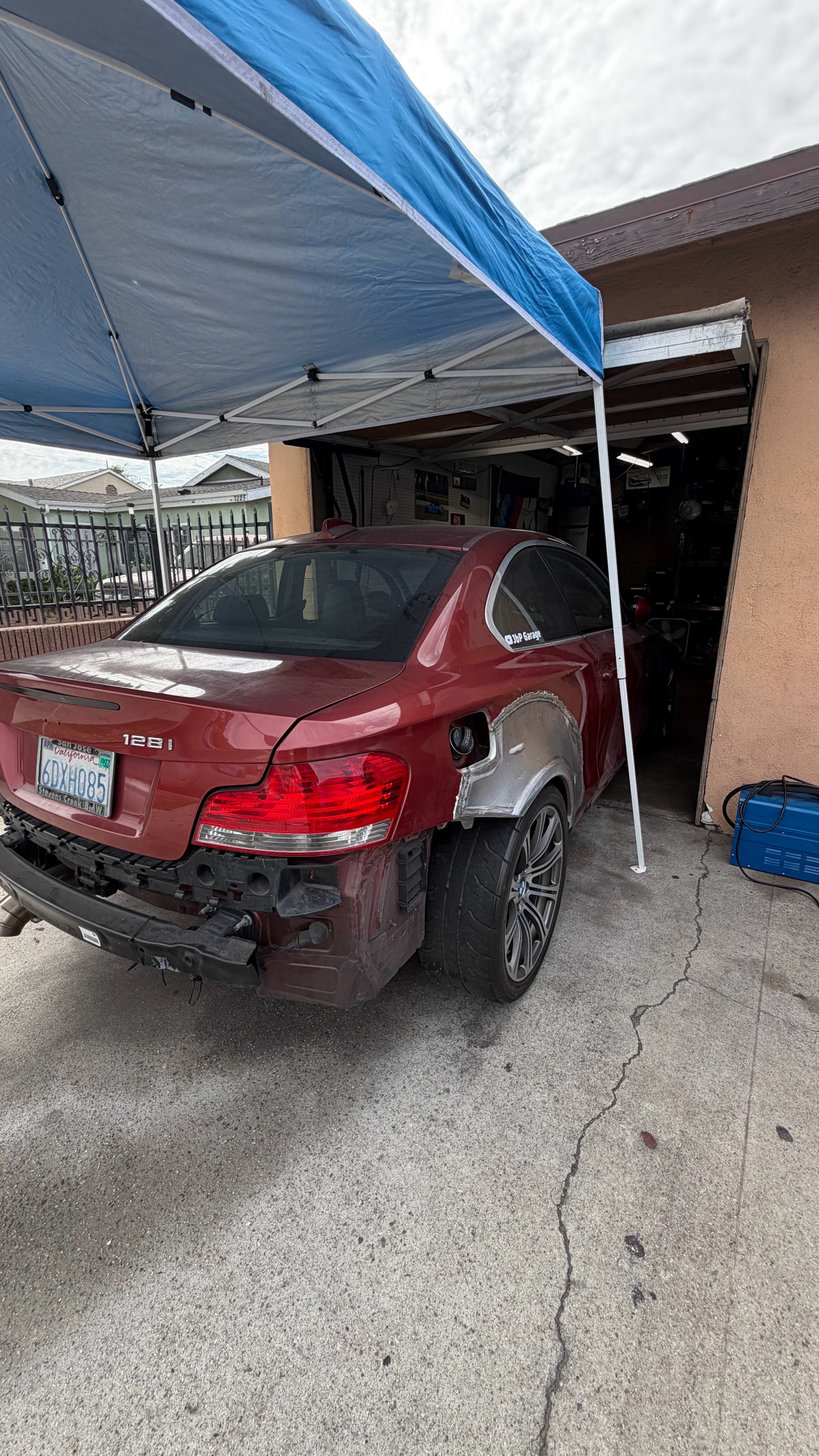

kashikoi thanks for the information. I am too inpatient, so I ended up starting the job. You really need to have a lot of patience for this job. I went a slightly different route with the inner fenders. Your car looks great!
