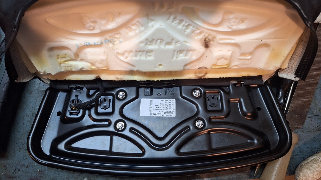

First, go order this part number from the least expensive place that doesn't scare your credit card: 52107161311
(when I ordered, ECS had em for $86.60)
Remove the old busted stuff:

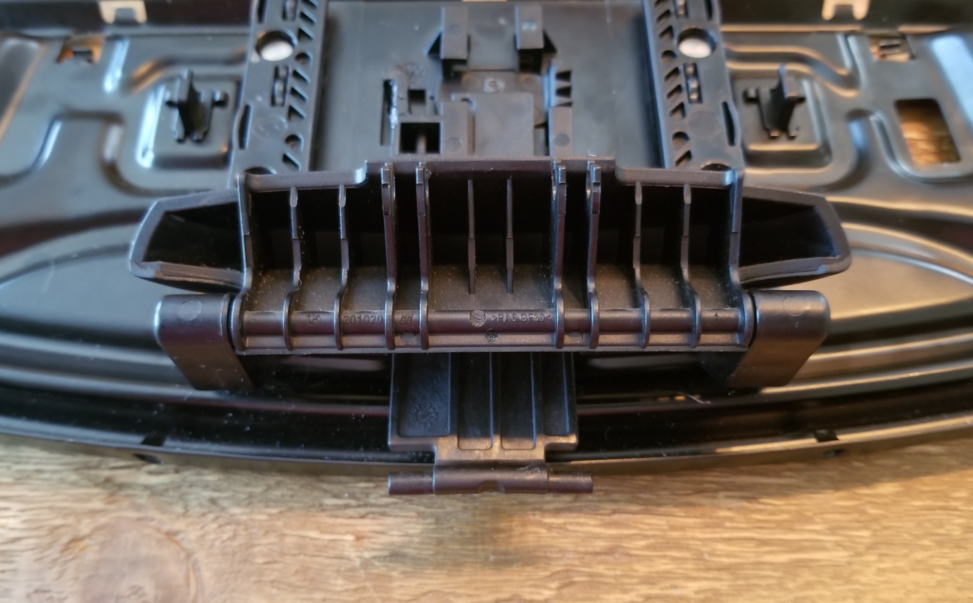

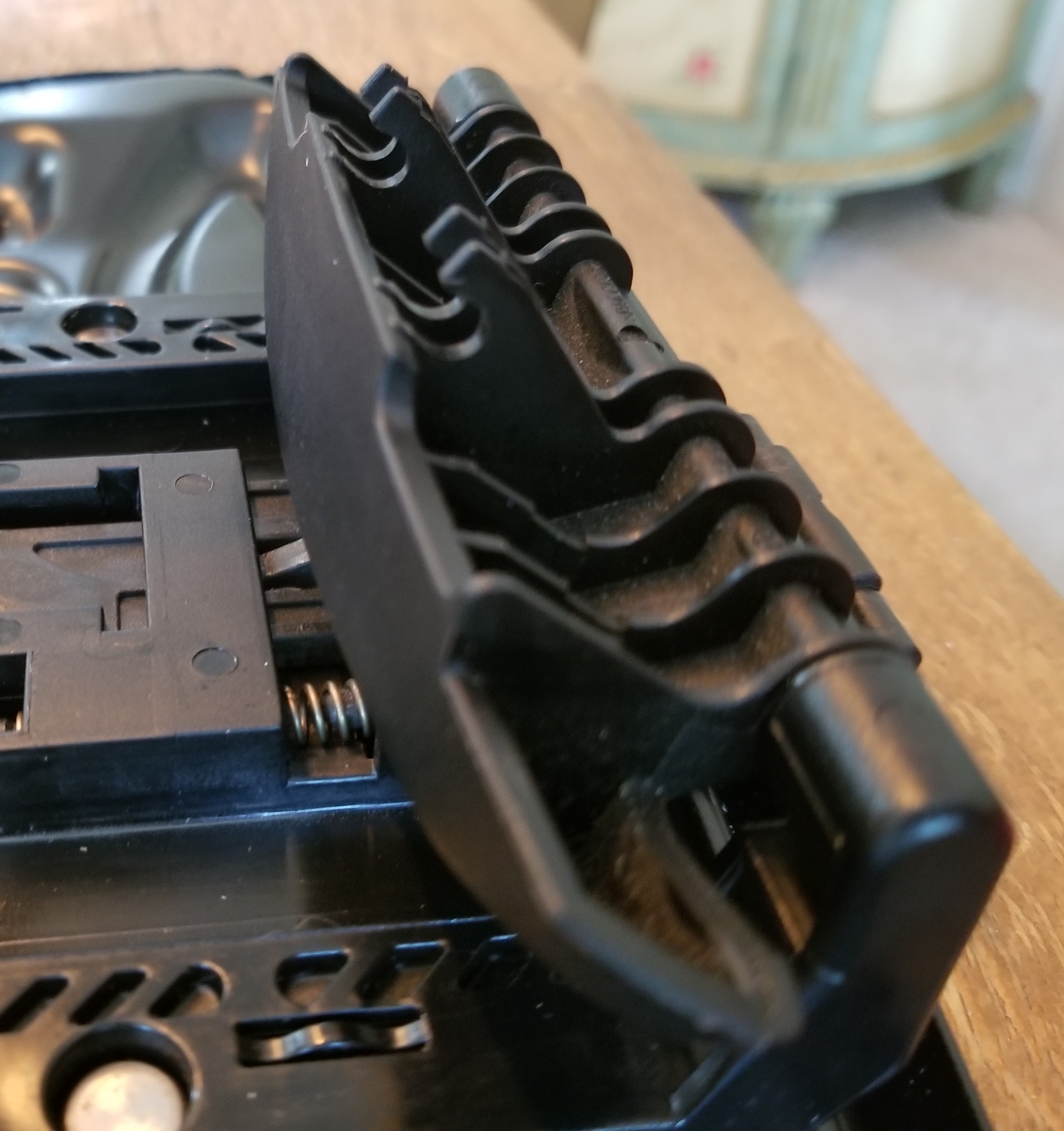

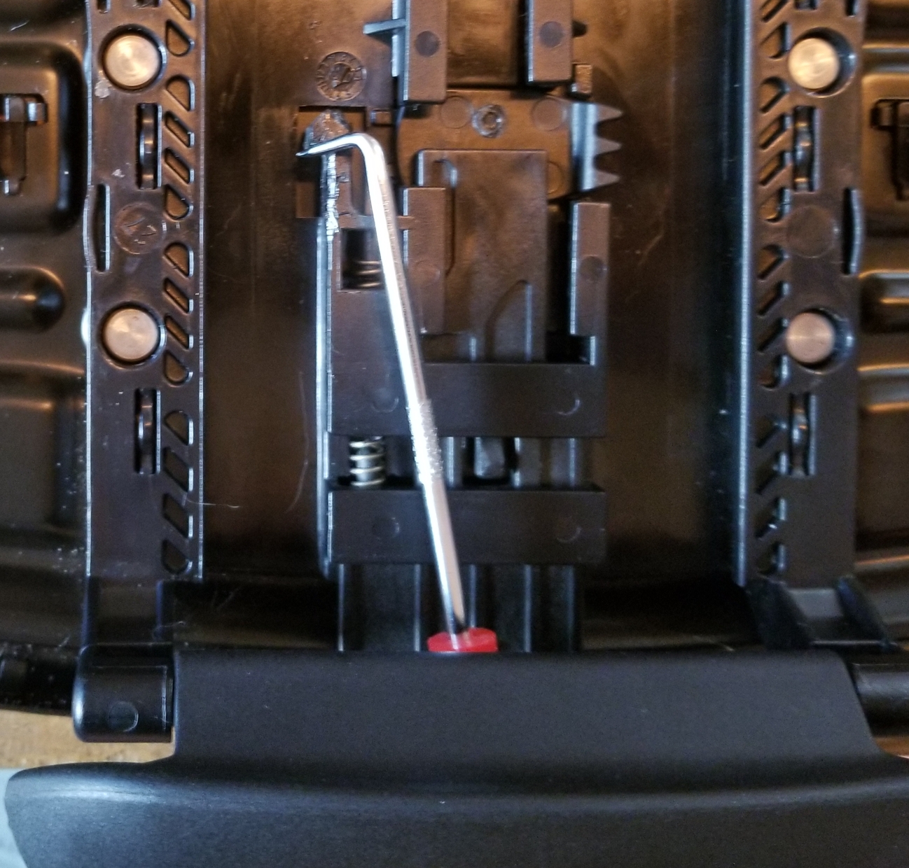

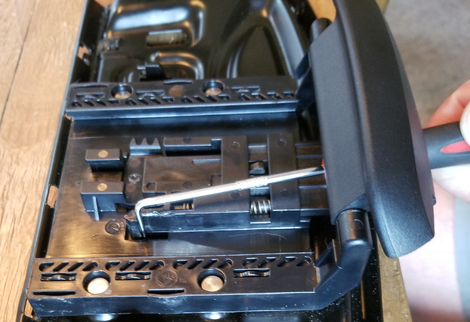

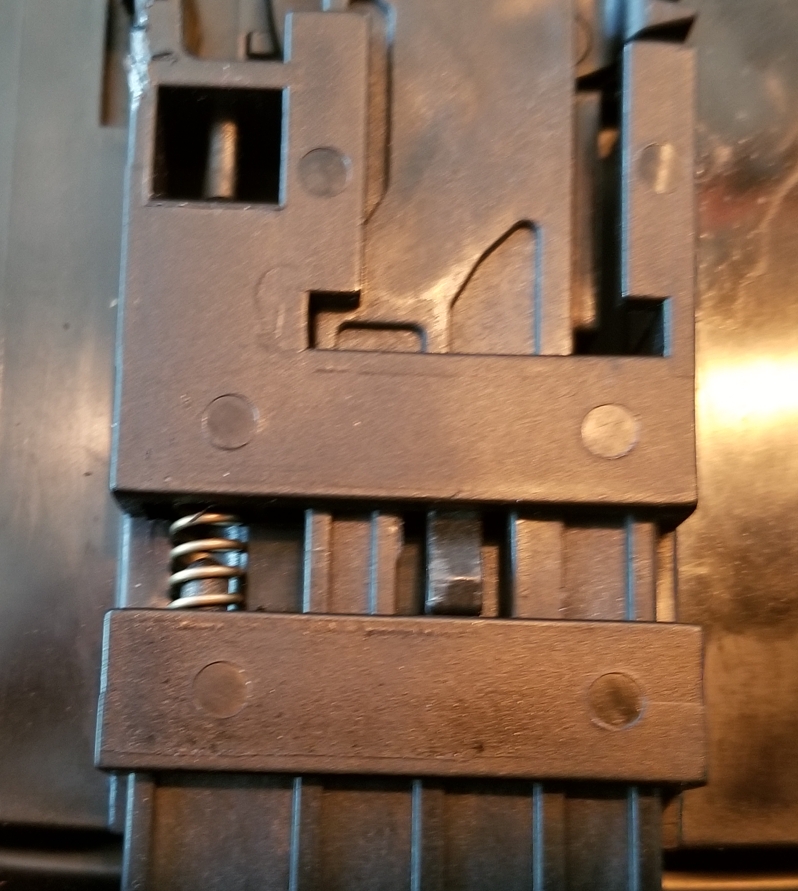

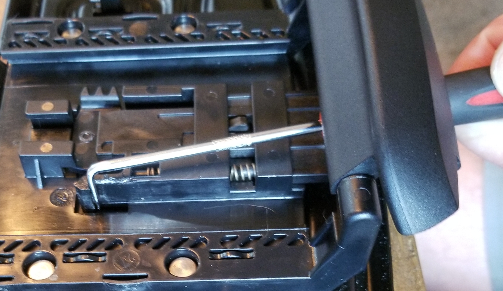

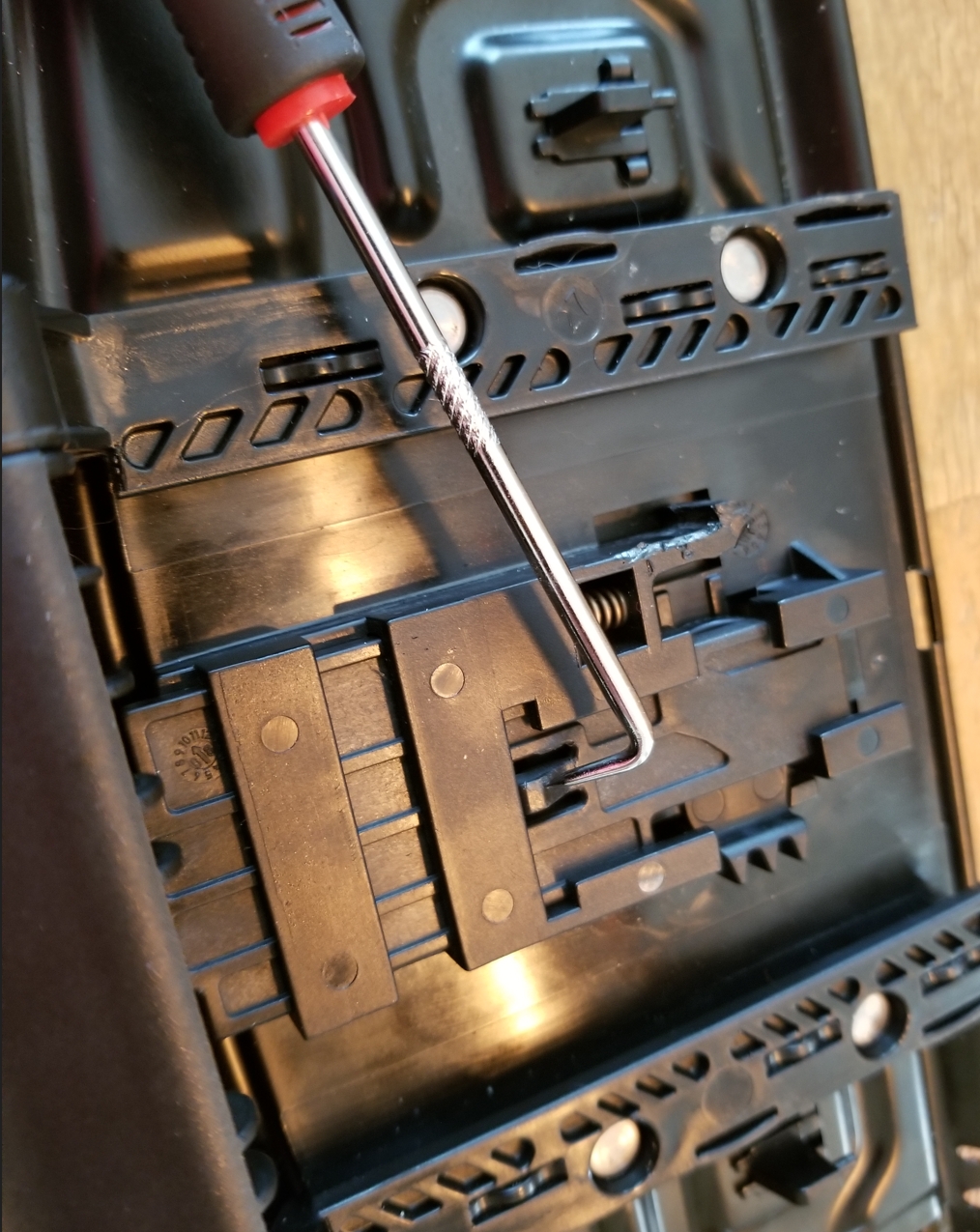

-SHORT VERSION: What you're looking at: This is the BOTTOM of the drivers side (US/Left) thigh bolster. You want to move that hook and then push the bolster forward off the guide rails:
-Leave the seat in the car, but if you can't locate the release clip plan on disconnecting the air bag connector and pulling the seat out of the car so you can get a better angle on what you're doing
-release the thigh bolster to it's full extended position
-locate the release tab, push it up and pull the bolster forward to the service notch
-pop the release handle off of the retention mechanism you need to reach over the handle to access the retention hook, it'll just pop off the pins
-using a suitable hook tool reach in over the handle into the gap between the release handle and the bolster itself, and with pressure against the hook pop the thigh bolster forward/off with your other hand
((Alas, no more pics from here, but if you've made it this far you're overqualified for the rest :P ))
-disconnect the seat heater plug if you have one
-remove the seating surface, is mostly just plastic guides tucked into very small metal tabs around the outside edge of the bolster and the flap from the seat over to the bolster
-move the cover, padding & heating element over to the new replacement frame
-reinstall all the bits
below are just the attached photos so they don't get lost hopefully

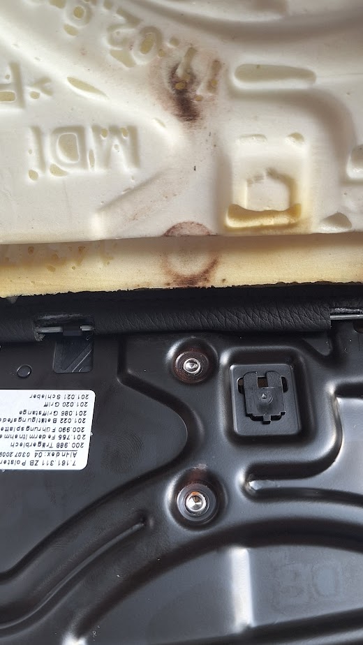

This has been useful for me to diagnose and fix my sport seat thigh bolster. It was making this annoying creaking sound every time I pressed the clutch pedal.
It turned out that the rivets holding the plastic frame to the metal base of the thigh piece were worn out.
The creaking can't be heard thru the picture but the rust can be noticed on the foam opposite to the rivets.
Once discovered it was a matter of drilling and punching the rivets out, then replacing with bolts, washers and nyloc nuts.
