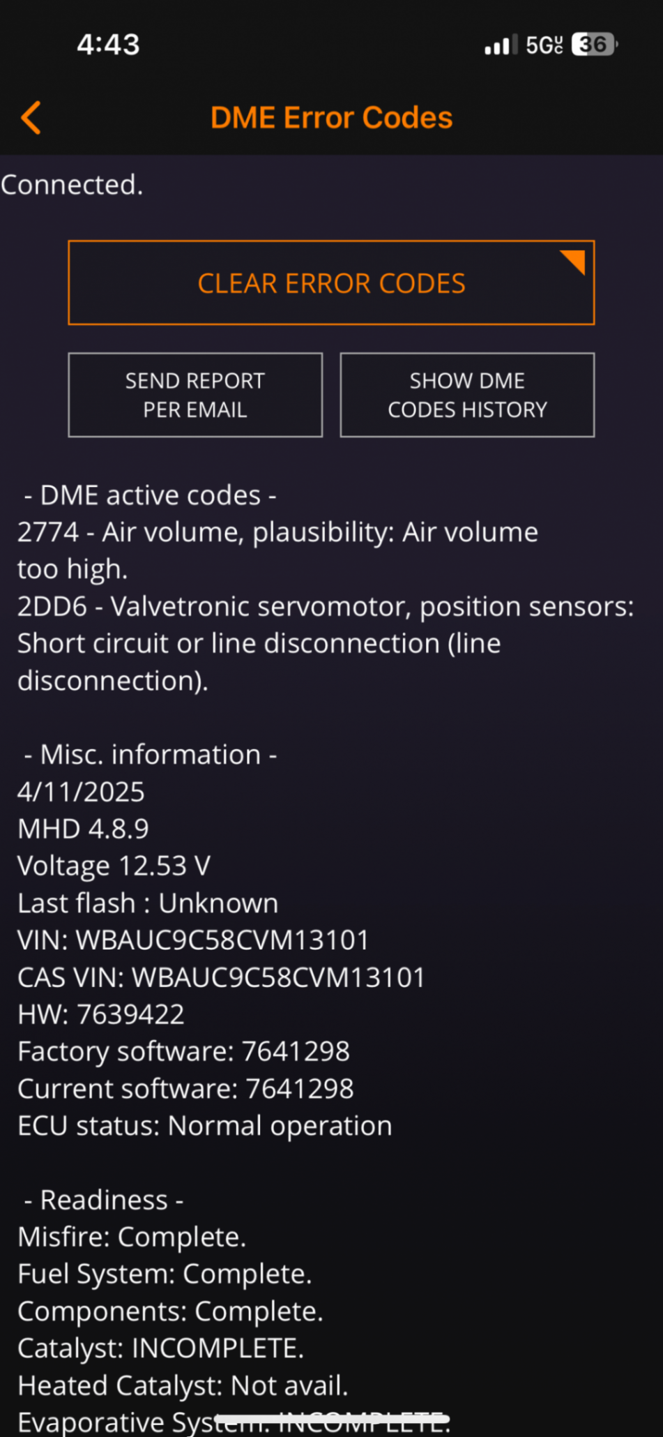

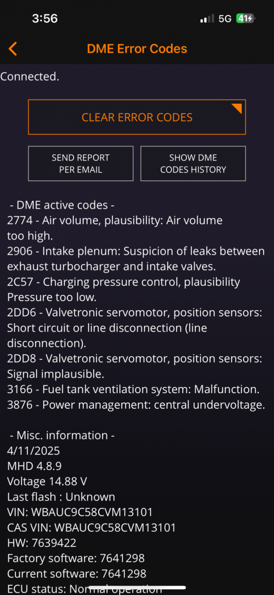

So I installed a charge pipe and got a bunch of codes. I was curious if anyone knew what I should try out to fix them. I am going to spray soap and water to see if it is a boost leak causing these problems.

Hmm this was a while ago but im fairly sure it was a boost leak causing this/it sucking in air after my maf sensor.

My charge pipe came with a missing bung plug on the underside. Went to Autozone for a $5 fix.
