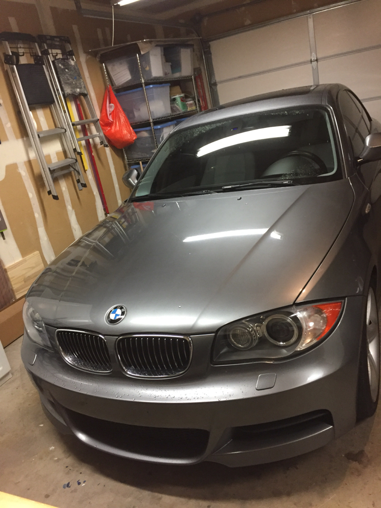

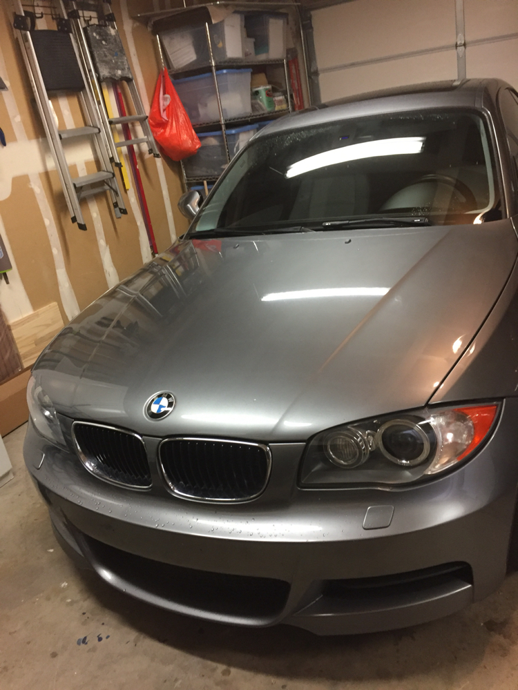

      08-03-2023, 04:43 PM   #301
schernov
101
343
Drives: 2018 340zhp, 2009 135i
Join Date: Nov 2006
Location: chicago,il
Just installed these. For me easiest way was to undo 4 bumper cover retaining bolts on top and using a long flat screw driver to push three top tabs and one side tab. And they came out easy.
I failed using a pick tool trying to release bottom ones as the first go around.
