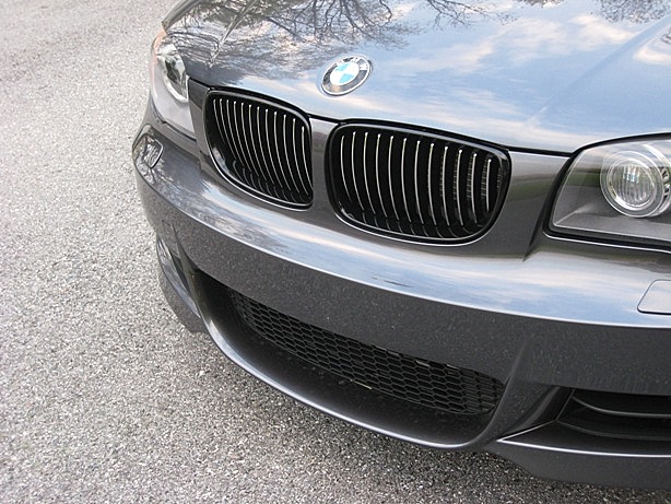

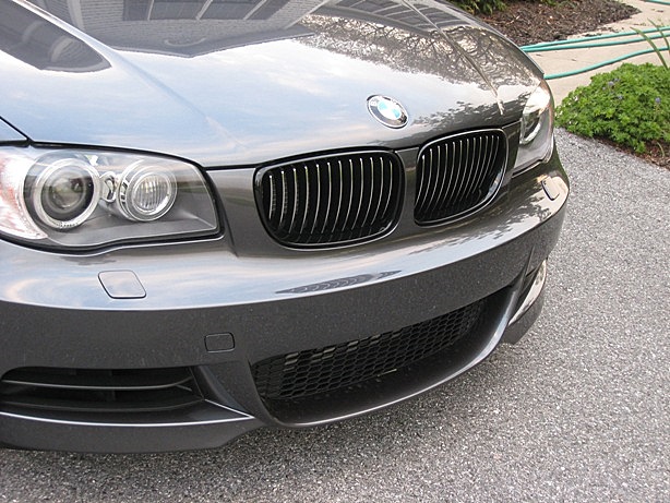

Just playin around...I switched mine yestersday to the Shadowline perimeter with the OEM chrome tipped interior slats.
It presents a nice combination....not a completely "blacked-out" look and eliminates the big chrome frame.
Do you have a picture? This is the one combo I haven't seen.
Your wish is my command...........Shadowline frames with OEM interior grille bars.
