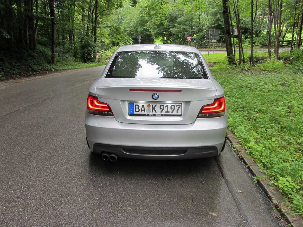

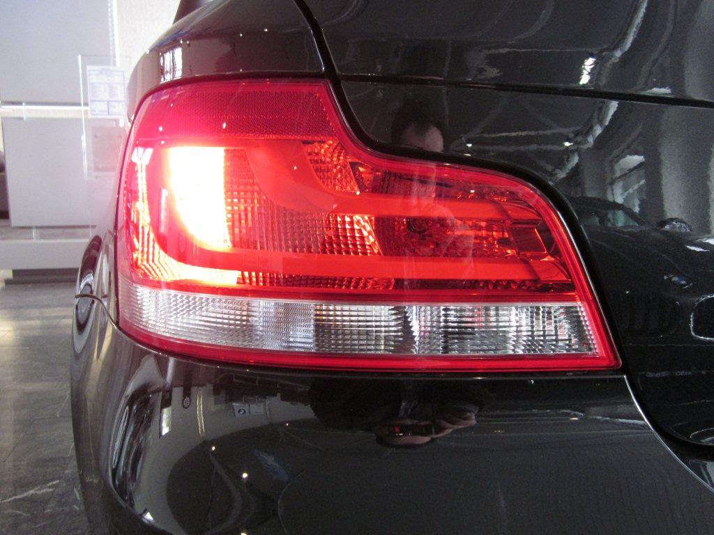

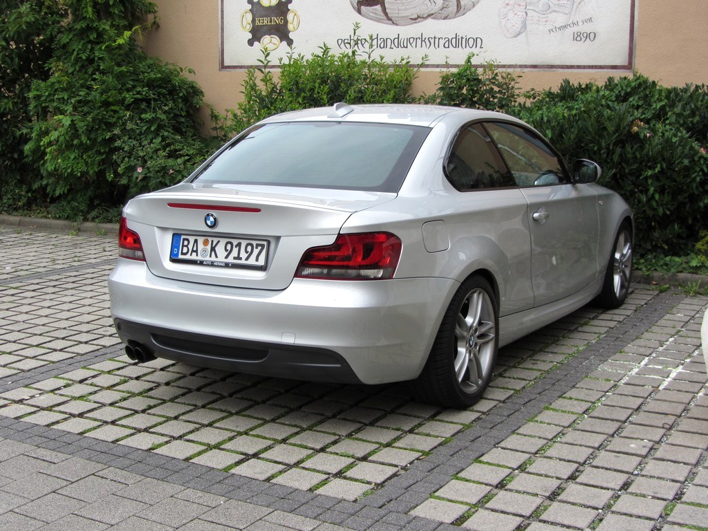

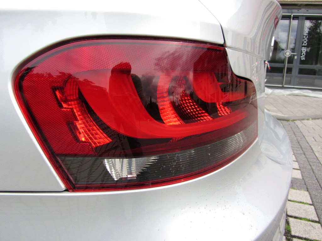

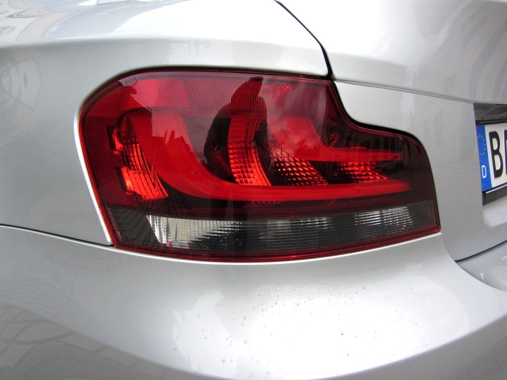

Halogen LCI tail lights
Name:  lci halogen tail lights  IMG_6730.jpg

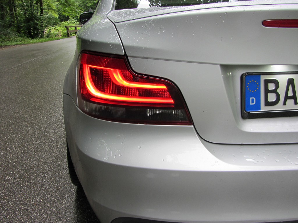

LCI Blacklines...
Name:  lci blacklines halogens  brake lights.jpg

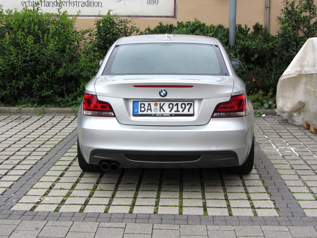

Blacklines(L) vs pre lci led tails(R)
Name:  lci blacklines 5 (1).jpg
Name:  lci blacklines vs pre lci on right IMG_0215.jpg

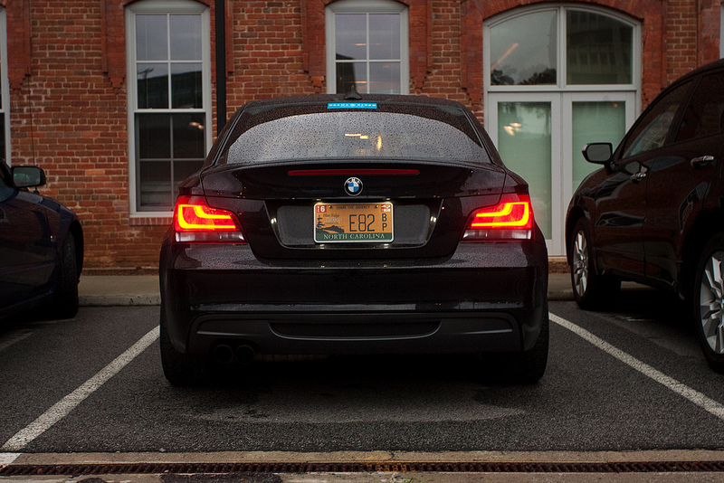

Blacklines for xenons
Name:  Blacklines 7199742272_ddce28dd38_c.jpg

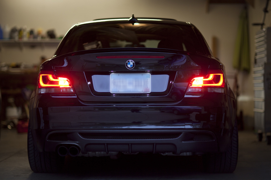

Blacklines for xenons (my car)
Attachment 2144533
LCI Blacklines...
Attachment 2144536
Attachment 2144537
Attachment 2144538
Attachment 2144539
Attachment 2144540

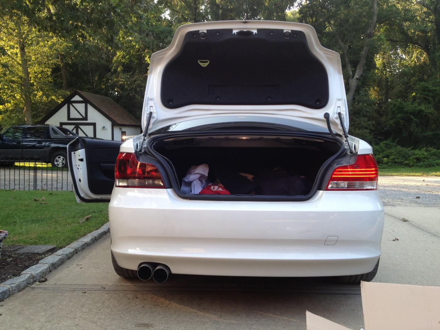

These are my harness set ups as well as the pin set up on my headlights
On the final shot of the rear of my vehicle the stock tail light is on the left with the Blackline being the one on the right.
Attachment 2144533
LCI Blacklines...
Attachment 2144536
Attachment 2144537
Attachment 2144538
Attachment 2144539
Attachment 2144540
