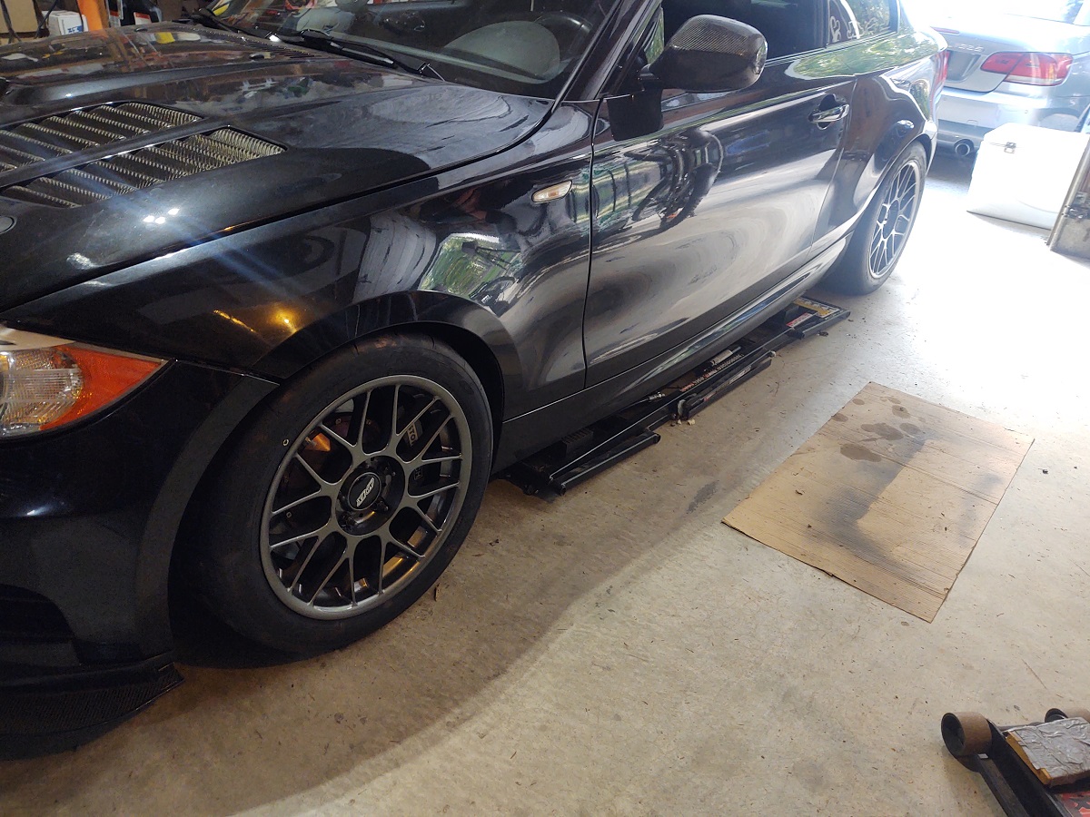

They arrived and are installed! And they definitely clear the ST-60 and ST-40 BBK's. Not the best pic but I am really liking how these fit and look and the NT01's appear very aggressive, even compared to the RE-71R's. I like em so much I am keeping the Apex "free advertising" wheel caps on even though I normally only do BMW wheel caps. This was a killer deal on a great set of wheels. Appreciate Apex directly supporting our baby bimmer track cars. Can't wait to try it all out on the 18th!
For those wondering, it's 45# a corner. That's 5# lighter per wheel than my 18" stock wheels with Continentals and I imagine over 10# per wheel lighter than my type 135 wheels with Toyo R1R's (they are out of the house getting mounted and balanced right now, will weigh when I get them back). UPDATE. Confirmed. My type 135 track wheels and tires are 56# (!!). So I've now saved 44# of unsprung weight.
Best,
Andy

AndyW, looking good. What size tires did you end up going with and spacers?

255/40/17 and 12mm. Wheels are 17x9 ET52 so net ET40 in front. These were offered as a package by Apex. My other wheels/tires combo I have been using for several years are 255/35/18 with a 10mm spacer. They are 18x8.5 ET50. so same net ET40 up front. They will now become my "wet day" wheels with Toyo R1Rs. These will be my "dry day" tires. There is a bit more room in the wheel well with these. My wife noted almost immediately that it will be easier to ratchet strap it down in the trailer due to the extra space above the tire... She is not a fan of ratcheting the car down.

Thanks Andy. Interesting there’s more space. I would think the diameter is similar. You think it’s the tire brand that is freeing up space?
So I have the. 18 x 8.5 et45 arc 8s. Currently on what many would call dragster skinnies at 235/40s. Based on your now wet set up, I can run a 255/35 on an 8.5” wheel, and with a 5mm spacer, get to et40 to make it all fit. Assuming I have similar clearance to my strut.
I just finished doing my home alignment last night that put me at 3.5 degrees camber, zero toe so I think the camber should be enough.
maxslug , I am running TC kline camber plates and their single action front struts. With a shaven down Komi adjuster to allow me to get the strut inward as far as possible and still allow adjustments, I can get to 3.5 degrees of camber. Also have m3 control arms.
Maybe. I'll let you know if it's an optical illusion or not when we put it in the trailer.
UPDATE: It must be the tire! Math says they are essentially identical, just as you said. https://www.tacomaworld.com/tirecalc...5r18-255-40r17
