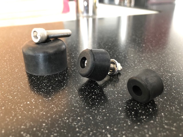

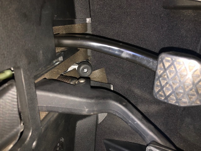

Yesterday got the ER Chargepipe re-aligned so it sits firmly in the throttle body. Initial install was off a bit.

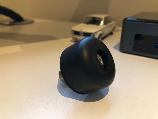

Later, went to install the BMS Clutch Stop with 2 washers. Not only was it a pain to get in, but in the process bent the stem a bit and the soft foam was a little damaged when pushing in. This led me to another idea.
Got these rubber stops at a local shop - figuring I could fine tune the width of the stop without having to painfully install the plastic BMS Clutch stop multiple times.
While the largest one - at 15cm - felt the best, it didn't allow the car to start. The middle one did but the bolt is only an M4 and not sure it will withstand abuse over time.
The large rubber mount bolt is an M6 which I prefer so I'll need to slice the rubber down a bit. I like the way the clutch pedal hits the stop - very reassuring thud - feels solid when pushed to the end. The middle sized one also felt really good just that it being an M4 I'd rather go with a larger bolt.
It's also a real pain to work at that angle.

The clutch stop is holding up so far. Easier to get to the bite point. Getting the bolt in at that angle, stretching upside down and tightening the bolt was a real pain - hope I can get it out if I decide to.

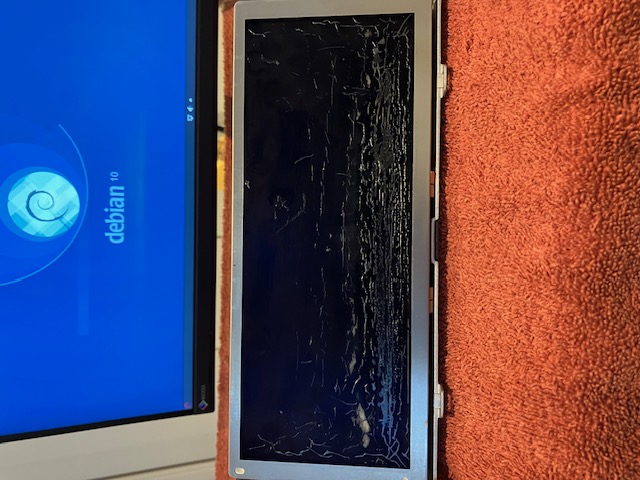

It's been a while but have started back up on restoring the 135. Have been busy with work and the Real-estate business in Yokosuka and Okinawa. Haven't driven much but just finished the legal road inspection. Changed the OFHG during inspection and need to do brakes shortly.
Have been focusing on the interior parts which were long overdue including the NAV screen, AC vents and door sills.

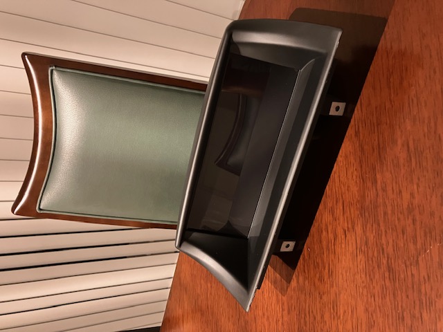

Re the NAV screen - post research decided I didn't want to 'upgrade' to car play etc and wanted to keep the standard look. Changing the unit at BMW is a no go obviously given the thousands they'd just charge. Saw a guy on youtube purchase a Sanyo LCD screen for about $120 so thought I'd go that route. Then found another video with a guy using Novus plastic restorer which basically just removes the anti-glare film. Thought I'd give it a shot and if I ruined it, I can but a new screen.
Mine was in bad shape and progressively got worse since I purchased last year. The coating has been corroding/wrinkling and even hitting it with the Novus 3 heavy, the stuff would not come off. Resorted to using my nails manually to strip it all off - very tedious, but in the end was able to get it removed up to the edges and polish it up.
Problem was the edges still had the remanants of film you could make out looking at the top of the screen which bugged me. I decided to buy some very thin rubber strips, cut them and align them about 1mm on the top and bottom edges. I think it turned out ok.

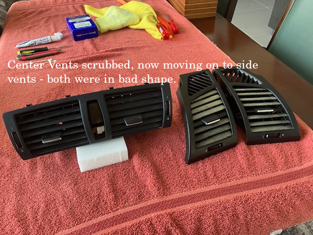

While I had the center air vent out, figured I'd go ahead and attack that too. I was originally planning to buy new vents but realized the issue is that BMW used some sort of UV coating or something that will eventually yellow and brown with age. It's a universal problem with our cars.
Currently trying to get this crud off. What the heck is this stuff? A real pain to get off.

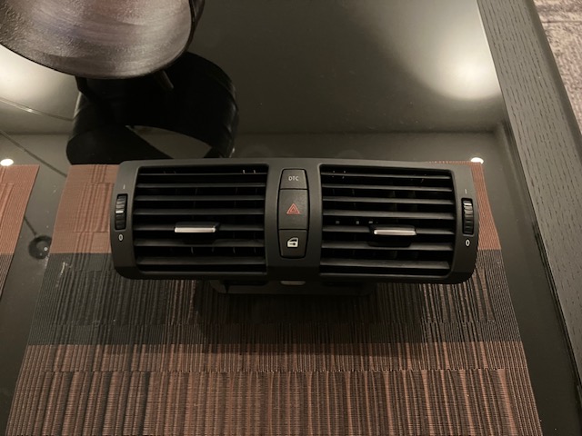

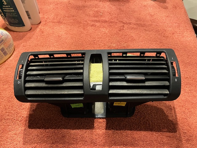

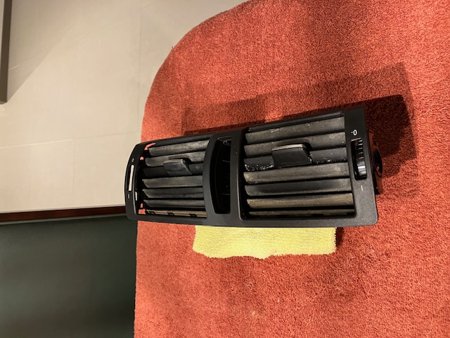

Ok, so got the vents cleaned up. Took way longer then expected. Initial plan was to remove the fins and scrub off as much of the gunk as possible then sand and paint if needed. Given the brittle 13 year-old plastic, I risked cracking the frame and fin guides if I disassembled so decided to just do it in place.
Thought I was making good progress at first seeing a lot of the brown come off with a toothbrush, magic eraser type sponge and some Oxyclean with a first pass under running water. But, as soon as the water dried off, it was like nothing happened and the gunk was still on pretty good. So the process was scrub, dry, inspect, scrub again - took about eight rounds to get it in decent shape to where the fins look matte black.
Whatever stuff BMW used on these vents is a real pain - not only do you have to get it off the fins, but the water residue leaves brown remnants on other parts of plastic making the mess even bigger. I got to the point where it was good enough before hitting it with some polish but honestly, could not get it all off 100%.
The Center Vents cleaned up the best with the side vents surprisingly taking more effort. I used Novus plastic cleaner for the center and Sonax trim restorer for the side vents as the Novus didn't blacken them enough.
Placed them back in the car this morning. Results are ok - we'll see how long it holds up. At least this was one fix where buying new vents just doesn't make sense given the material that is on them or made with them as it will brown over time.
