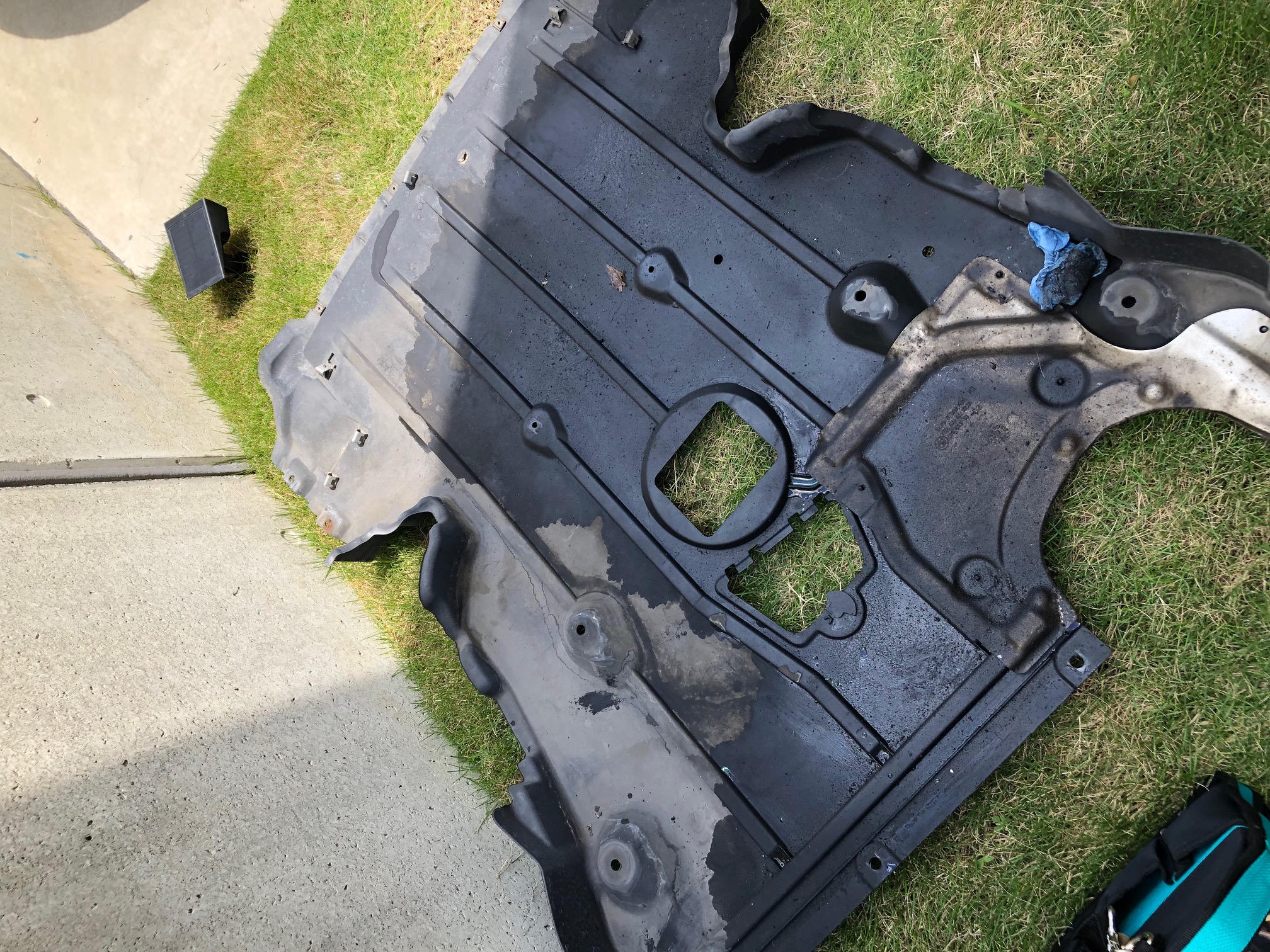

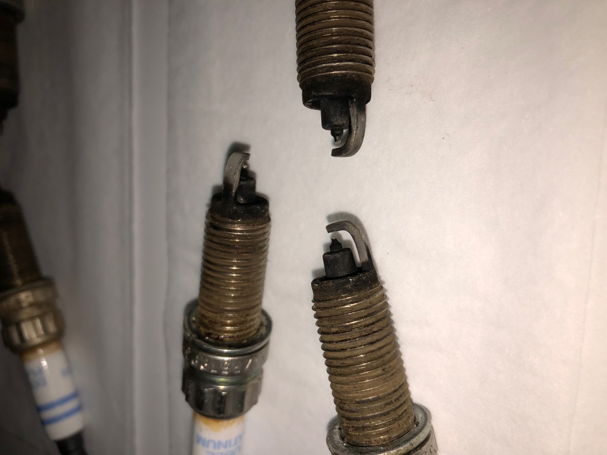

Wonderful weather this weekend and I had planned to replace the spark plugs+coils and lubricate the gear shifter.
As usual, leading up to the weekend, checked all the videos for spark plug replacement on the N55. There are a lot of good ones out there especially the one with Gareth from FCP.
Although coils and plugs arrived on time, needed a few more parts to prep so decided to kill the plans until I had everything. Most notably, that plastic vent hose pipe that cracks when you look at it, and not having a spare E Torx strut mount bracket bolt. I later figured out it's a one-time use bolt. Ordered everything from FCP so will tackle this later soon.
On the vent hose, Real OEM lists 2 parts - one with and one without the blow-by heater and I have no idea which one I've got. I think I ordered the right one as I can make out part numbers stamped on the plastic hose currently mounted which shows '7584 128' so figured that means part# 1112 7584 128 as listed in Real OEM.
Not letting the day go to waste, went ahead and opened up the shifter to see what was up. Old grease gummed up - no wonder it wasn't feeling great. Cleaned and got it lubed with silicone grease along with portions of the linkages of what I could access. Much smoother now. Also managed to pull off the stock knob without breaking anything thank goodness.
Now looking forward to the ZHP knob which I've wanted for a while and will mount and drive once it arrives. Also got the Burger Clutch Stop from ECS on the way - heard that does wonders in getting rid of the extra play.
So, all in all, not a wasted weekend. Topped it off with a nice Tempura and Soba dinner!

Ok so, re spark plugs - I ordered the ZR5TPP33 but understand that there have been reports of misfires etc if you don't use ZR5TPP33-S. (circa 2017~2019)
I've also read that ZR5TPP33-S is now discontinued and ZR5TPP33 supersedes it but not sure if that happened recently like 2020~2021.
The ZR5TPP33 I'm planning to install are the 'Double Platinum' of course, without the BMW stamp.
I guess I'm still planning to do it this weekend. I don't have any engine problems at all - just refreshing.
views?

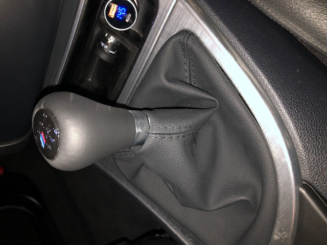

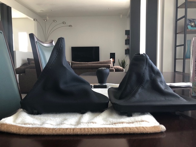

Work has been busy but the main crux to progress has been the shift boot. Believe it or not, it's damn near impossible to find a right hand drive shift boot replacement.
The original leather boot doesn't have enough material to make the 'crater' fold butt up against the new ZHP knob and left too much of a gap. Since I want to leave the original unit in tact needed something with a second plastic frame. Literally crawled all the usual places - no dice. Ended up purchasing a generic faux leather shift boot with enough length to wrap around the half circle shape of the mounting frame (most generic ones aren't long enough so this one took some time to find as well). Next, I stumbled on a RHD E82 boot on like page 26 of the Amazon search. So ordered that too - but took 2 weeks to deliver.
Here are all three. 2nd and 3rd pictures show the generic boot that includes a plastic ring which I though I could transfer over to the new replacement boot.
Finally tonight I had a chance to pop in the replacement shift boot with plastic frame into the car and even without the plastic ring, sits nicely with the ZHP knob nearly fully seated in the shifter stalk.
I did a crude 'crater' style fold over and I have to say, it's not bad. Given my incredible OCD I'm still contemplating whether to go with the crater fold and call it a day or try to feed the leather into the ZHP knob. Here are pictures with the crater style inward fold going from N, R, 1~6th gears.
Lots of pictures. If you are on dial-up 1) apologies in advance 2) upgrade your connection.. :-)
What do you think? It's not bad - can you live with something like this? I want to be comfortable before I hammer the knob down hopefully once and for all..

1) ZR5TPP33 vs ZR5TPP33-S spark plugs. After I purchased the Bosch ZR5TPP33's I found on the forums that these haven't worked well for some folks. For peace of mind, I ordered a set of ZR5TPP33-S from FCP which came in a few days ago.
Decided to inspect both to see differences in hopes of understanding what the fuss was about. With just a physical viewing, they are nearly identical including the tip/gap. However, I noticed the 'S' version factory BMW plugs have a slightly longer thread pattern which is clearly visible. Bosch Double Platinum on left and BMW factory plug on right. Is that what is making the difference? Note it's not the camera angle etc, it is very apparent that the threaded portion is longer on the factory plug.

Good weather yesterday to install a number of parts purchased over the past several weeks.
Plugs/Coils, ER Chargepipe, Air Filters and grounding strap. That was a lot for one day and ran out of day light. Should have staggered it over a few days but rainy weather coming and work will pick up next week.
Removed undertray to access grounding cable and see oil around. Probably the oil pan gasket. Cleaned it all up will check situation in a few months. The original grounding strap looked better than I thought, it was discolored but not frayed.
Removed plugs which were Bosch Double Platinum without the BMW - so not original although the part number was ZR5TPP33-S. Dark brown/black dry soot covering the center electrode and insulator. The ground electrode has a light tan around the back side of the stem. All 6 had the same characteristics. No oil in any of the wells.
