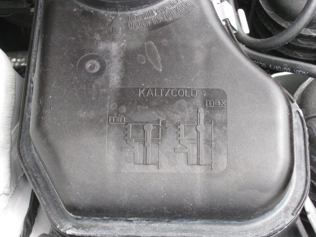

I know I am resurrecting this, but just found this vid which explains how to check the coolant. What the guy in the vid is saying, is what I'd expect based on the diagram on the coolant reservoir - which is a little different than what has been said in this thread for the most part.
Basically, when cold the coolant dipstick should pop out of the reservoir to indicate things are fully filled. If it is just flush with the top, you could stand to add coolant.
I noticed my radiator fan was going nuts (and it is not even that hot). Checked the level and my float is below the threads right now. Guess I'll add a bit of distilled water, can't get any bmw coolant until Monday.
      06-16-2013, 04:56 AM   #32
11331
my "sailboat light" is on, what does that mean?
Well... I guess we know now not to take our cars into Dan Jacobs BMW! ...just kidding!
That is not the correct way to check the coolant. It says so right on the coolant exp tank/res. You always want to check the coolant level bone cold, not when its hot(like in that video)!! That is why the coolant dip stick popped up like that. Defending the dealer... its hard for them to work on a cold engine, bc everyone just drives to them and say HEY my coolant is low(my "sailboat light" is on, what does that mean?)... so thats probably why they made this video like this. They should have been more clear on the procedures though.
Here is what the coolant level (dip)stick should be when cold....
Name:  coolant res  max min  IMG_2015.jpg

I dunno.
That diagram to me reads: check when cold (which is what the guy in the video said he did - or rather he said never check when hot), the min cold level will be when the float is even with the top of the threads and the max cold level is when the float is popping out an inch or so.
The diagram says nothing about the max level being a 'hot level'. Even the owners manual page you included says (on step 3) the level is correct if it is between the min and max marks... Which to me reads, if it is at the min mark you are barely okay, so add some fluid. the guy in the video says this as well.
IF you look at the two "dots" on the stick-like float... when its full the stick would never pop up as far as shown in that video. In the video I think its obvious the engine was hot. Or at least fairly hot, not cold. Go check yours and report back. But don't burn your hands.
Btw... its a good idea to put some grease or petroleum jelly on the coolant cap. Its something everyone should do but no one really does. Thats what makes the cap so hard to remove. Also... when you re-install the car keep tightening it until you hear a "CLICK", then its on.
Okay. I see what you are saying now and agree.
My float was about and 1 to 1.25 inches below the min level. It took about .75L to get it to the max level.
For fun, I kept going to see how much it would take to get the float out all the way (as in the video). It took about another .5L and there still looked to be a decent amount of room left in the over flow tank. I sucked out the extra fluid using my antifreeze strength tester.
Bottom line, I suspect it would not be a big deal if, when cold, you fill so the float is out all the way. Can't imagine .5L in a multi-gallon system would make much of a difference.
My cap does not click - it kinda 'slides' into place and will not turn anymore. The arrow on the cap lines up with the arrow on the reservoir.
I dunno.
Sorry, but I agree with foghat too and think you're wrong in terms of the max cold level float indicator... Here's another video also that shows clearly the float stick and how its top sticks out of the expansion tank when full, just like the diagram on the car shows...
