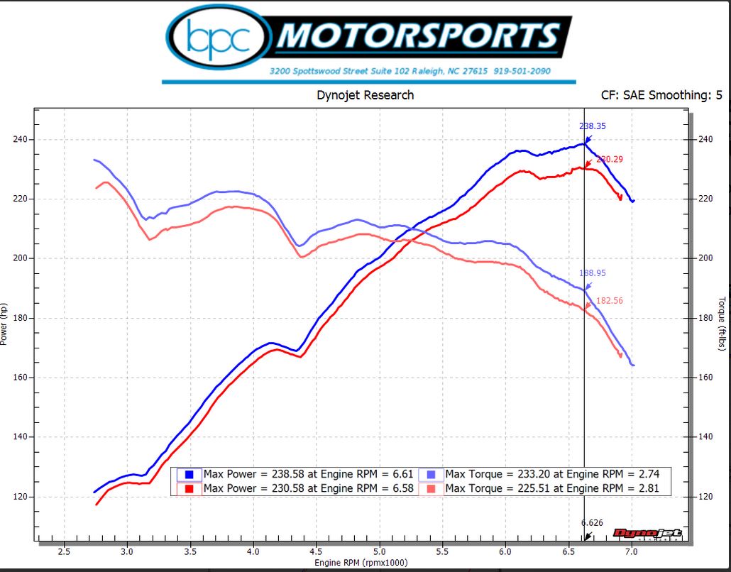

Well, it's not a perfect comparison, but MILVS+tune got me 6whp over MILVS+no_tune. My understanding was that you need a tune to be able to take advantage of the extra lift from the MILVS, so this should essentially be a MILVS/noMILVS comparison, but people have said that the adaptations will figure it out on their own, so I'm not entirely sure what to think. This is just back to back testing, where the car was without tune for a few hundred miles, then I flashed the tune while at the dyno. It was ~6hp across most of the range.
If you already have the valve cover cracked, it's not too much effort to install these things. I would definitely *not* do a valve cover job just to put them in though. It makes a noticeable difference driving, but not so much that it's worth the hassle, imho.
Name:  2020-06-11 09_30_01-.png
Attachment 2335785
You are correct. Adaptations will not compensate for Milvs. You need a tune to adjust for the added lift and duration.
I think Marty advertised around 8+hp with Bob's tuning before he left BPC. This was their dyno.
Either way.....I could definitely feel a difference.
