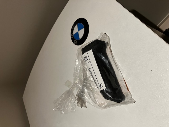

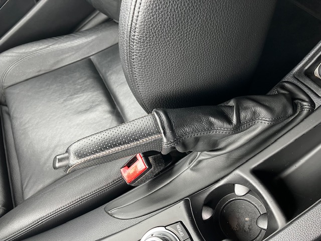

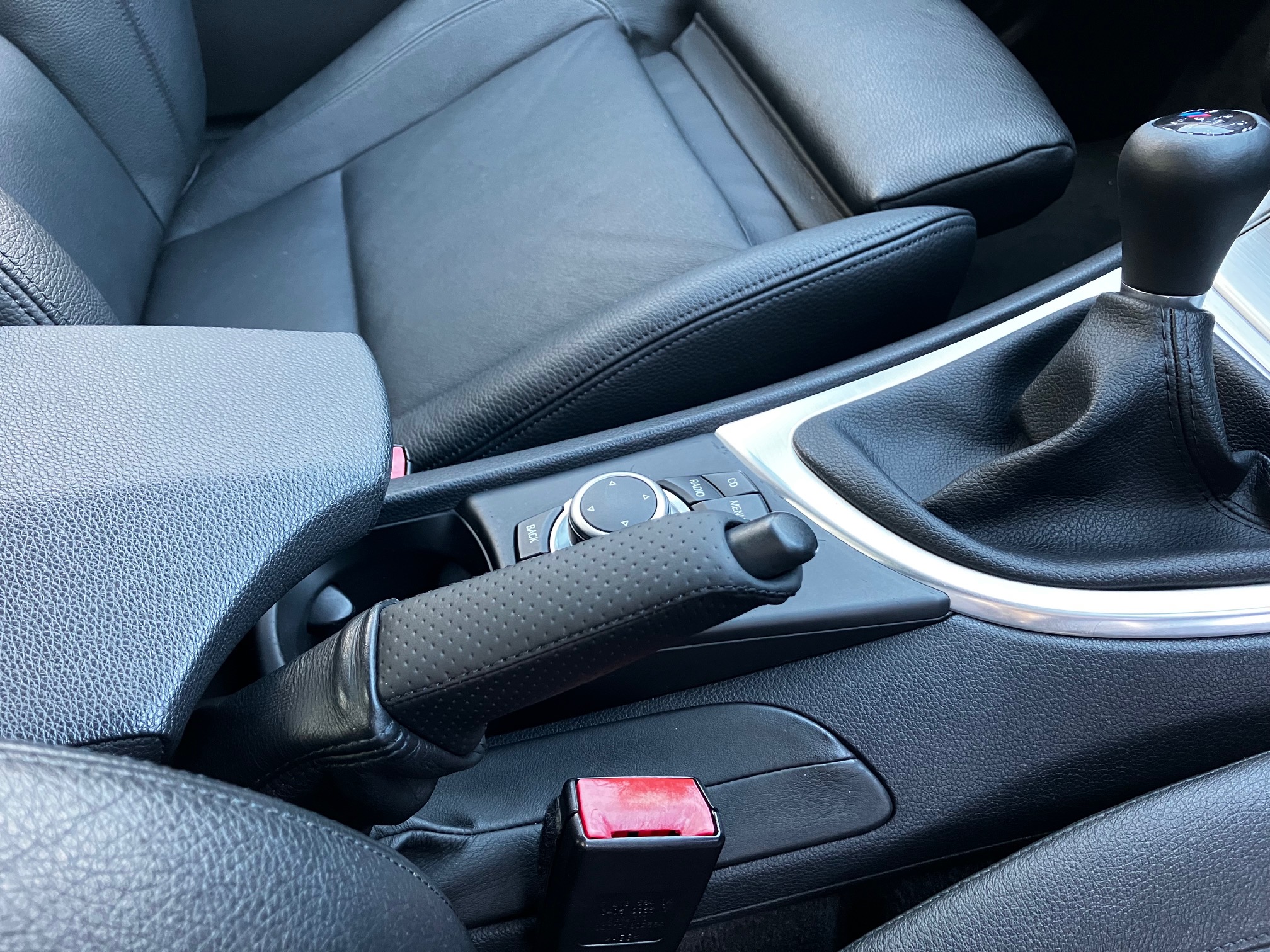

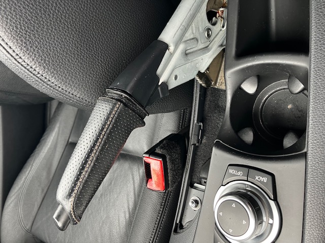

Got to the e-brake handle replacement. Removed the boot and had to pull really, really, really hard to remove the original one. As far as I can see, you end up breaking the plastic tabs inside the handle to get it off. There is no way to get to the tabs on the inside due to the plastic support part shown in the picture.
Cleaned up the boot and 'repaired' a few scratches before final install.
Let's see how long the matte look lasts : )
Also, any good ways to get the seat belt buckle releases back to red? I haven't checked Real OEM so not sure if the buckle is replaceable or not worth the hassle.

Hmm, good question on the buckle. At a glance a new one is over $200 USD, and you'd want 2 of them. There's a sensor in them as well. Might have to remove the seats to get to the bolt for the buckles as well. Lots of work. Vinyl, maybe, but seems like it'd slide out of place. Any fixes with sandpaper or polishing just sound like they'd get further damaged. I've seen people color them with a red permanent marker, but it seems like you'd be able to tell that's exactly what you did and it might look silly.
Sorry, that's the opposite of what you were hoping for!

Yup, that's kind of what I figured. Might try some of that Novus plastic polish I used on the blinkers and headlights to clean em up a bit.

I think I've seen people use extreme heat (torch) just gotta be careful to not burn the seat or the entire car lol. I think m539 has used the red sharpie that tracer alluded to with good results.

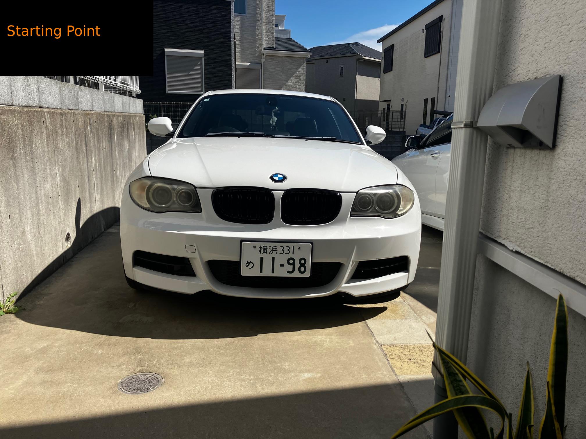

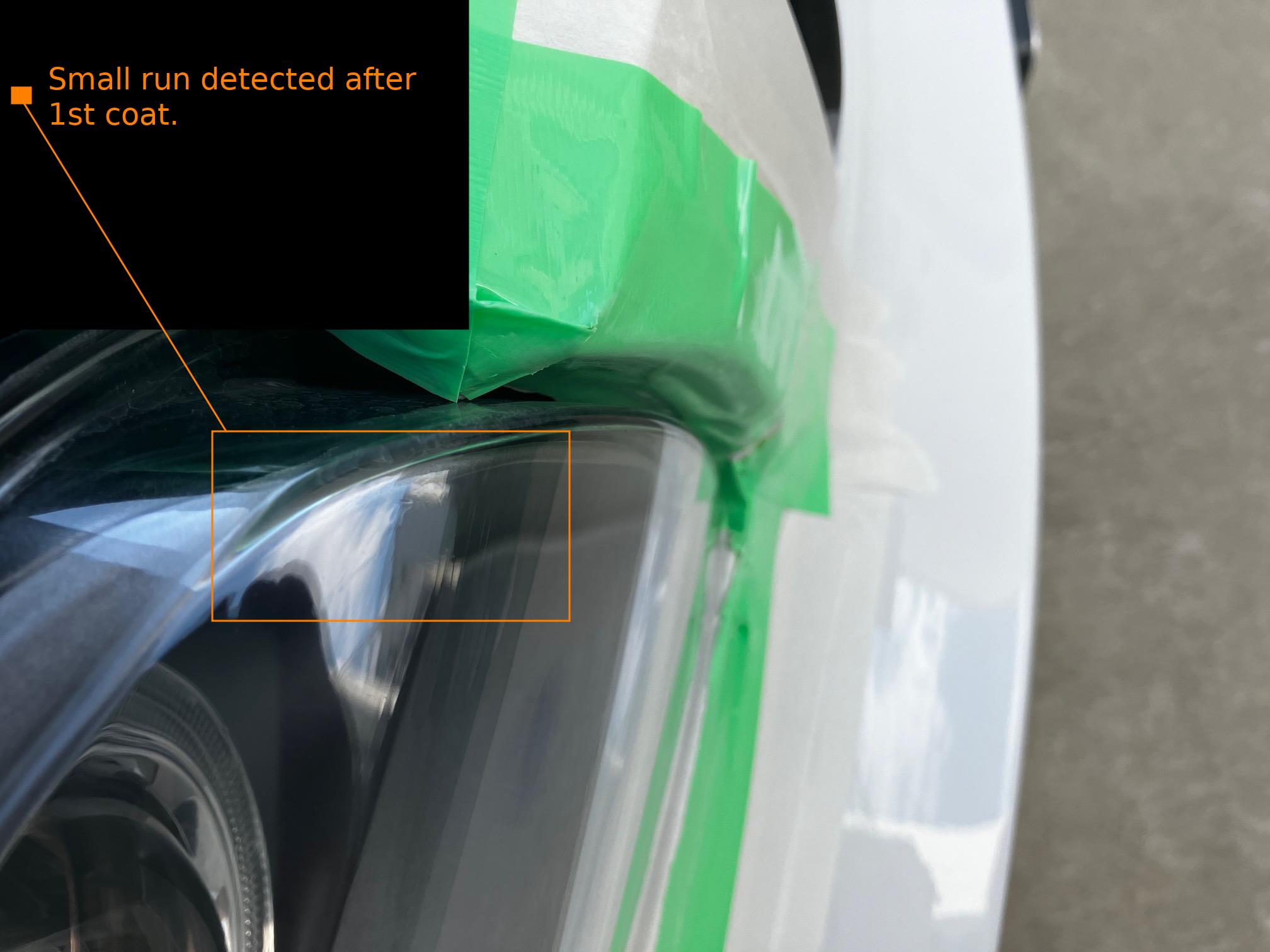

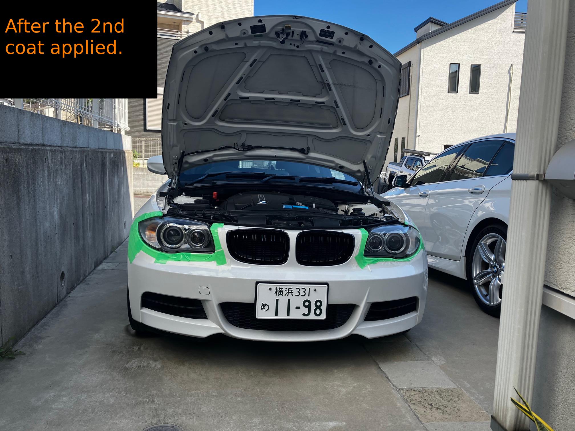

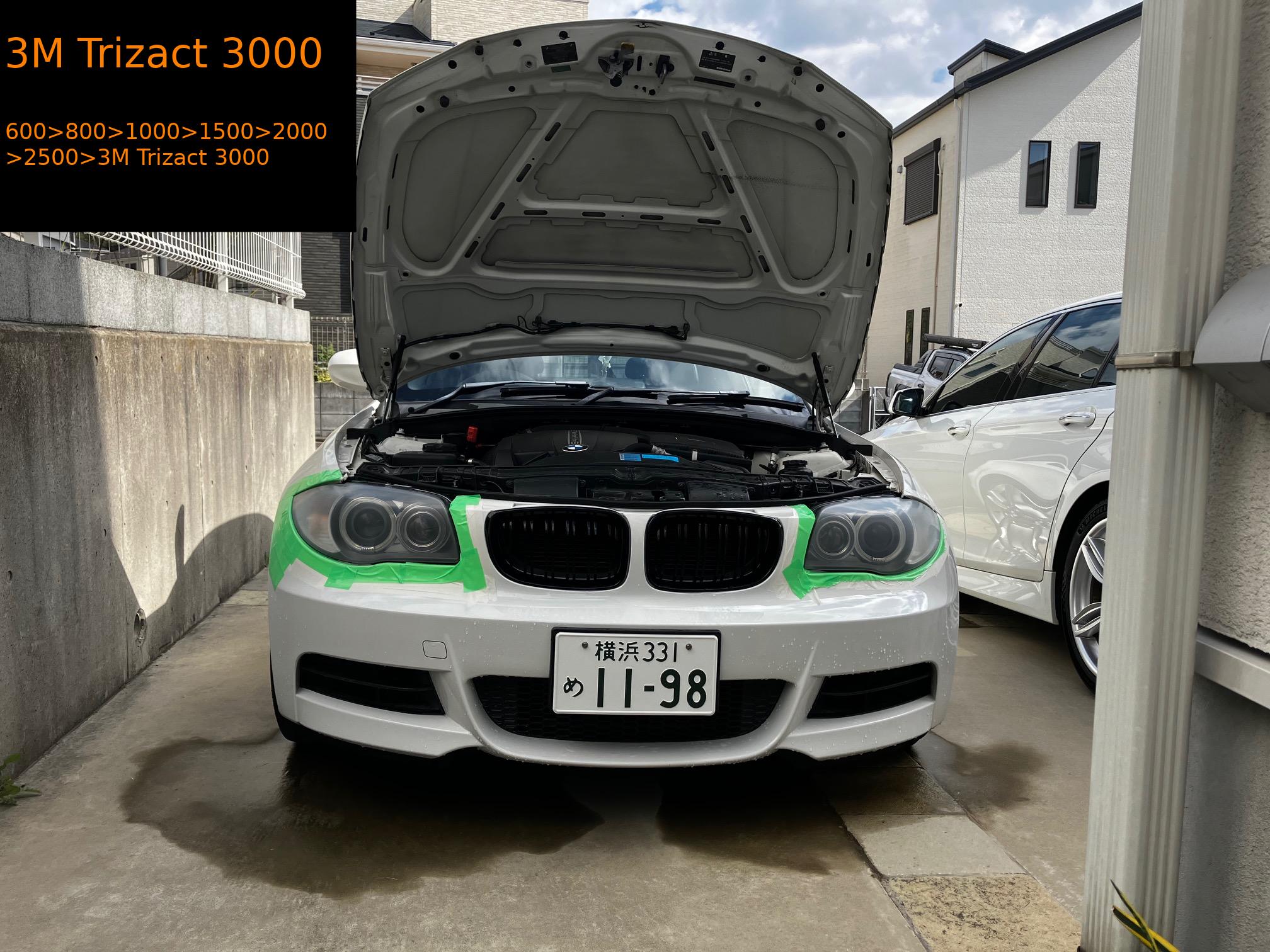

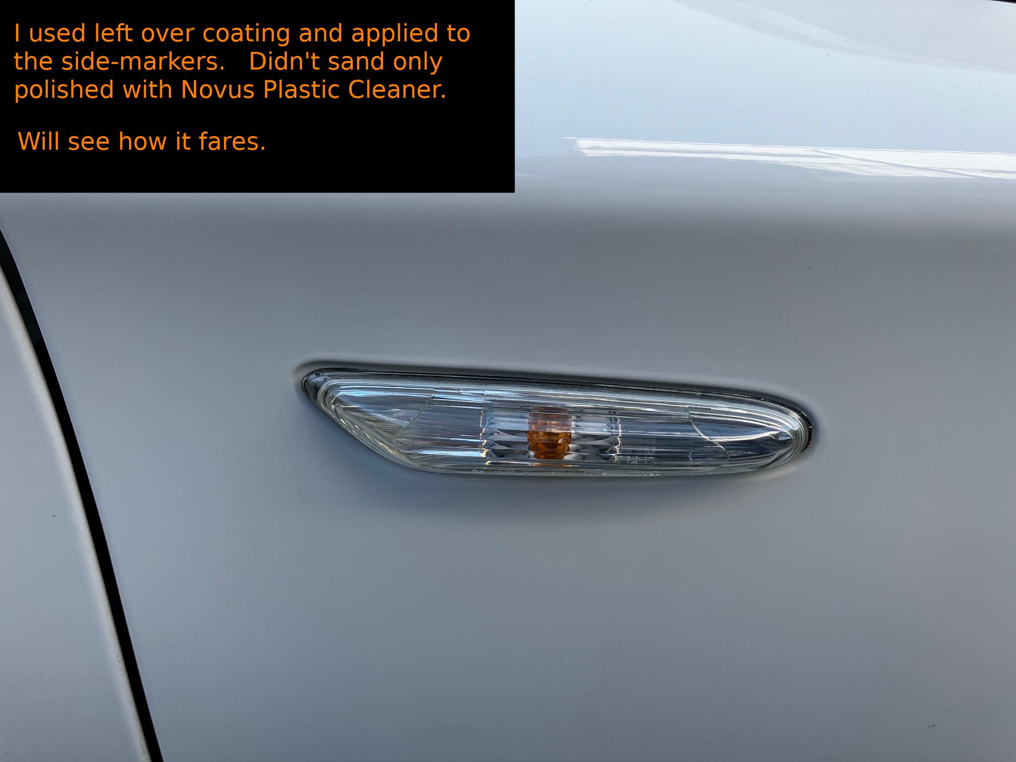

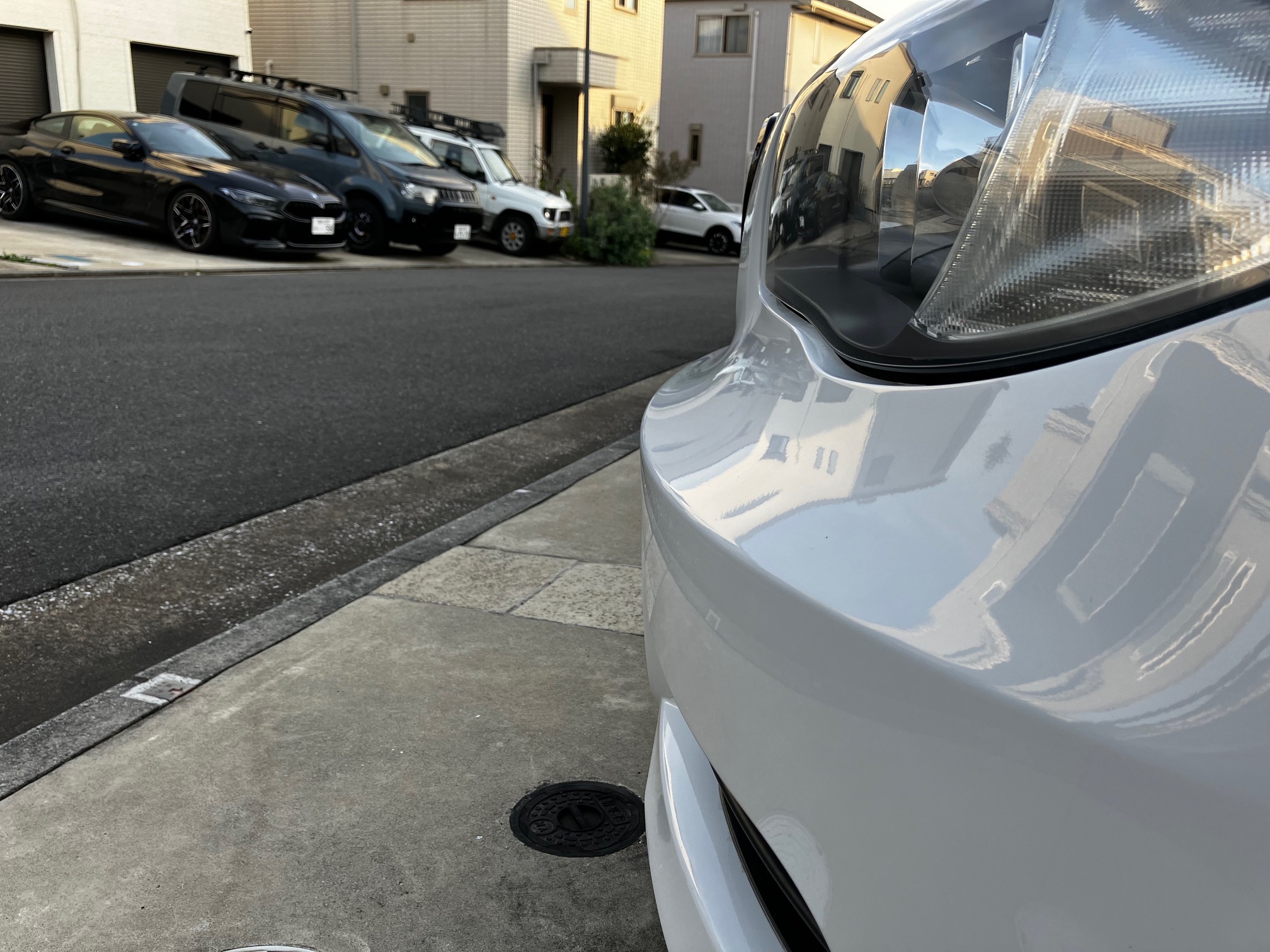

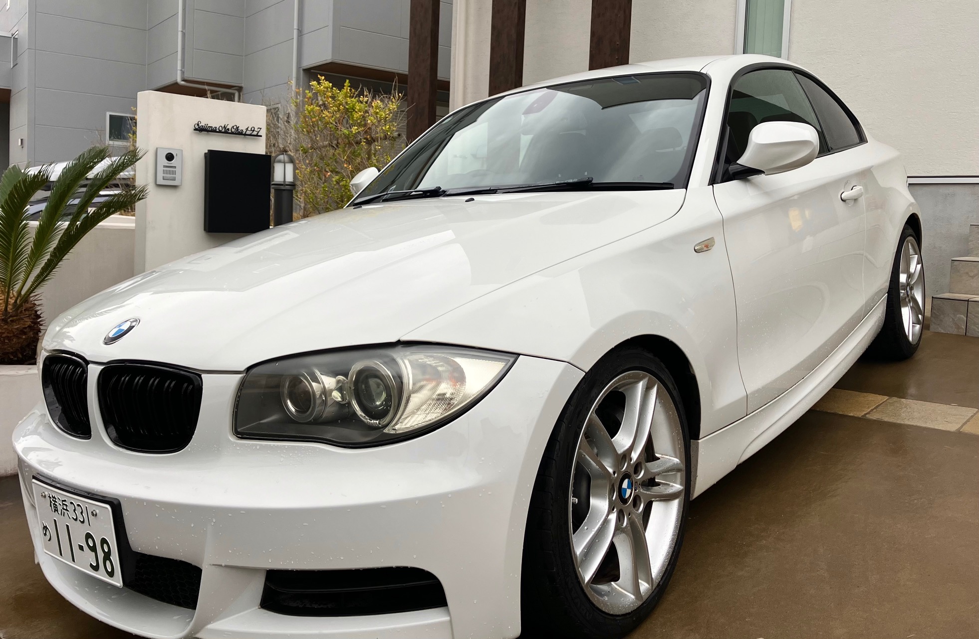

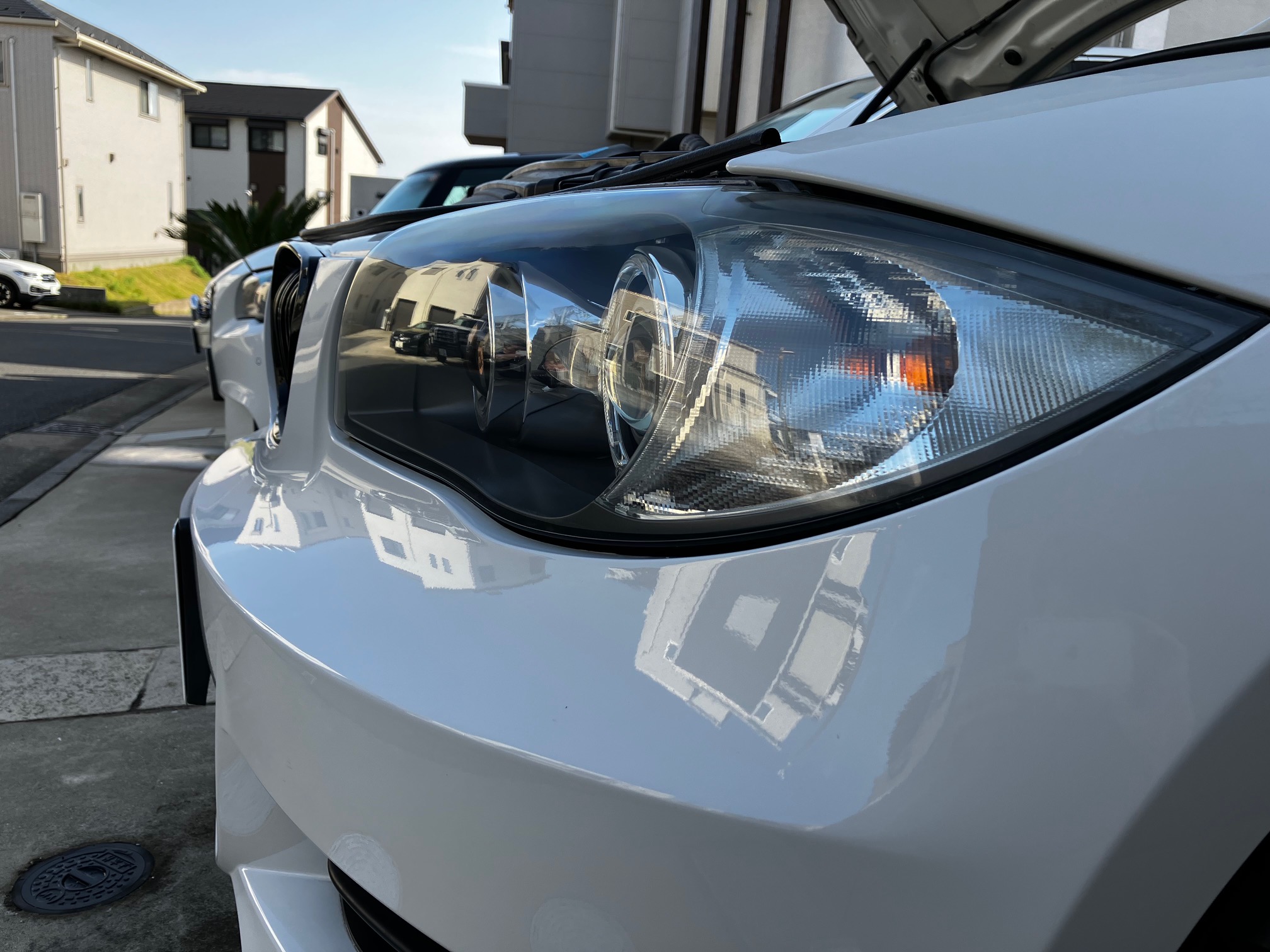

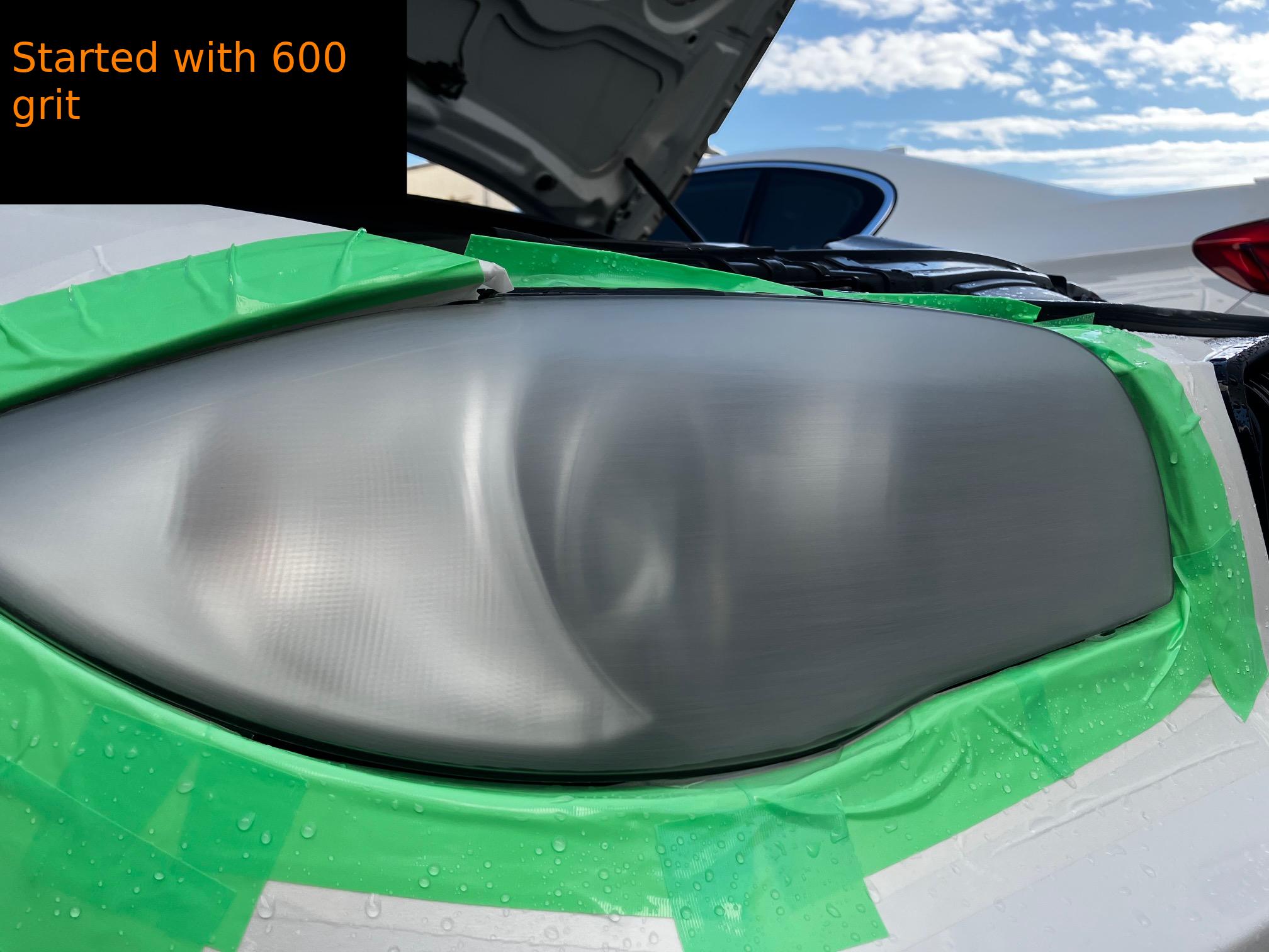

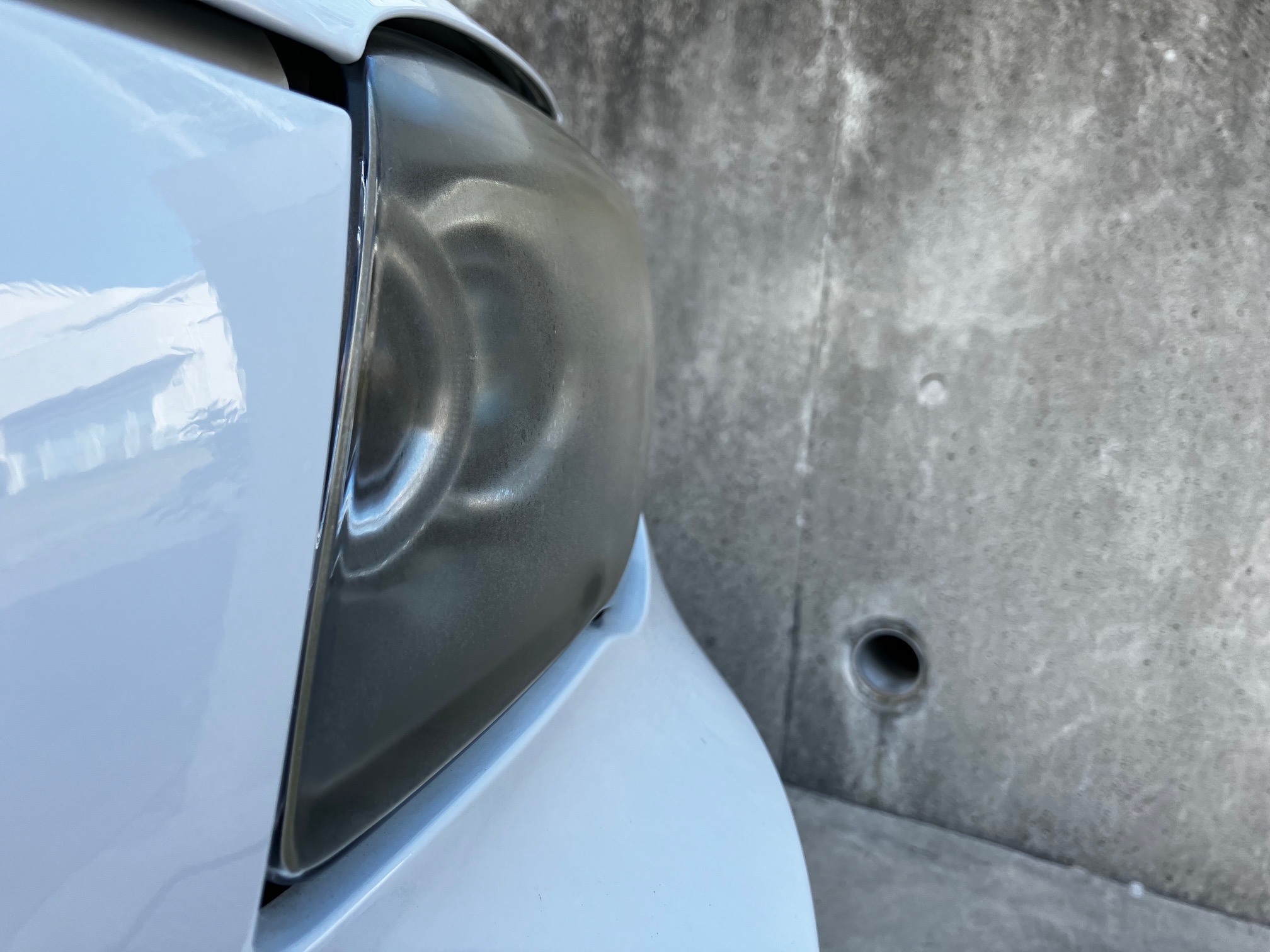

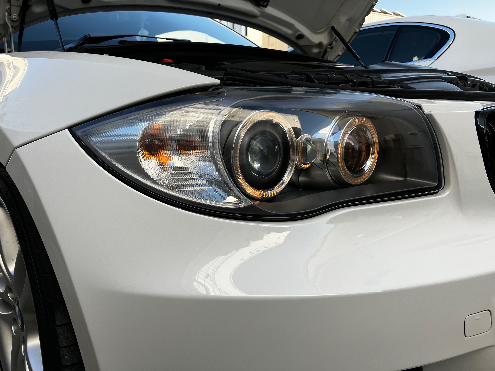

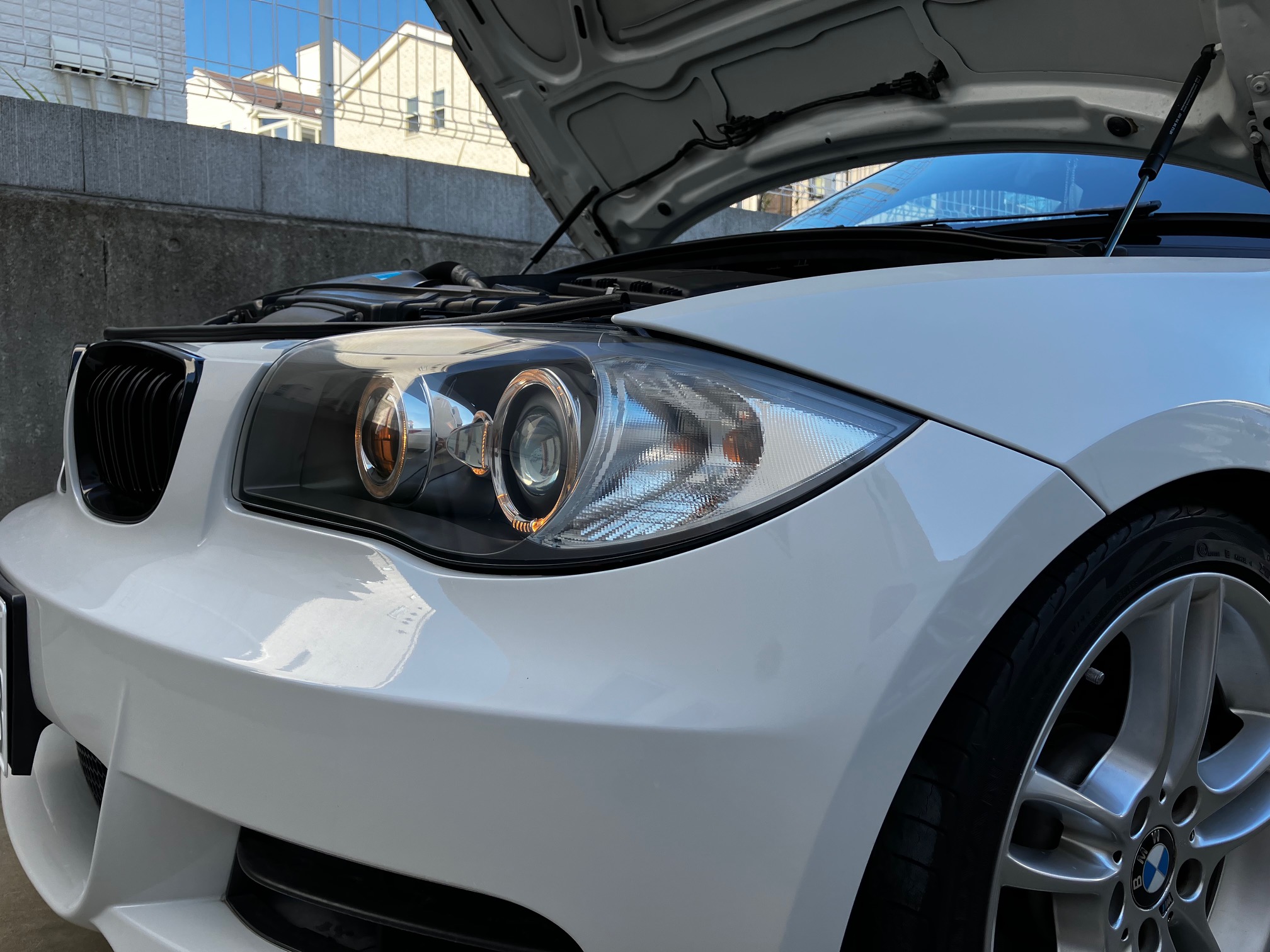

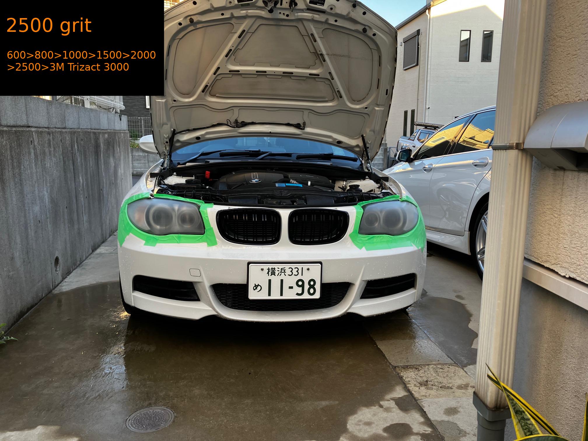

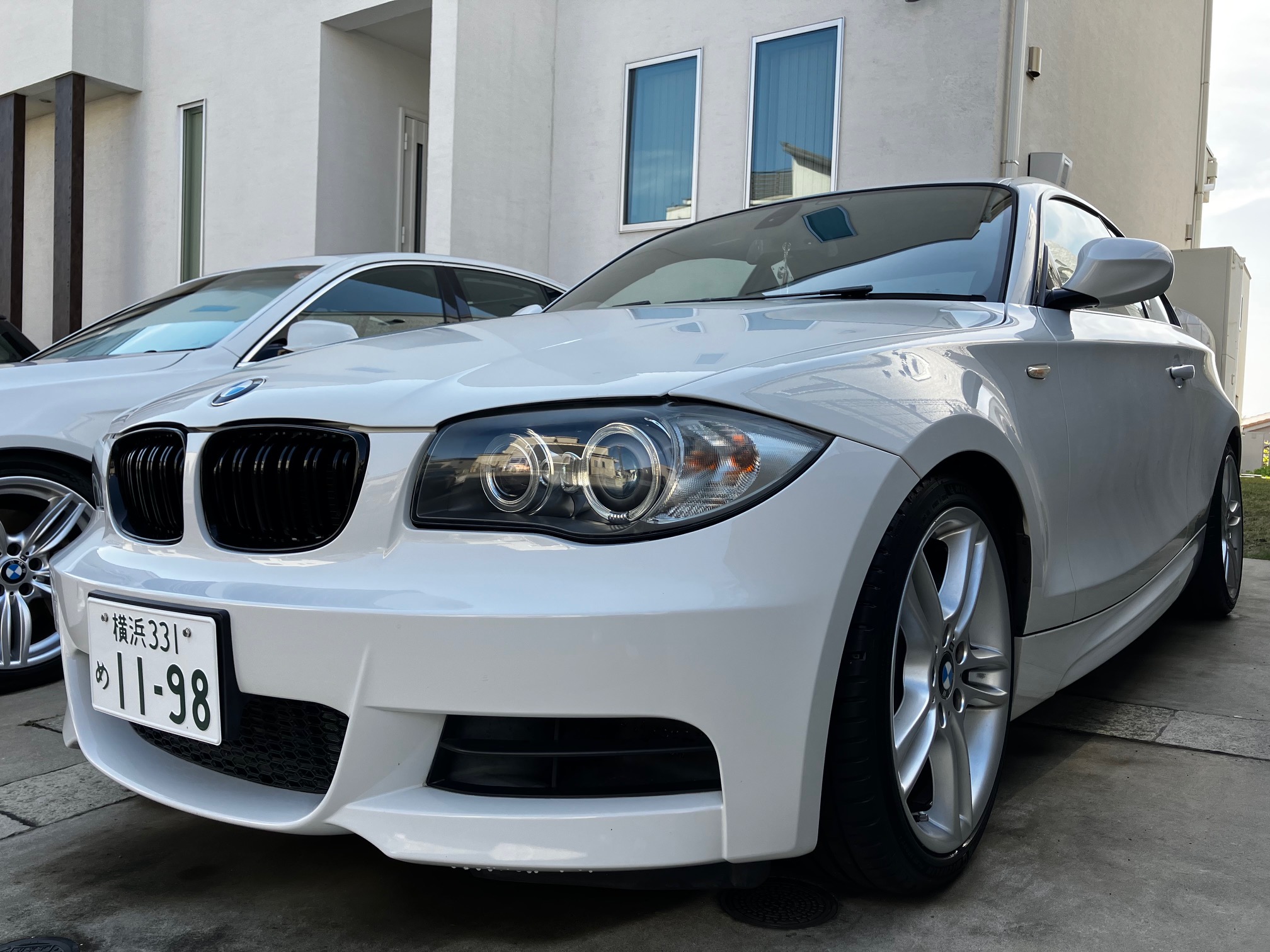

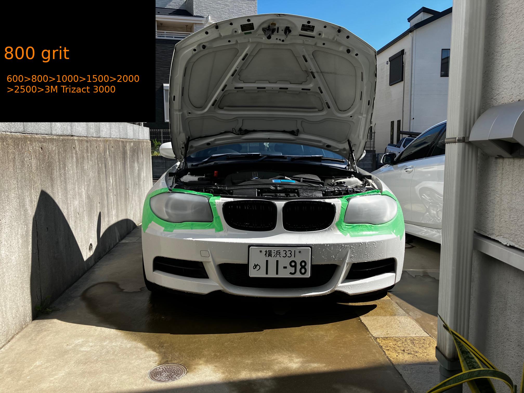

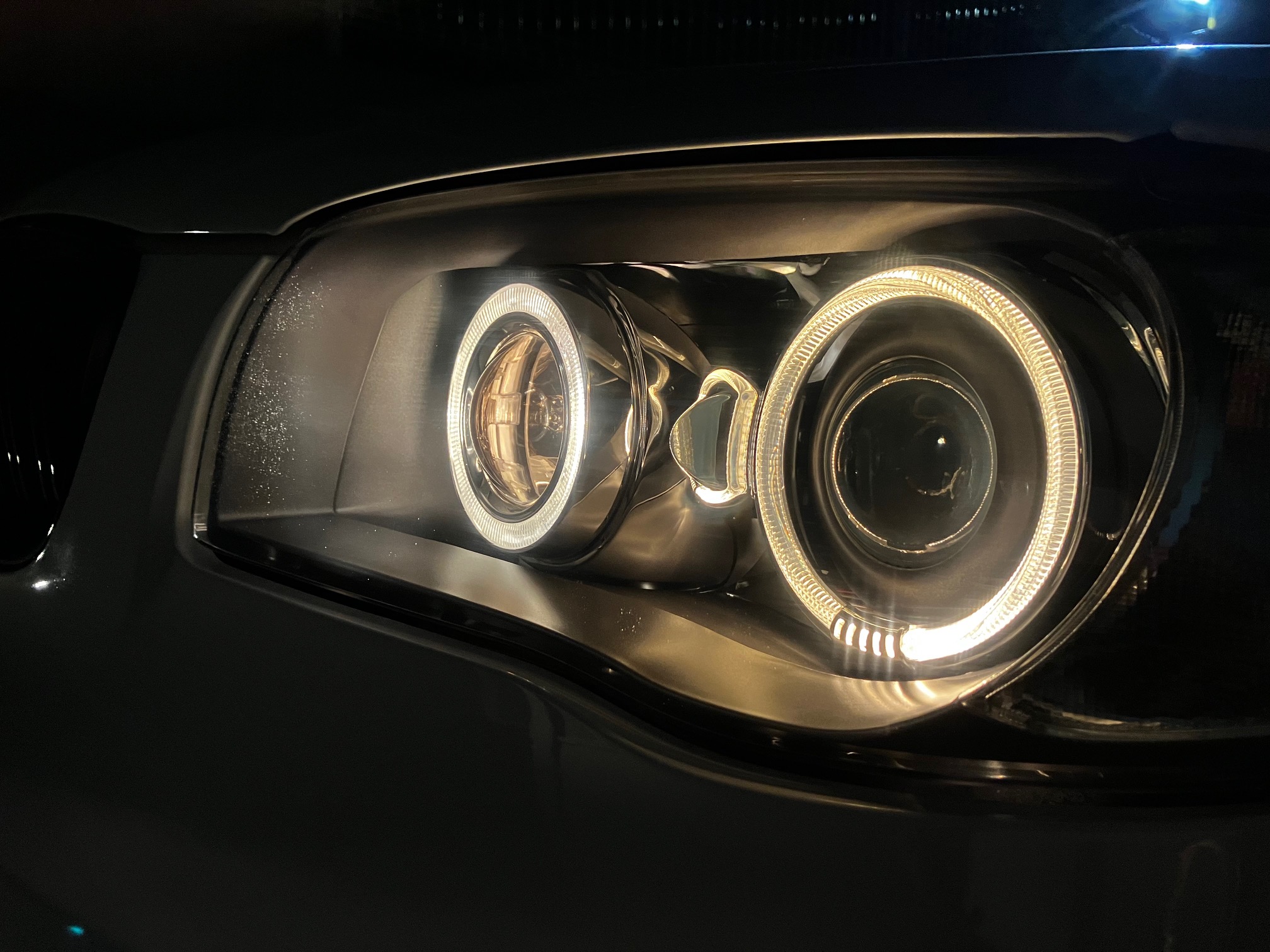

I finally started on the headlights - something I've been wanting to do since buying the car a couple years ago.
Was on the fence for best long-term route but finally settled on doing the sanding myself and go with the 3M clear coat wipes. Almost went with a Urethane spray sold locally but wasn't fully confident that I'd spray evenly, not get the stuff around my other cars and possibly breathe it in without a mask. Given this was my first time doing headlights, this would be a 'trial' run and if/when they go bad again, I can consider something else but want to see how long the 3M wipes last with regular care.
The original clear was gone at the top of the lights with a small amount remaining at center point but was cracking and faded. From a distance, they didn't look too bad but from the sides you can clearly see deterioration.
Started out with 600 grit dry (on the right side) then wet sanded from 800>1000>1500>2000>25000>3M Trizact 3000. On the left side, I started with wet sanding instead with the 600 and followed the same intervals up. I did the dry as I heard it was more effective to be able to determine when the sanding dust goes from yellow to white as opposed to wet sanding where you may not get all the yellow clear off. At any rate, my view is wet sanding is far better. I had no issue knowing when I hit pure polycarbonate material with either method. The right side light which I started dry had scratches even when I hit 2000 grit, so I ended up going at them again from 600 upwards.
I did all this by hand and really enjoyed the time over three days getting this done. I do see some very fine sanding marks with the lights turned on but hardly noticeable. I'll need to check them in more depth when the sun goes down.
As for the 3M wipes - nice product. Wiped on smooth, didn't streak and finished them off like glass. This was the most nerve racking point. Hate to admit it but I actually practiced how and from what point I'd wipe considering the contours and potential dangers like hitting the fender and causing an uneven stroke... The only thing when first using is you don't know how much pressure to use on the wipe - too little and you mis-coverage and too much and you risk runs. I ended up with a very small run at the very first point where I started - a shame but it's hardly noticeable. All in all, it wiped on better than expected.
Lot's of pictures below on progress and results but glad to finally get them to where they are. Waited for a long time to see the crystal clear champagne angel eyes..

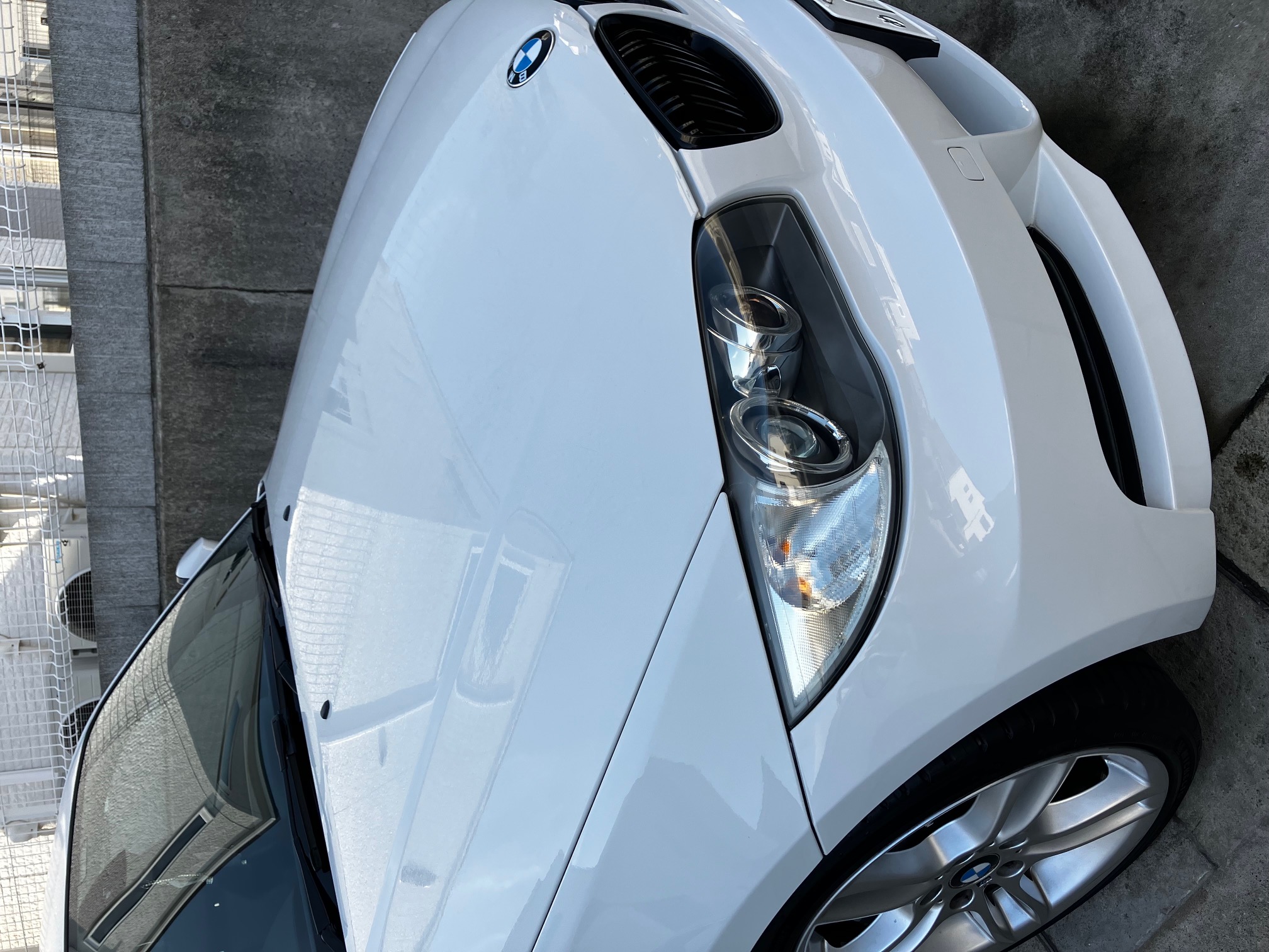

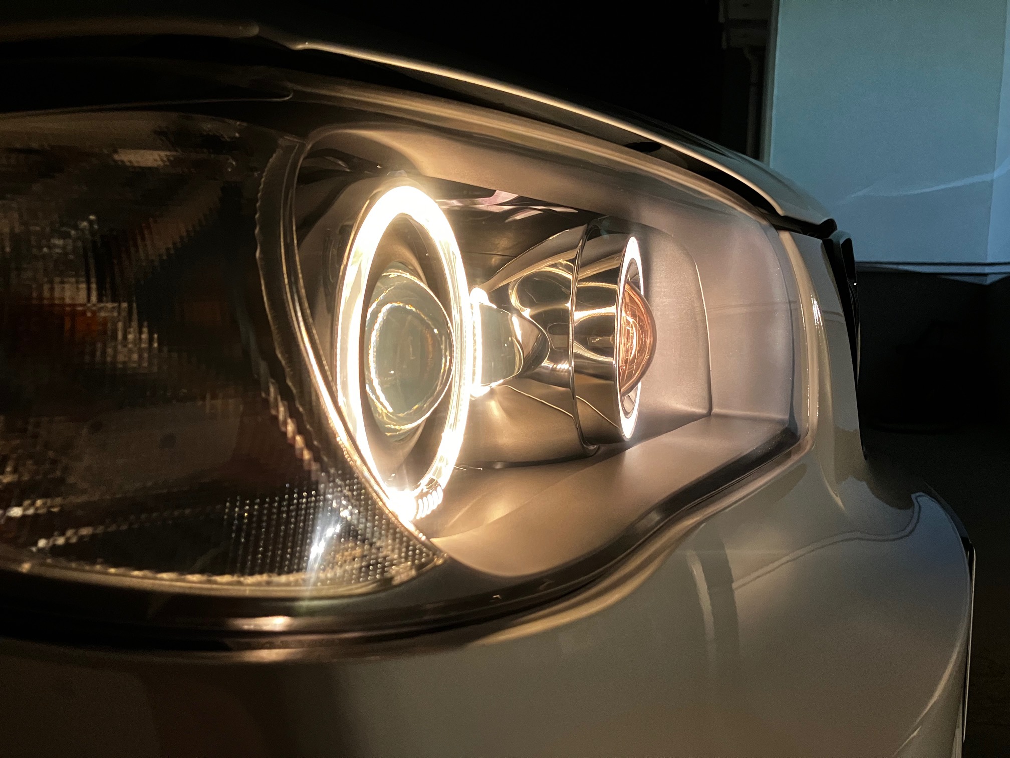

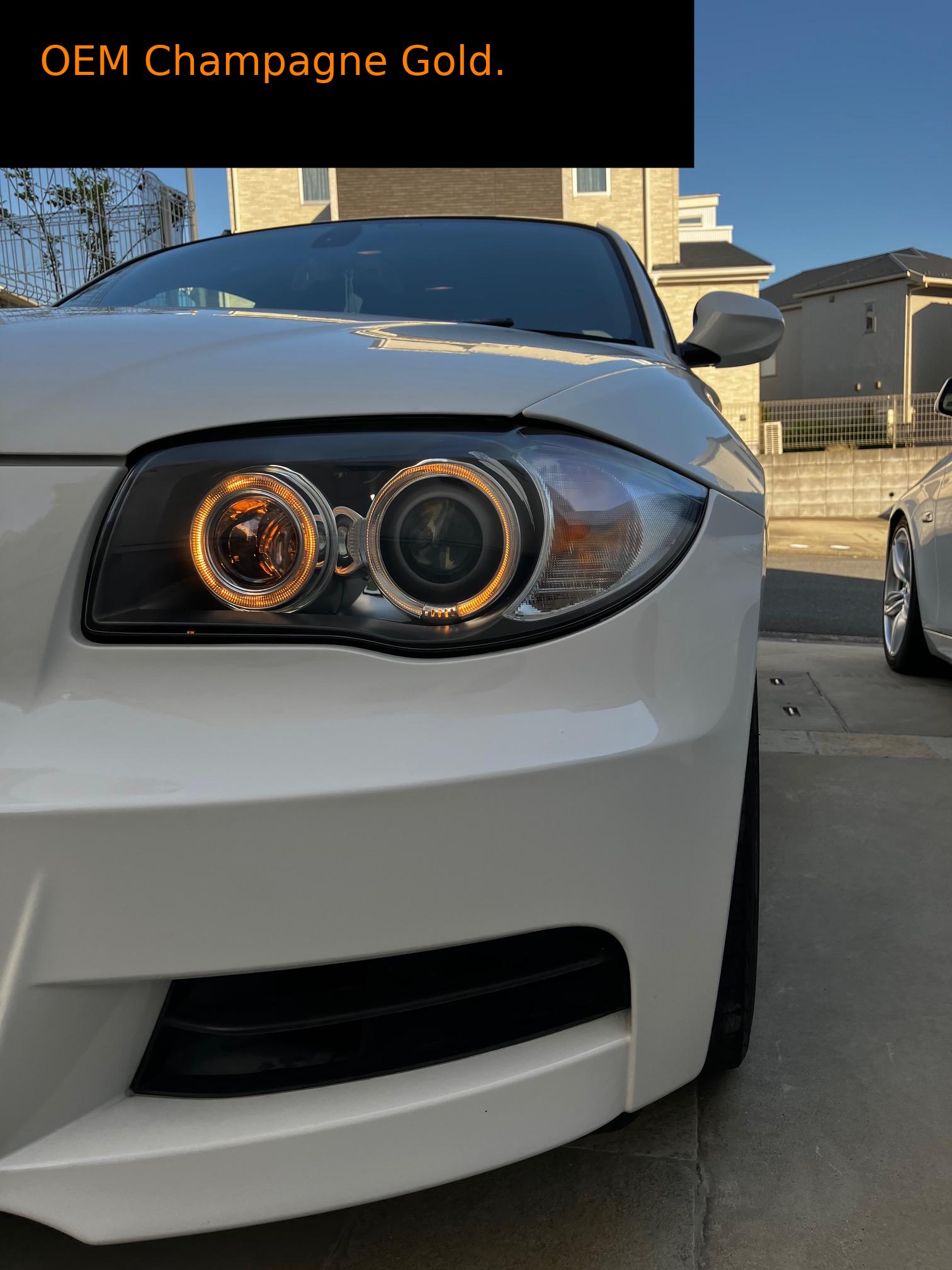

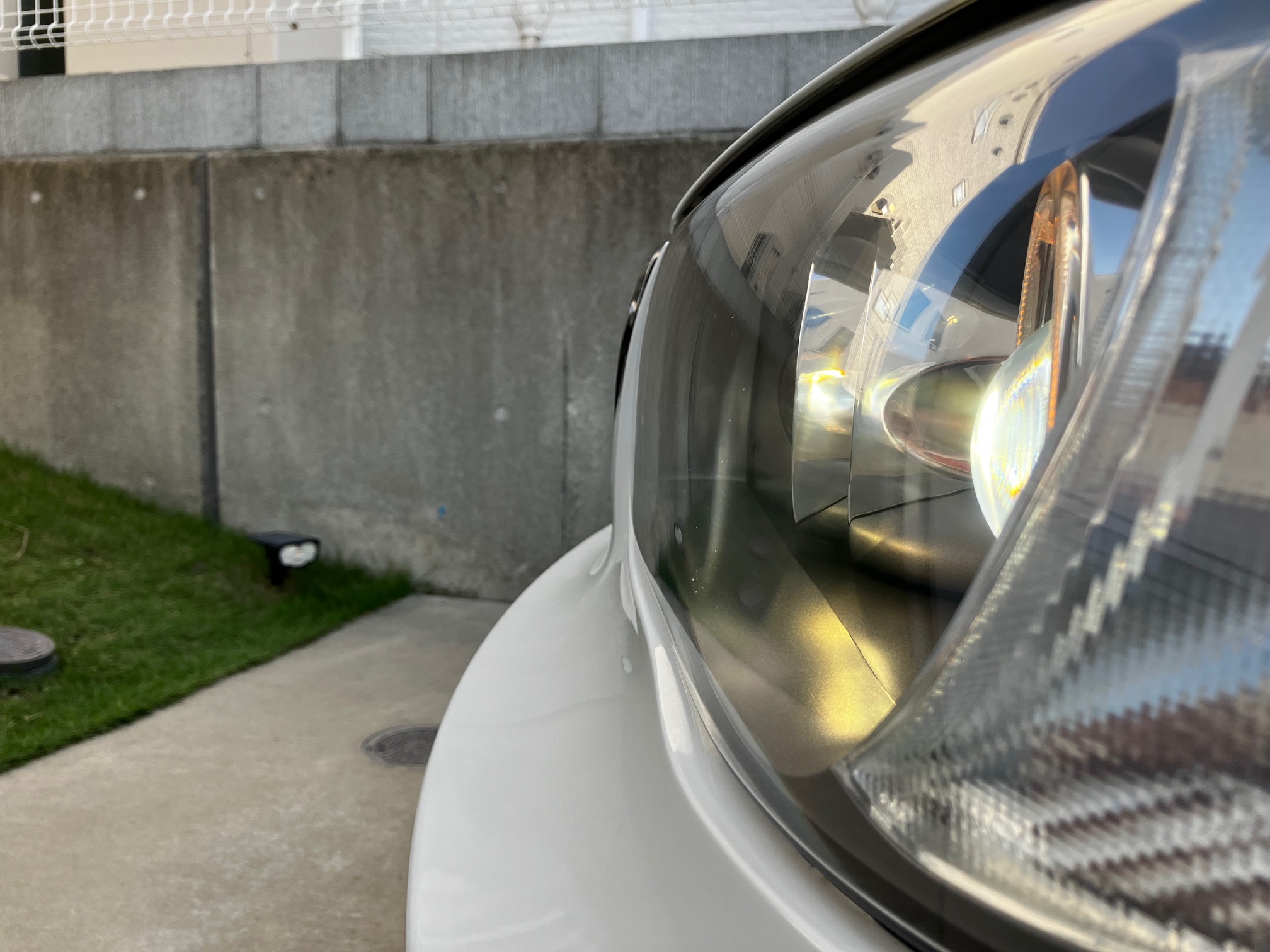

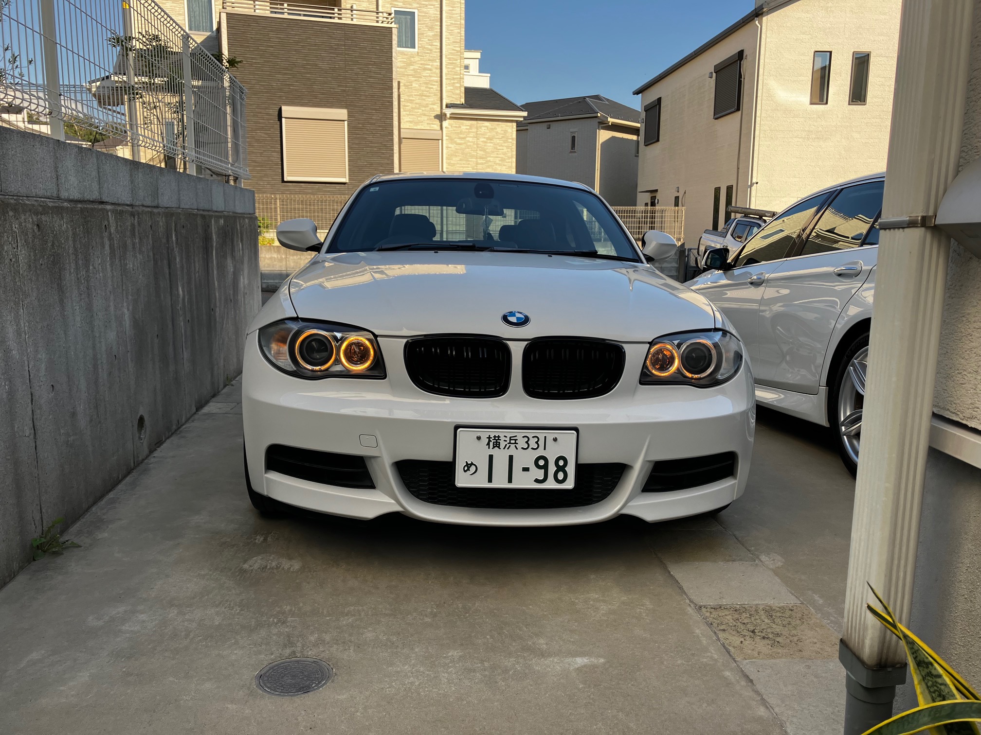

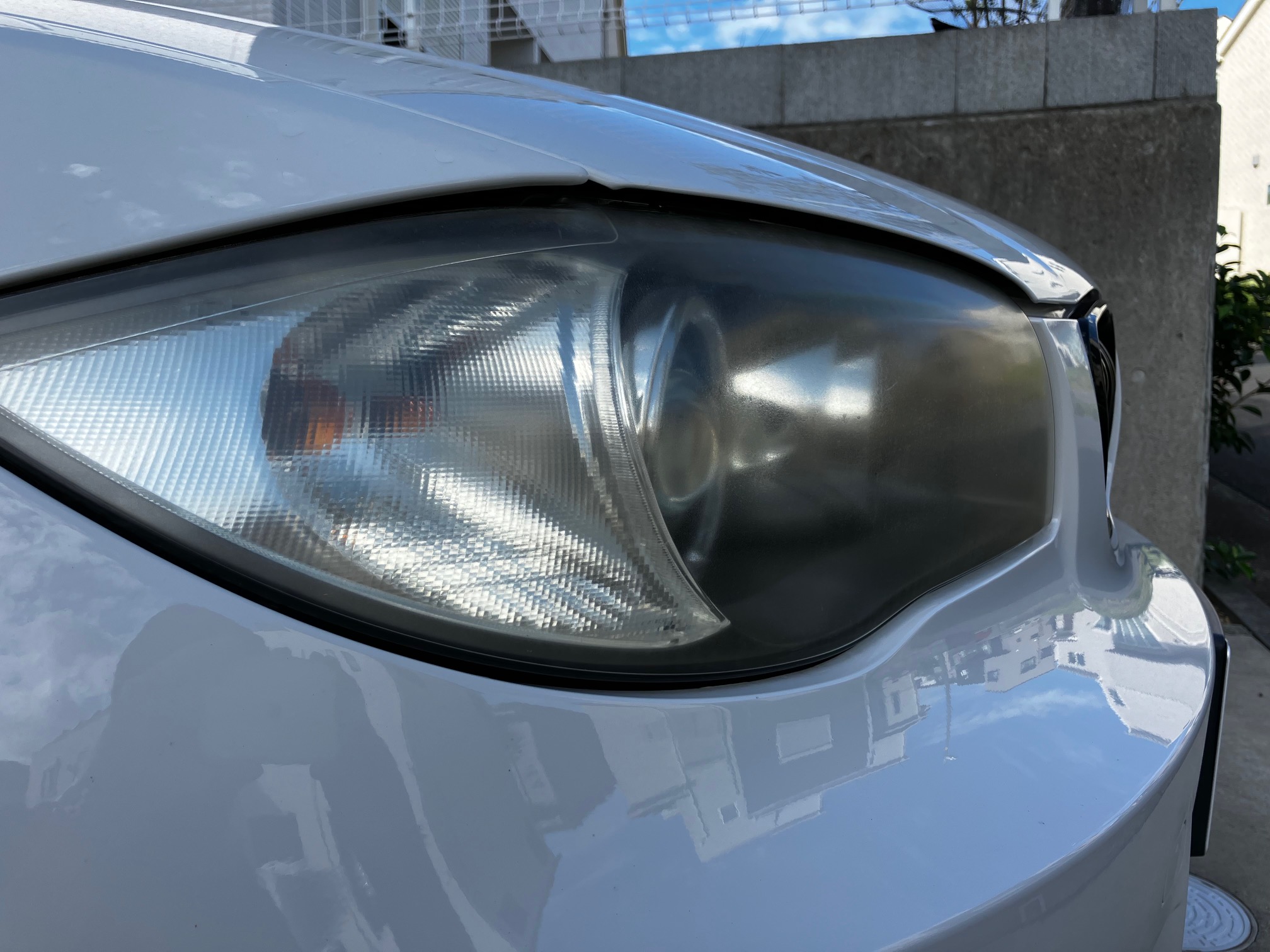

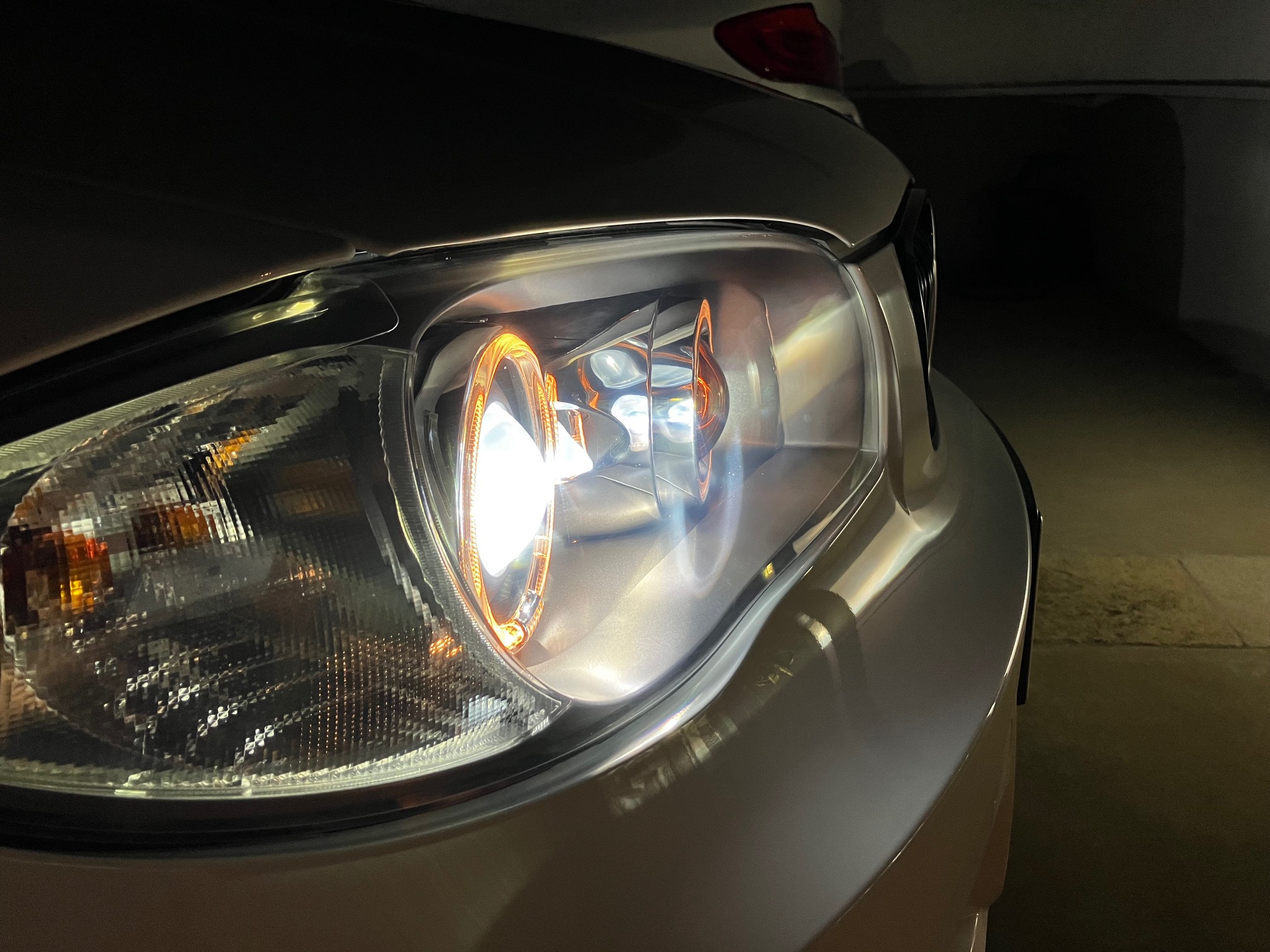

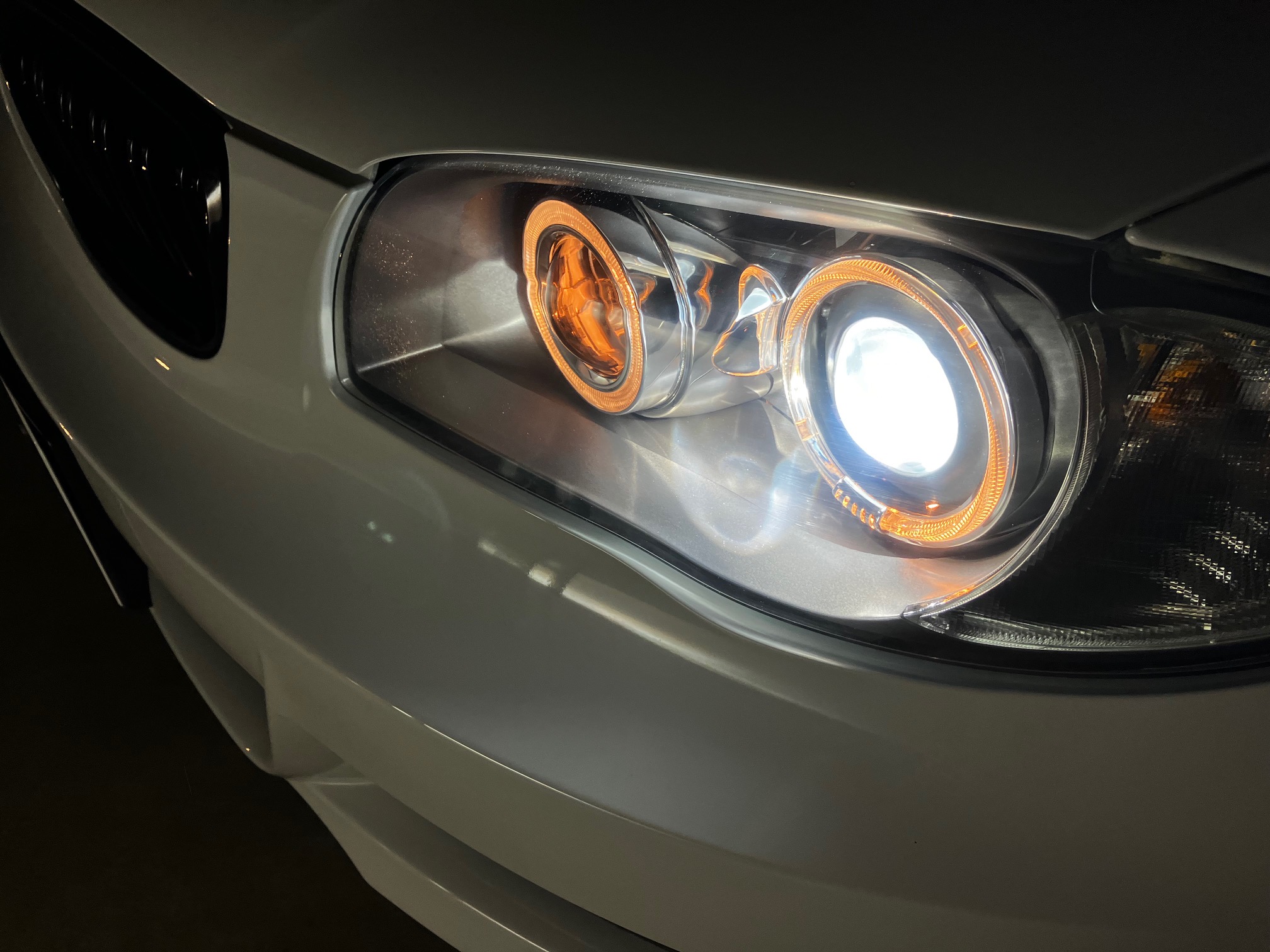

A few night shots of the headlights. The right side (when sitting in the car) turned out more clear then the left. Interestingly, this was the side I started off with the dry sanding and ended up wet sanding for two 'rounds'. During the wet sanding, the other side did seem smoother.

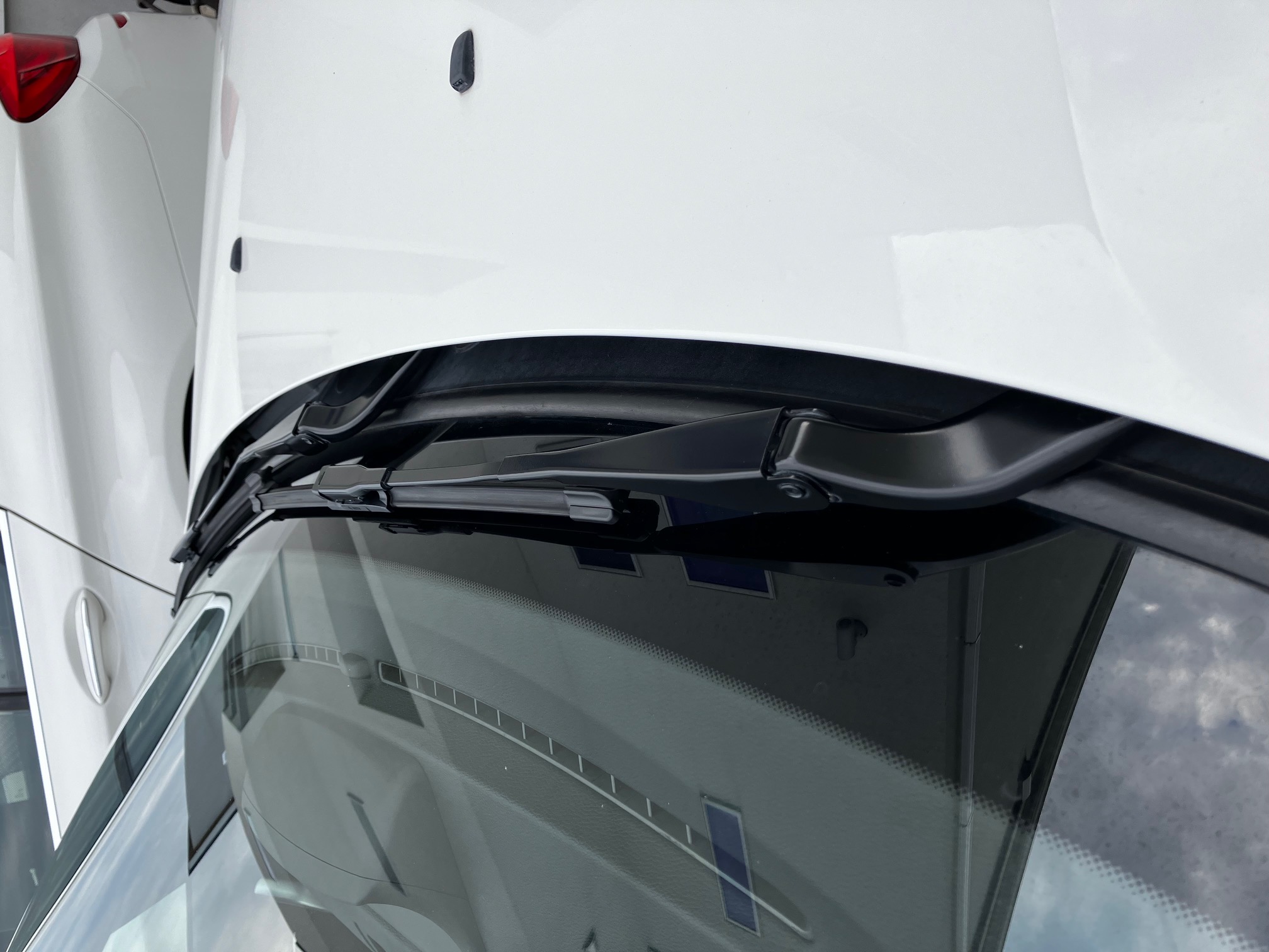

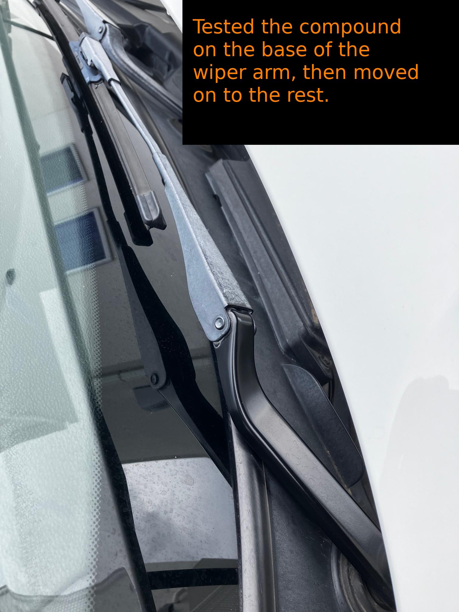

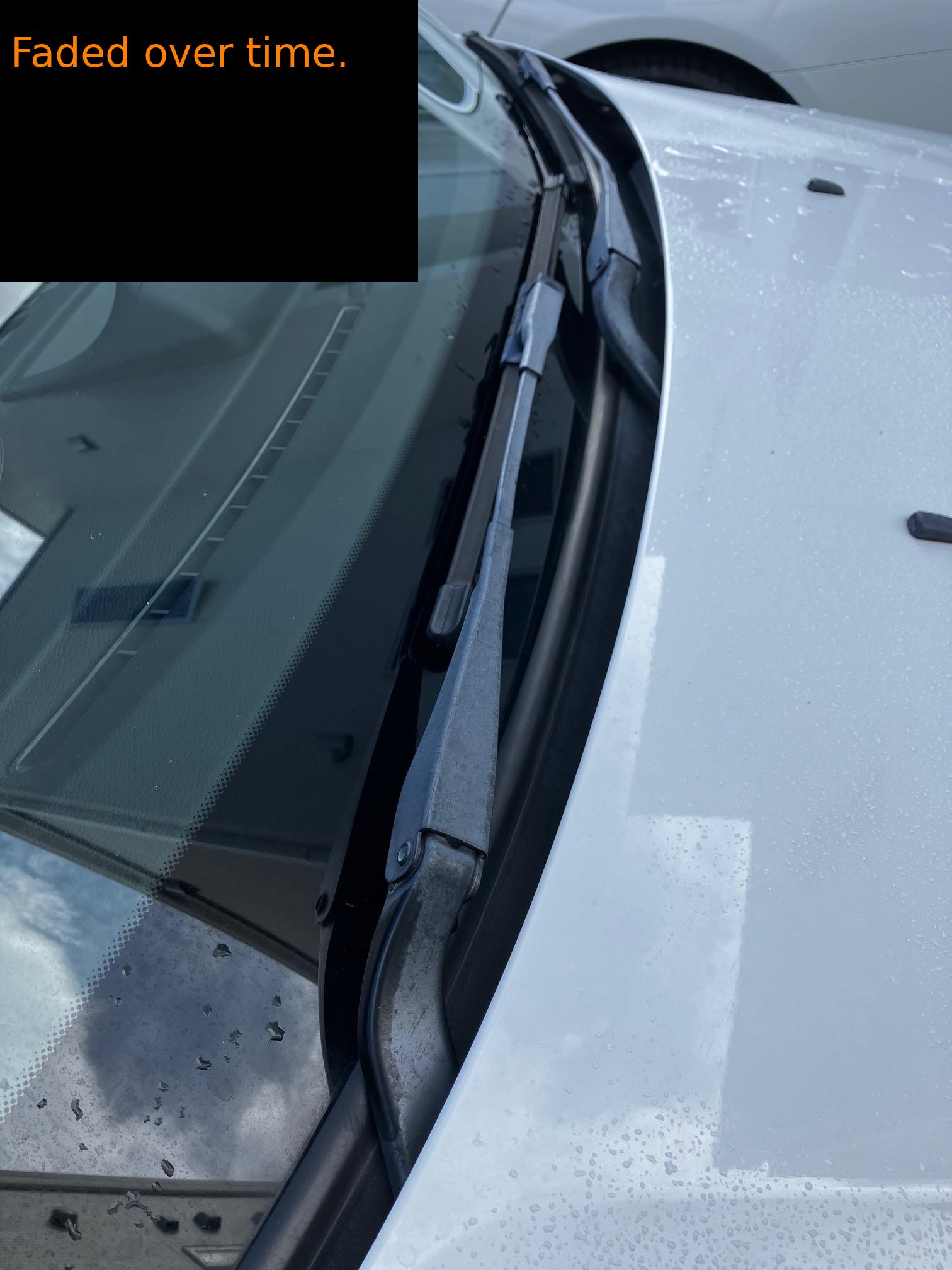

Since I've been focused on the front end, could no longer ignore the wiper arms which were in bad shape.
Used medium then followed up with light rubbing compound and that seemed to bring them back.
I doubt there is any kind of clear coat on them - and will put some sealant on them later - so hoping this restores them back as best can be for sitting in the sun for 13 years.
I do think this car was never garaged since new and sitting next to my F10 and the MINI, you can really tell it lacks that luster.
But, that is being corrected little by little.
Next up will be hitting the rims with the compound and to see if it can also revive the black M-Sport door and window trim which I'll need to approach carefully.

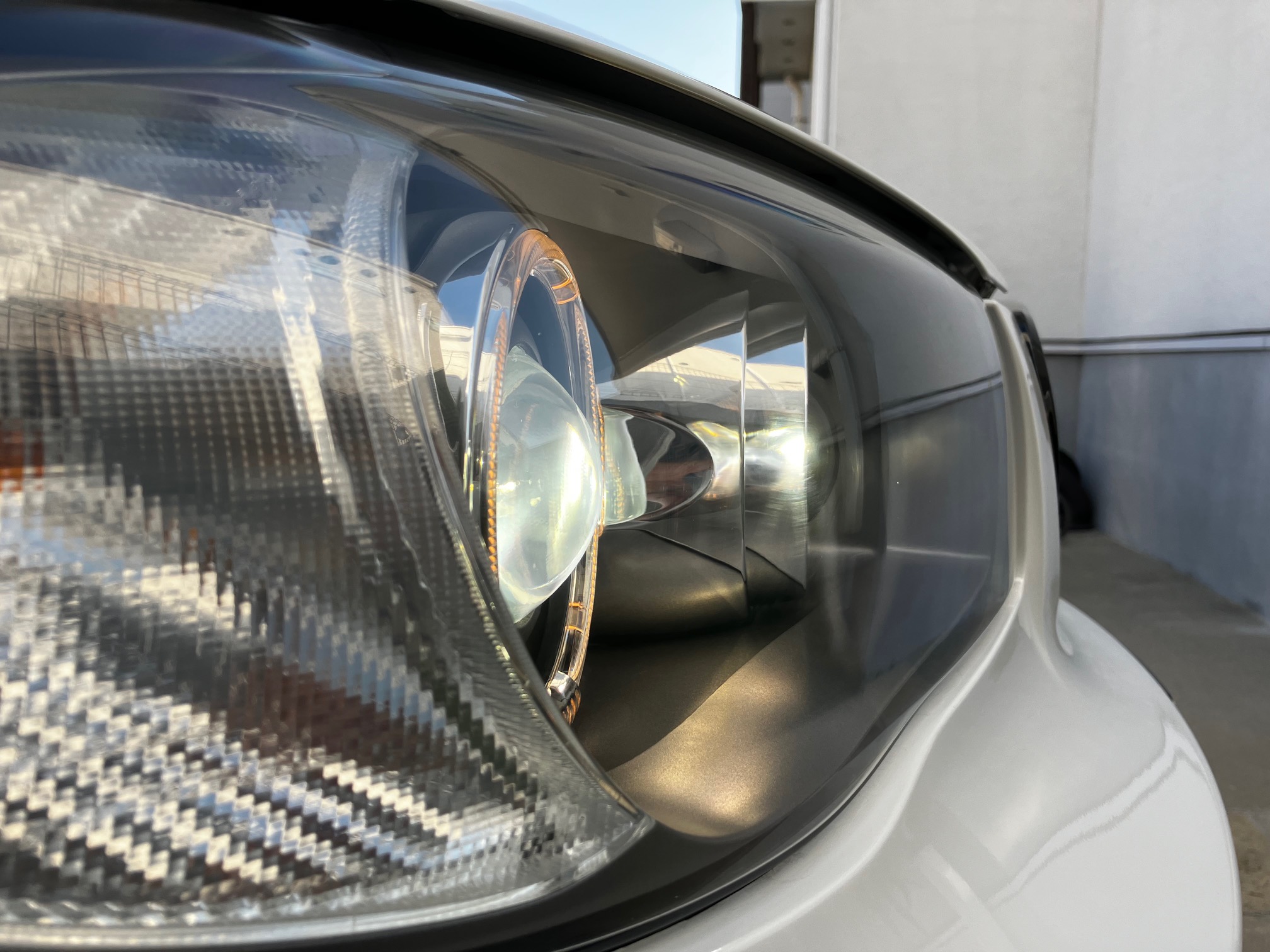

Quick update on headlights.
It's been almost 6 months since I restored them. So far, not seeing any yellowing coming back. I've been pretty diligent in keeping them coated with Carnauba (Chemical Guys Butter Wet Wax) roughly twice a month.
I get it has been winter so the next six months things may change but we'll see.

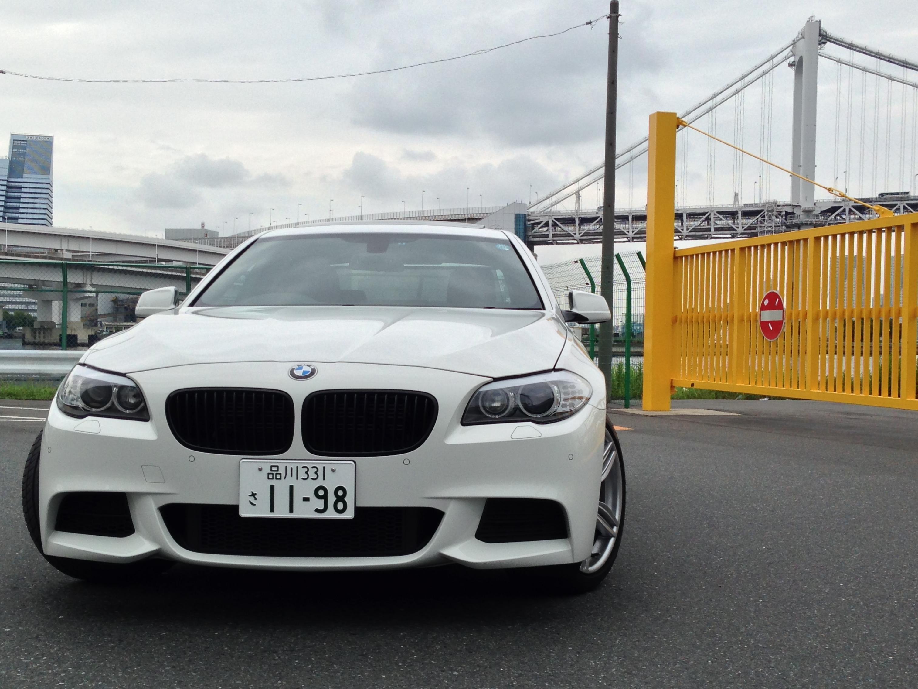

These pictures are with the E39 in 2005, the F10 in 2013 and now with the E82 all at the same location.

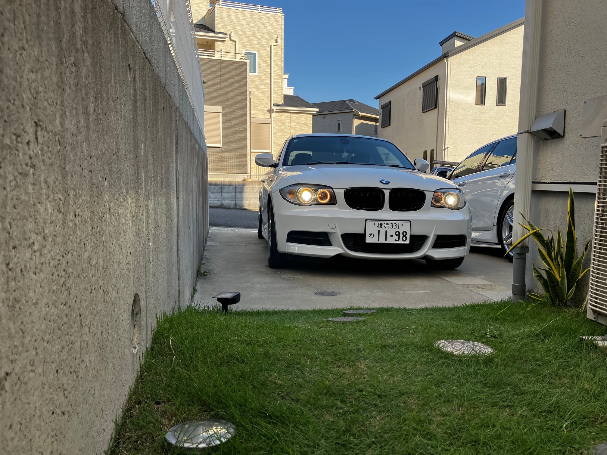

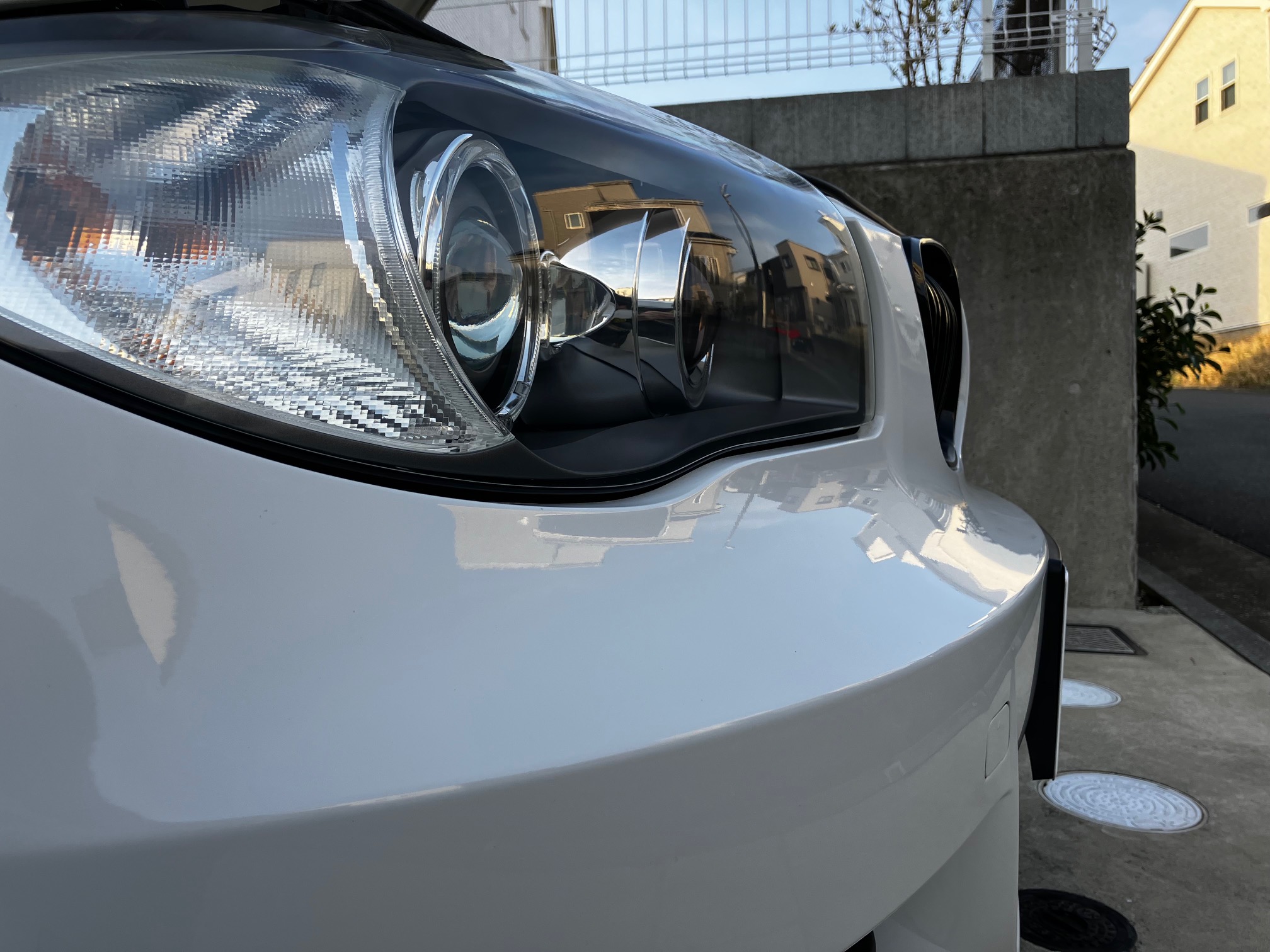

It's been one and a half years since my headlight restoration with the 3M kit and here is how they stand now.
Overall still in good shape, there is some yellowing but very, very slight. Car parks outside.
I've continued using two coats of Carnuba after most every wash.

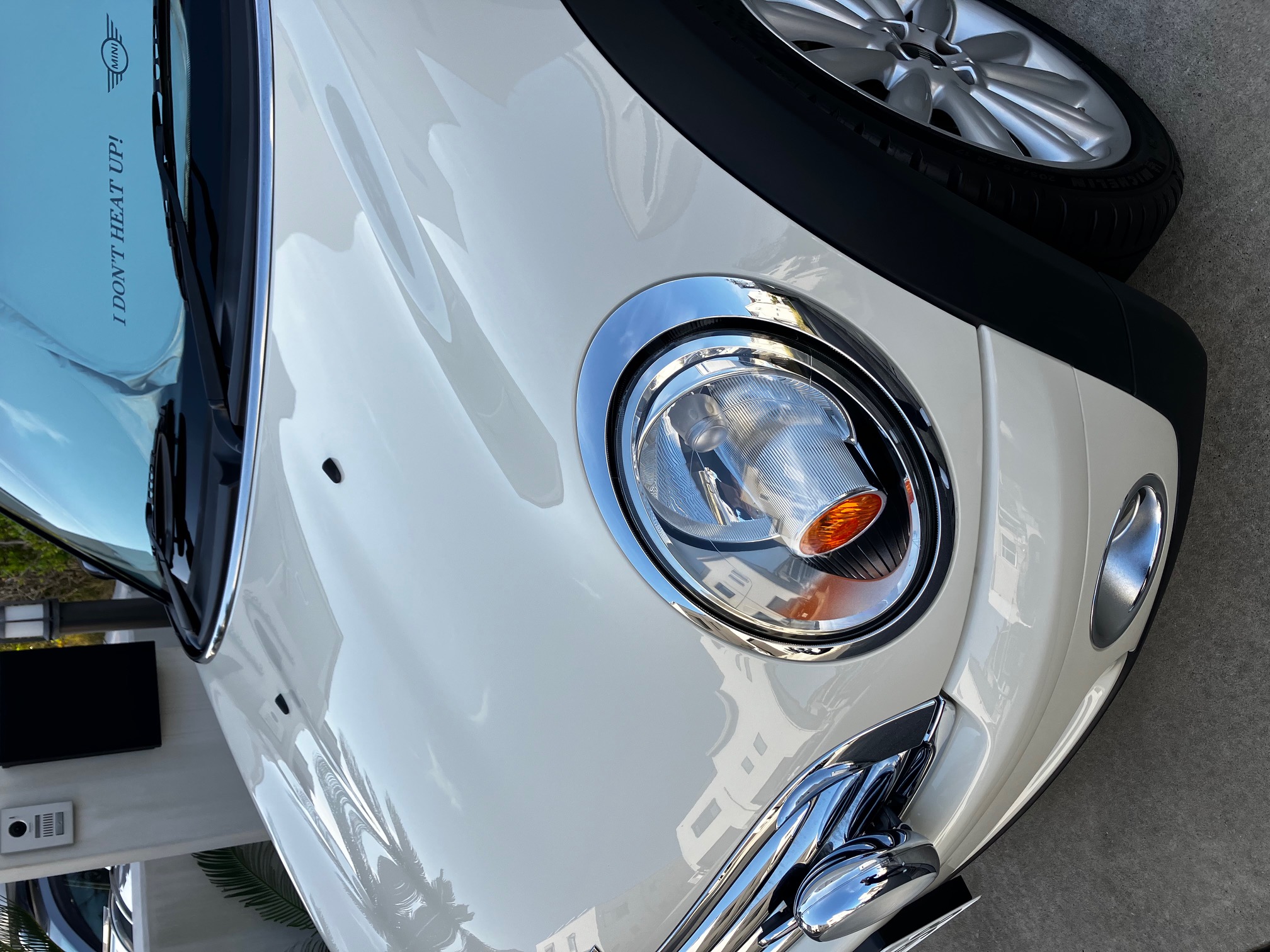

Might hit it again at the two year mark and they should clean up crystal clear easily. Have to say very happy with the 3M clear-coat wipes. The key is to get the sanding done right.
I also wax the MINI and the F10 lights after washing - although these cars have the original clear on them and so far holding up ok in the sun. The MINI and the E82 are about the same age although the MINI was garaged first 10 years of its life.

Join Date: Jan 2022
Location: Toronto
Nice, have you thought about PPFing them?
I replaced my lenses and immediately PPFd.
      04-18-2026, 04:51 AM   #107
demas
Strictly BMW
demas's Avatar
644
264
Join Date: Nov 2021
Location: Yokosuka, Japan
2013 F10 550i  [9.00]
2011 E82 135i  [10.00]
Yeah I did. I called a bodyshop about PPFing as I wanted it professionally done. They discontinued the service as they had customer complaints that the film didn’t last past 2 years. Never heard of that before.
I also found pre-cut E82 films -not sure if they were 3M - but I’d have to order from the states etc etc.
So decided to just sand and protect - and to see how long they would last as sort of a test/project.
