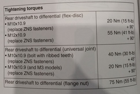

1. Anyone have a workshop manual to check the torque required on the pinion nut?
2. Is there any DIY threads of diff rebuild or similar repairs?

Steve,
You need 33107609536
31507609535 is for an AUS delivered AUTO 135i
Bentley manual torque values below
It also makes special note about marking the pinion end and nut and when re-tightening to not go past this point. This is because there is a crush tube between your small and large pinion bearings which is pre-set to get the correct pinion height. Over tightening will crush it further and change your pinion height (not good).
Also mentions a few "BMW tools" for pressing the drive flange onto the pinion shaft enough to install the collar amoungst other things. Having not done it myself I'm not sure these are essential tools or just "make your life easier" tools.
Good luck!

Ahhh genius! That's why there is 2 diffs lol
When you say flex joint - do you mean universal joint? I'm trying to refer to the table with torque figures

Yeh thats why I posted the table lol...dunno how to read that...

Maybe ill measure the current torque with my digital torque wrench and guestimate what its closest to??
The crush tube you mention, would you recommend that I replace it? Or do you think that would be opening a can of worms?

Hmm.. Do you think I should disregard the torque specs and stick to the marking I draw on the pinion and nut?
