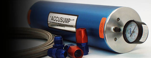

get an Accusump...
For cars that will see lots of track use... your best bet is to use something like an Accusump from Canton. It will maintain your oil pressure in the event of a sudden loss of oil pressure. It can also be used to pre-pressurize your engine for oil - BEFORE you start it up.
http://www.accusump.com/accusump_tech.html
For just a day at the track... I would change your oil & filter before you go... make sure your oil is at the proper level. Also bring some extra oil bottles with. And enjoy your day at the track. I would also change your oil & filter after you get back from the track.
