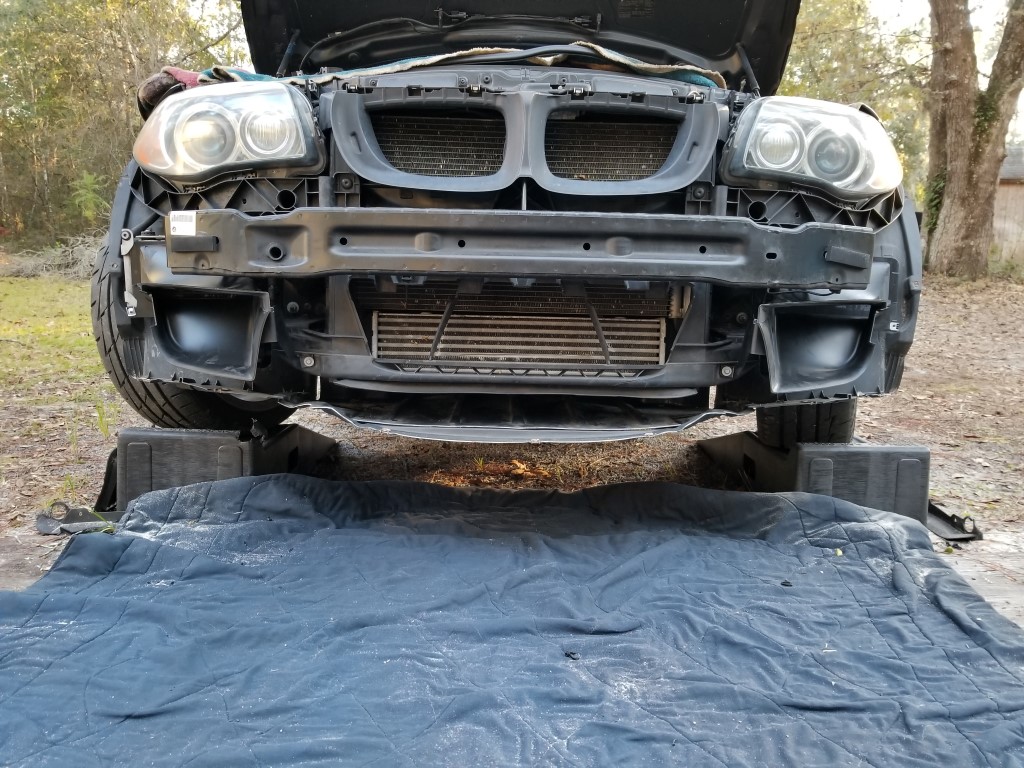

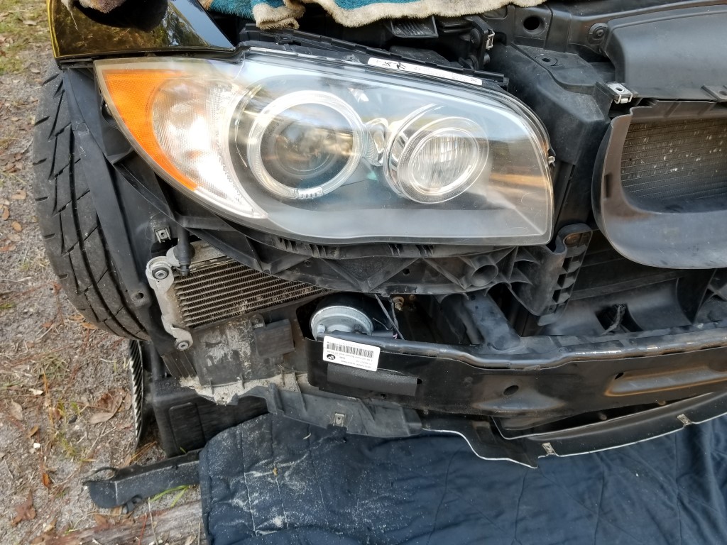

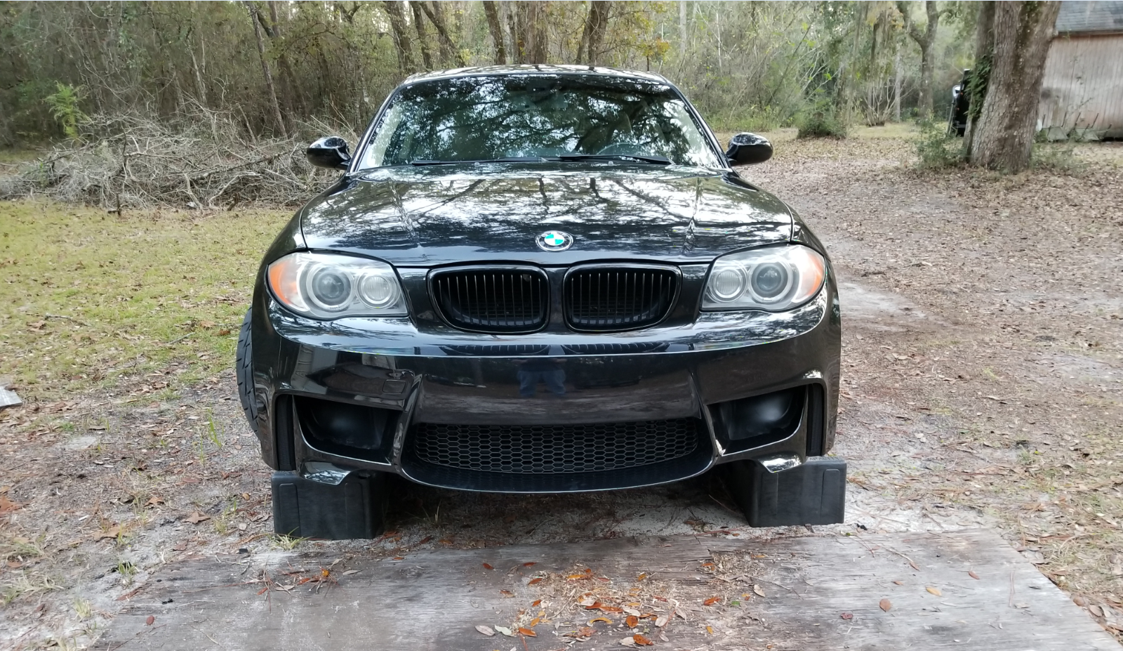

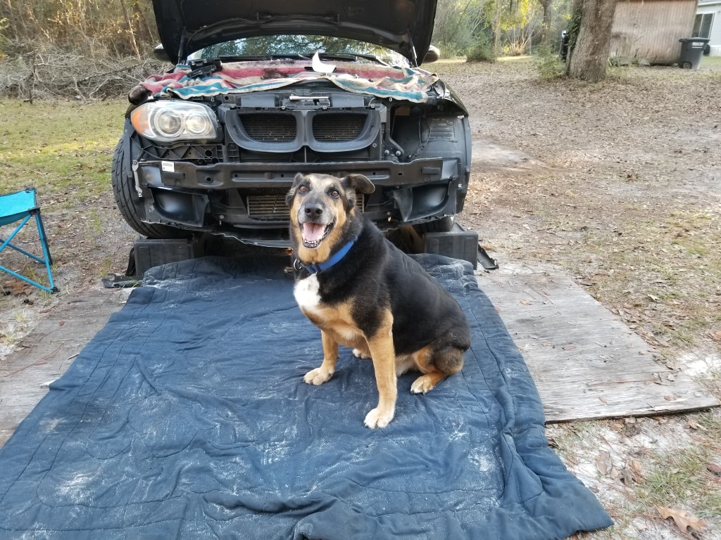

Installed my 1M rep bumper today with a set of 1M ducts replacing the fog lights. Feel free to ask questions and I'll answer best as I can.
Process and massive thanks to 714_1er and his install thread!
http://www.1addicts.com/forums/showthread.php?t=1285727
Saved me hours of work- What you see below took ~3 hours labor.
See attachments below, comments in order...
1) Starting point- You all know this 135 bumper

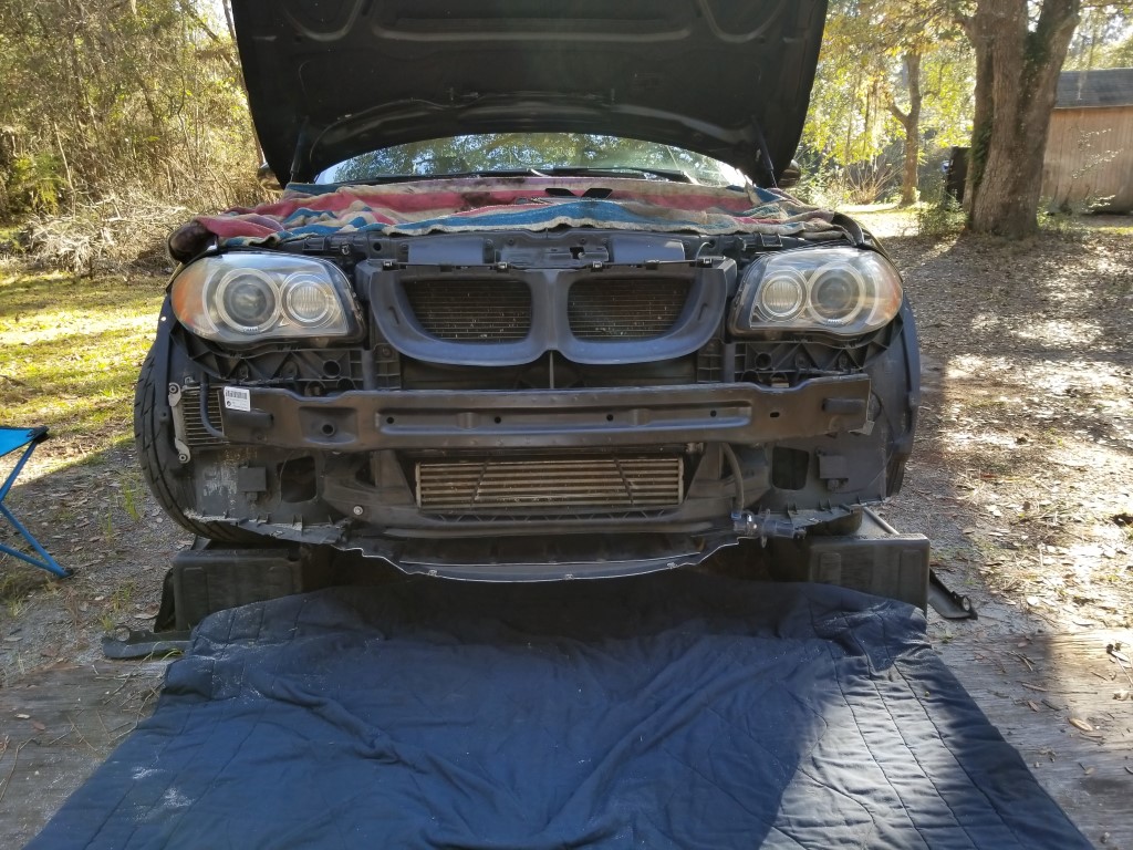

2) Bumper and original ducts removed
3) Headlight, hl washers and horn bracket removed, first horn mounted 1M style
4) Headlight washers removes and other horn mounted 1M style
5) Driver side ducting mount bolt & nut spacing. Pass side uses original mount points.
6) 1M ducts final mount & spacing
7) 1M ducts, horns mounted, HL washers removed, drivers headlight installed

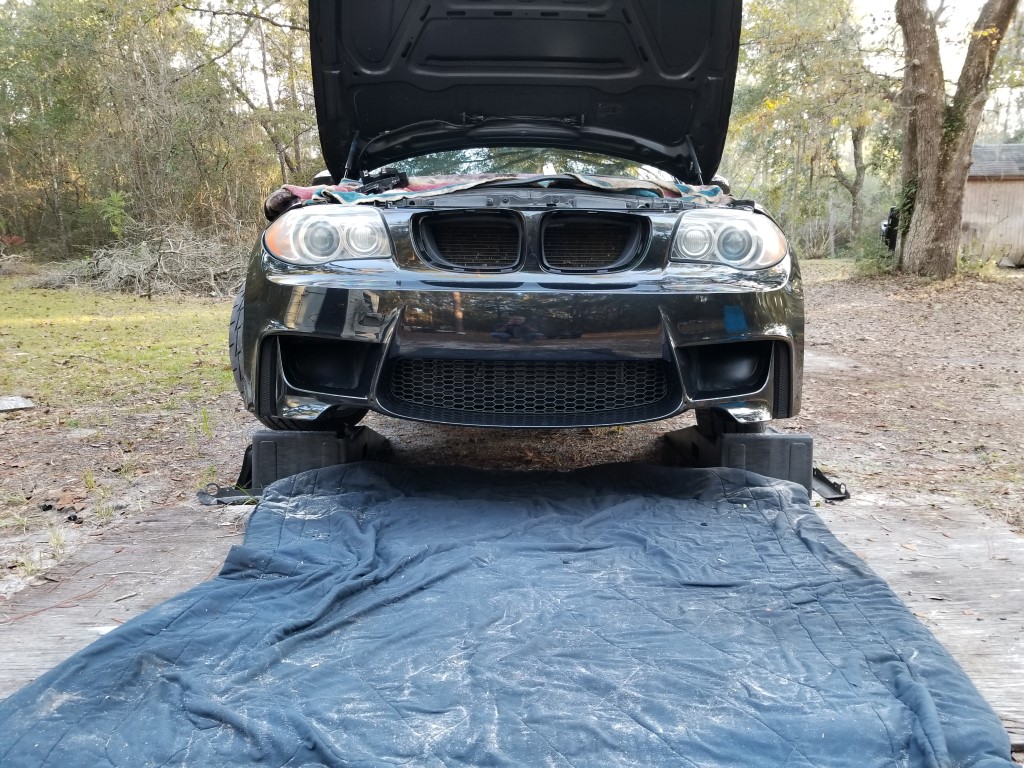

8) Initial bumper test fitting... Yup, 'bout right
9) Yeah baby...
10) Yeah

Inspecter checked in mid-job...
100+ pound, 13 year old Shepweiler, and total goofball
Bestest good boy, and total guard puppers! Unless you bring treats, then he's best friends...

Yup, before paint- spent about an hour all told, with a jig saw first to quickly & easily get the big areas cut out, then a dremel tool to clean up & fine tune.

I did, the how-to I followed is linked in the first post. I've got a photobucket hotlink extension that makes the pics work again
Was pretty easy actually- I was surprised. Four hours from on the ramps to off again, and I spent an hour of that farting around with other non-car stuff, so really three hours actual work time. If I were to do it again, probably only take 1.5 or 2 hours.
Pass side is easy bolt in swap.
Pulling the brackets for the hl washers and horns was straight forward. Sharp drill bit is your friend for rivets, even plastic ones. I did try to just knock out the plastic retainer pins, but they weren't having it so after just a few moments they got the drill...
Horns went right in the holes at the end of the bumper, and wiring is already on the passenger side- they actually just ran an extension over to the drivers side for the horn. Just remove that extension and you're all set- pretty darn handy.
I've had my HL washers deactivated since I got the car, so was happy to pull em out. Disconnected the line at the connection by the passenger side headlight.
Used the bolt with 4 nuts to act as spacer/alignment. Probably spent the most time getting this right. There is a pic showing this in the first post. Two nuts hold the duct in place, and two hold the bolt to the frame. No bolt specs, was just pulled from my leftover bolt bucket.
And I'm totally tickled with how it came out. I'm pondering what to do, if anything, about the small gaps to the fender liners and on the outer edges where duct meets bumper. May not do anything- they really don't bother me at the moment, and are small enough that you don't see em unless you're at just the right angle.
