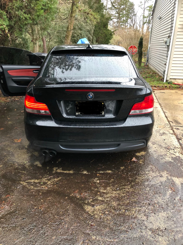

Hi. So when I start my car my right tail light will turn on like it's supposed to be but will go off for good after about a minute. I do not understand why. I have replaced the bulbs and it does the same thing. Anyone had this same issue before? Sucks because I cannot drive it without a lit tail light so I'm kinda stuck here lol. All help will be greatly appreciated. Thank you.

My fault I've been posting this everywhere I forgot to leave the year. That is exactly what is happening the bulbs all work fine but it will turn on the go off like in the picture. It's a 2008 135i. Thank you for the reply.
