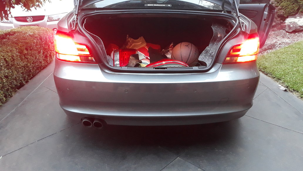

I have the xenon lci blackline tail lights kit brand new just installed #63212225282
part numbers for each side
63217327273
63217327274
Problem is - the LH side plug and plays, RH side everything works, apart from the running lights/parkers which is what powers the LED strips. See photos
Anyone have an idea why? Could it be a defective light? I tried the RH side in the LH side and it doesn't work either. I tried changing bulbs everything and nothing works. Put my old ones back in, and the RH side parkers light up perfect.
I want to avoid having to add a wire from the number plate if I can. It should just plug and play. Any ideas?
Thanks.

Could be that the R is defective. Since you put you old ones and the parking lights were working fine. Even in thr pic where you stepped on the brakes w both blacklines on, the LED strip on the right didn’t light up.

correct thanks sirius. I am thinking it is a defective unit

Got another one sent out, the RH side was defecting for the running lights only. New one plug and played perfect
