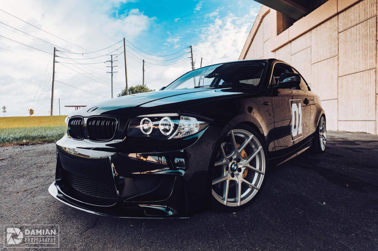

Here's is my 128i base model with 1m front and rear bumper
2013 BMW 128i | 1m Front and Rear Bumpers with Aggressive Rear Diffuser | LCI Blackline Rear Tail Lights | Custom Headlights | Xtron Touch Screen Head Unit | 19" VMR 803's staggered | M3 Control Arms | M3 Front Swaybar | Polly Rear Subframe bushings | BMW Performance Big Bake Kit | BMW Performance Strut Brace | Custom Magna Flow Quad Exhaust | BC Coilovers | Stage 3 Intake | AA exhaust Header |Supercharger Gen3| StageFP Tune.
That's a sexy set up, love the carbon on the rear.
For the ducts, did it take any extra work to fit the ducts that came with the bumper? Or was it PnP for the 128i?
I ask since I see a lot of 135i guys having to do extra work to fit the 1M replica ducts.
Also, how do you like the Spyder Halos? They're pretty cheap, I've be considering picking up a set to swap out for my halogens.

If your 1m rep bumper had fog lamps you will need to cut out the brackets in the bumper and the 1m duct fits in perfectly yes we don't need to worry about anything else because we don't have that stuff 135 has
