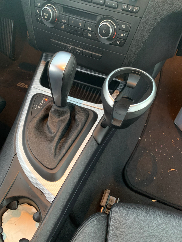

Hello, I own a 2011 128i convertible without iDrive and I have the two cup holders below the gear shift lever with one of them being completely useless because the armrest sits right over it.
I am trying to retrofit this cup holder into the center console. My questions are:
1- Is this possible to do without buying an entirely new center console piece?
2- If so, is there any drilling or cutting required?
3- Does it require the entire console to come out or just the gear shifter and the trim around it?
I've attached pictures of the cup holder I want to install and my center console that include where the cup holder should fit. Hopefully this is doable without too much hassle...

I’ve done exactly this. It’s a wonderful addition and really makes the interior usable.
1. Yes, fully doable with the center console you have.
2 + 3. It requires full console removal and cutting of the console but it’s not nearly as scary as it sounds. The console takes a few 10mm and T25 bolts. I can have the console fully out of the car in 15min including getting the tools out. The kit came with a template that I traced on with sharpie and then drilled holes to make cutting out the profile easier. It looks like crap until the trim piece goes in but it looks perfect after that.

You were absolutely right! This was a fun and great addition... finally have a decent cup holder to use.

Did you really have to remove the whole center console? Is removing the silver triangle gear stick surround and gater not enough thanks?
