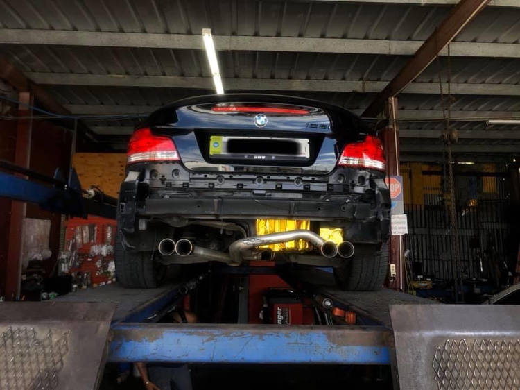

2008 BMW 135i  [0.00]
Yes it is, here a picture of my previous car a 128i with custom dual exhaust. Axel back straight exhaust. And another picture of the design. Not the most functional, but was the less expensive route. Since this wasn't a performance orientated build.
The guy who was going to fabricate it was really concerned about the connection between mid pipes and axle back sections proximity to the diff. I was trying to do a system with minimal mandrels and the same size tubing from DP back. You could reduce the pipe size around the diff but performance use this makes no sense...IMO it's totally a cosmetic thing...
How much did this run you? And who/where would I go to to get a quote/get this done
Yea it's a cosmetic mod. If someone is going for performance it's best to keep it single exhaust. But others don't mind it too much. In my case it was a 128i so performance wise there's no many reasons to spend money it. That's why now that I own a 135i I don't have the dual exhaust setup. I prefer performance orientated mods instead.
Well I live in Puerto Rico, so price wise I bet it'll be different from where you live. But I bought the tips from eBay, for about 140/170 USD (not sure on the price, but was kind of expensive if you ask me), then I powder coated those tips in rose gold for around 40/60 USD , & labor was about $180 USD (not that bad).

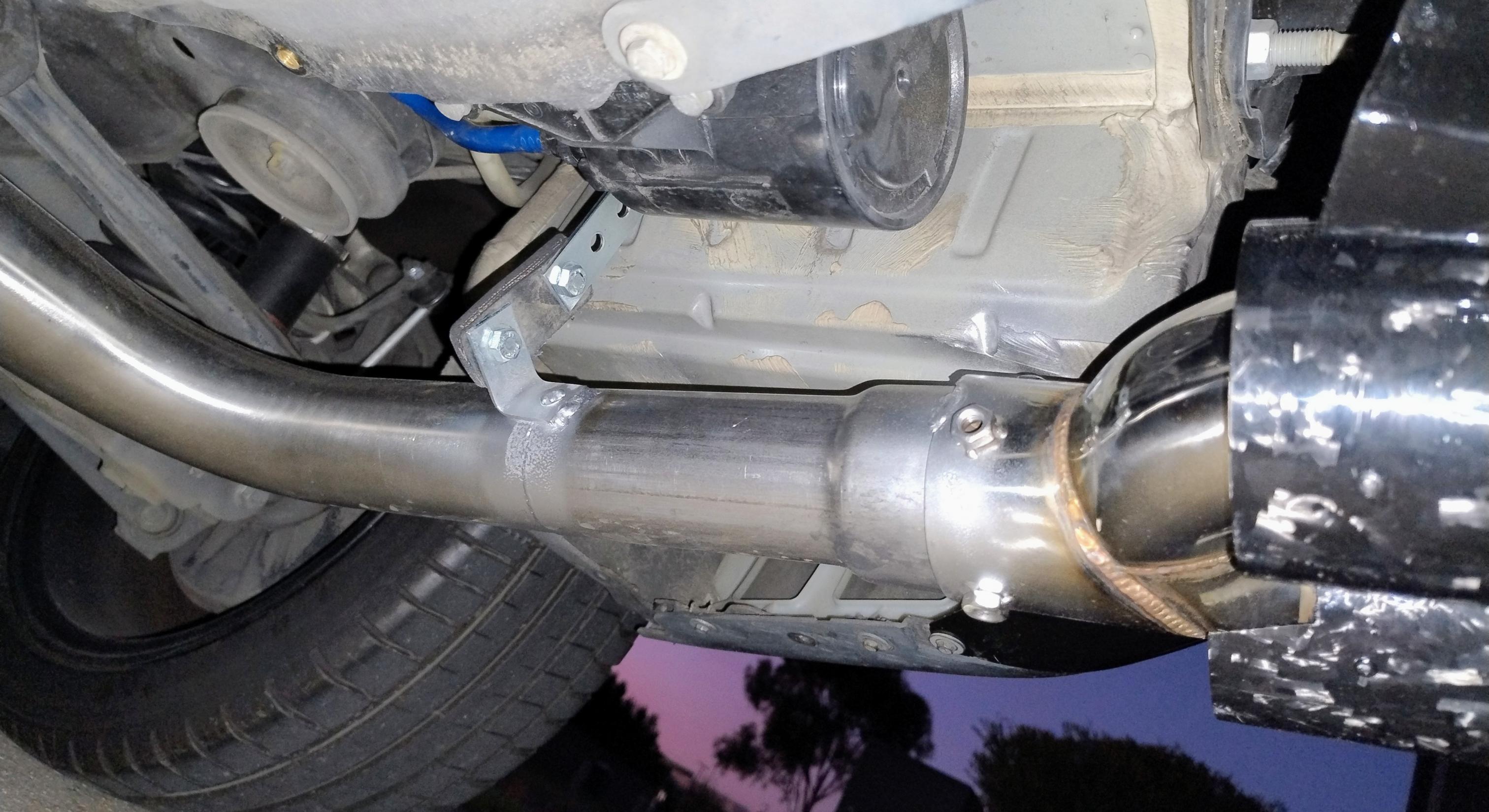

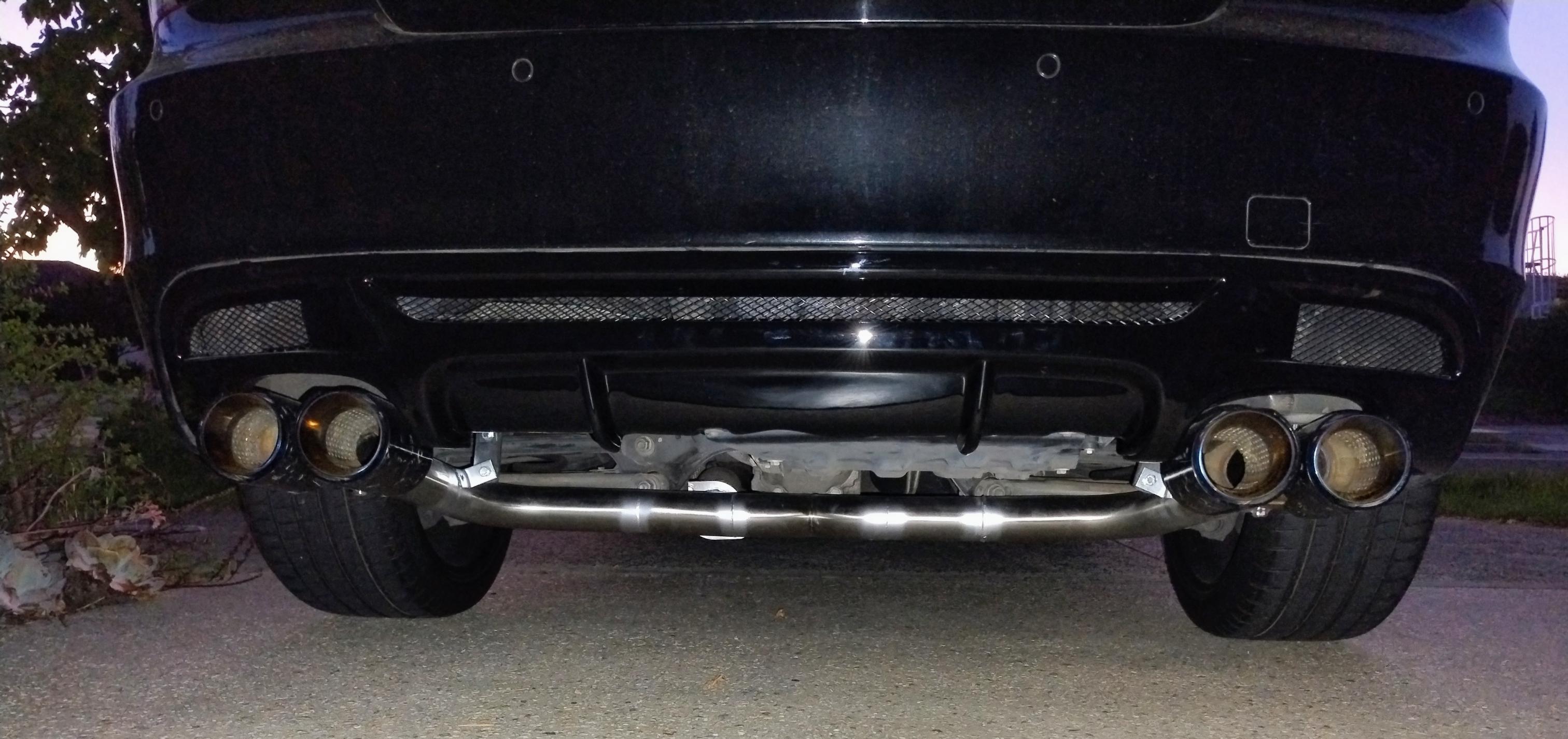

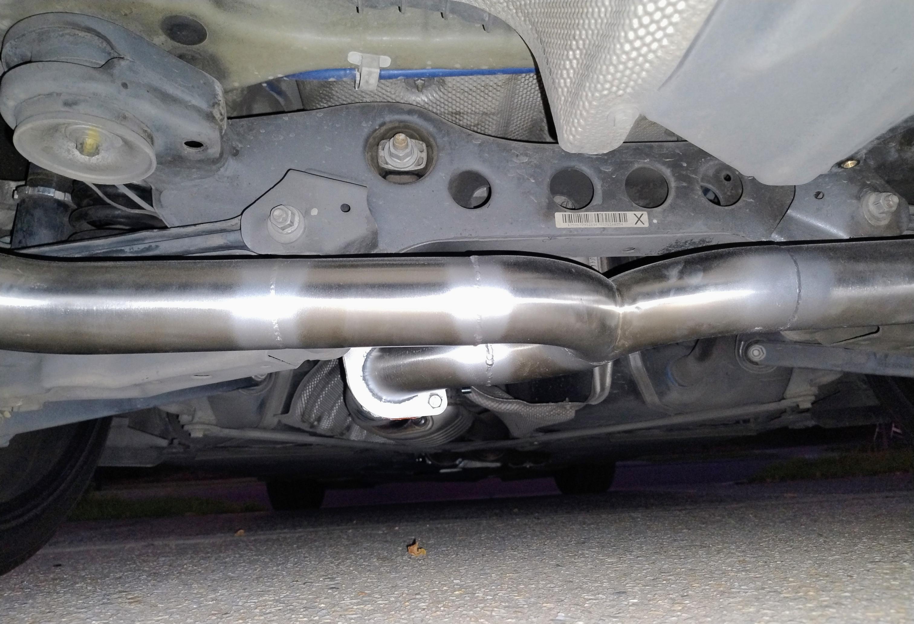

      03-27-2025, 09:50 PM   #15
AussieMalt
AussieMalt's Avatar
Drives: 2009 135i N54
Join Date: Jul 2021
Location: Australia
2009 135i  [0.00]
2009 135i  [0.00]
I don't mean to revive an old thread buuut, I just had this done and imo it looks amazing and didn't really affect performance. Cost about AU$1200 SS going into a hotdog. Not overly loud, still within EPA laws but sounds wicked on WOT.
