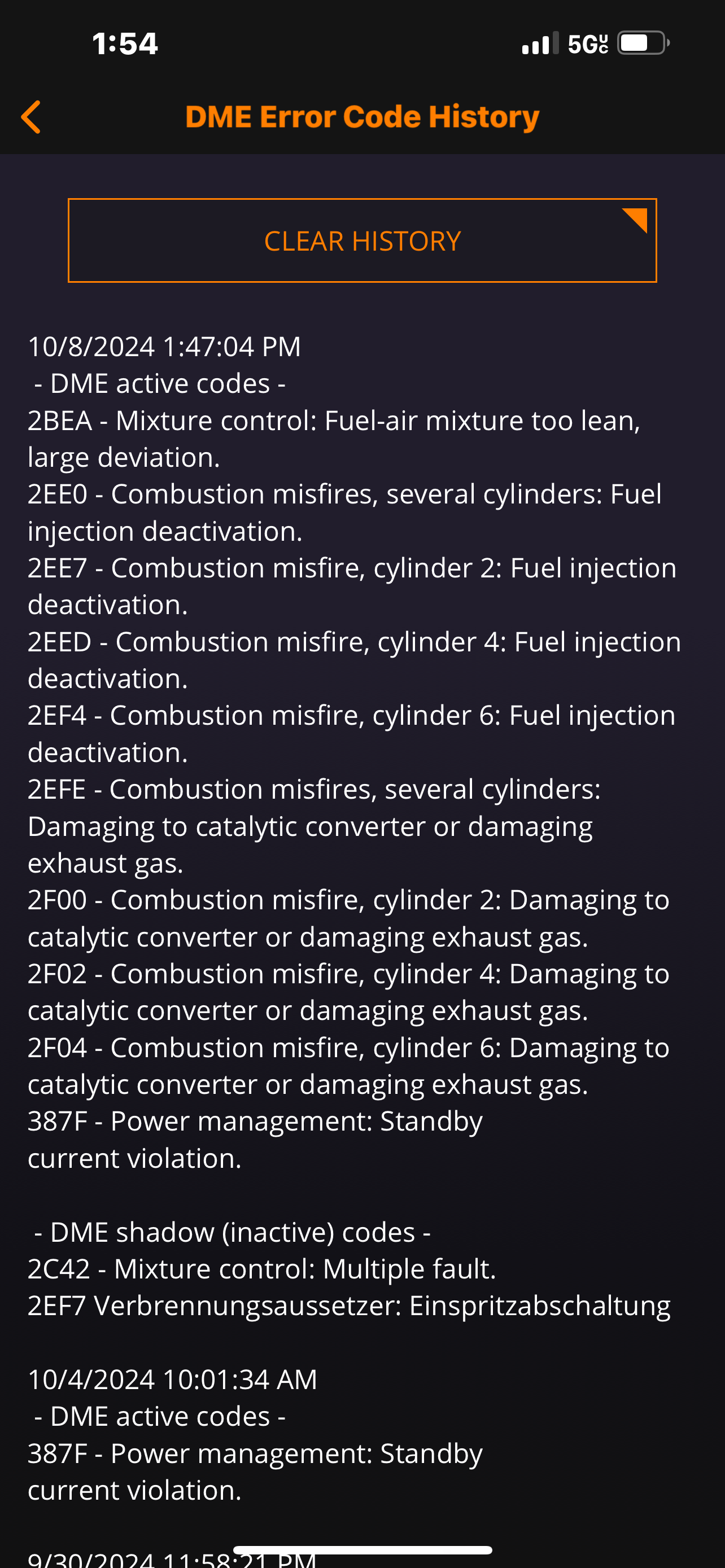

The issue definitely seems heat related. It usually occurs after a hard canyon run or logging session where I do a bunch of back to back pulls. Car starts stuttering on light throttle. Then if I stop and let it idle for a little it will throw misfire and other codes. Clear them and restart and drives good again.
When I log it happening at idle, stft max at +33 and the afr is in the 20s.
