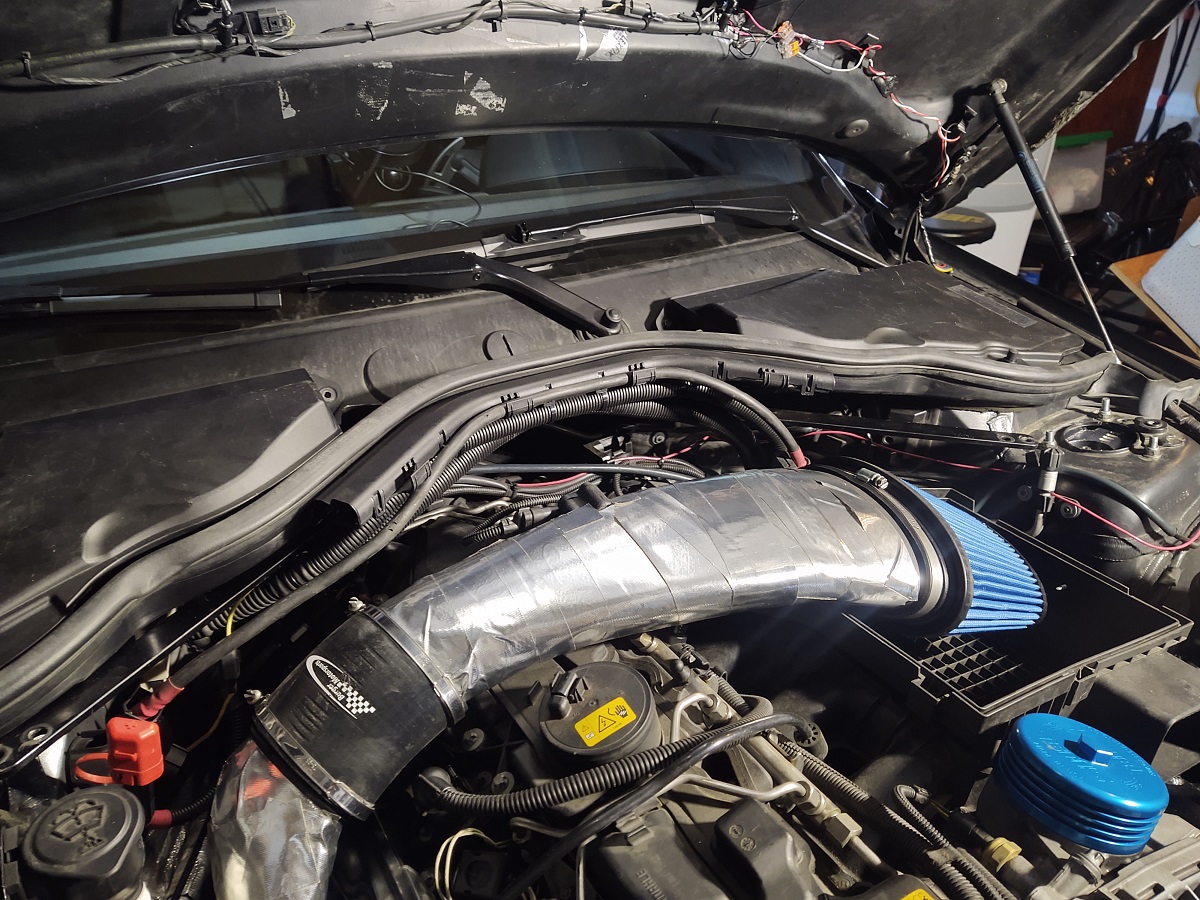

So, FCPeuro has a kit (https://www.fcpeuro.com/products/bmw...-64316958817kt) but it says only for the 3 series...but I know people have done this for the 1er. I even asked them and they said it won't fit. Can anyone who has done this clear it up - will it fit? Thx!

So I got all the parts, including the wire harness support, but the wire harnesses are too short? Did the 1M have different wire harness lengths from the 135?

Ah. Guess I'll have to mod the wire carriage so the wires can fit.
Best,
Andy
      05-30-2021, 10:10 PM   #8
AndyW
AndyW's Avatar
773
1,801
Join Date: Feb 2012
Location: Washington, USA
Ended up using the wire carriage as a zip tie location so I could hang the wire harnesses below it. Worked well.

Just my .02 on this one: I used the BMS filters and no cowling for a few months but my car is a DD and I was concerned about water intrusion and snow covering the filters. I also looked at the M3 bits but saw that required a lot of adapting and the washer jets created interference.
What I settled on was just modifying the stock 135 parts. Basically, I cut a section out of the middle of the hard tray in order to allow underhood air to escape. I then cut out notches to allow the tray to seat over the 1M strut bars. Just took a little time and a cutoff wheel. 5" wheel for starters then Dremel for finish work.

1. There is a high pressure region at the back of the hood. The hood needs to be sealed back there to prevent opposing flow. As I track this car, this is important.
2. Aesthetics.

Andy, is your new M3 cowl actually sealing against air entering from behind the hood? If you look at the underside of the hood (at least the stock one, not sure about the Seibon one), there is countouring that protrudes to seal against the cowl gasket. This countouring is shaped to seal with the 135i cowl and not any other - from the looks of it. This is my only hesitation against the M3 cowl, otherwise I'd get it in a heartbeat.

It definitely will not seal without modification on the Seibon hood. I added rubber sealing strips to fix that.

The back of the hood is a high pressure zone with a ram air effect - this is actually the second best place to put a cold air intake after the front of the vehicle. Therefore it is important to seal this area off for the engine bay to efficiently ventilate heat at speed.
Shirtpants_ on e90post.com performed testing with a magnehelic gauge to find the best place to vent heat from the hood, and his results verify the observation that applies to almost every hood. Pressure on the hood increases as you approach the windshield. The worst place is at the back of the hood where pressure is highest. Ref: https://www.e90post.com/forums/showthread.php?t=1306425
Attached below is an image of pressures variations on the hood of a Miata. It’s best to avoid placing any heat vents in the positive pressure zones where air wants to go into the engine bay and trap its heat. Negative pressure is where engine heat can escape when the vehicle is moving.
